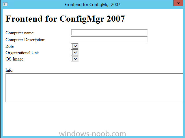

As you can see on the picture I want the frontend to look just as it is but I want it to fetch AD information and present it in the HTA. Also I want the system to add computer name suffix where it always starts with either Laptop or Workstation and then adds the serial number or anything that will separate them in the system. For example: Laptop+Serialnr would be "Laptop-12345678"
I want to be able to put the computer in any OU I want if needed and I want to be able to choose what OS Image to be installed.

The installation of the Web services is done and tested like it says in your book "The Windows-Noob OSD...". All seems fine but when I added the files to the Wim file it still ends up with the same results as I had last time, (please see screendump from my first post).

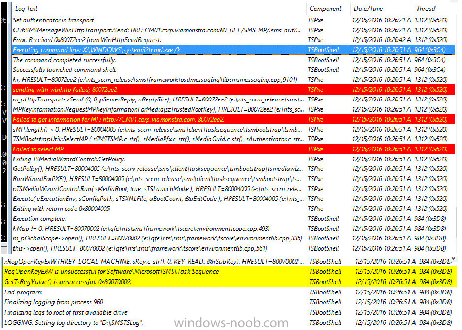

Here´s the recent error log.
Noticed a couple of things:
1. It reboots after adding text in HTA and pressed OK (as described in previous post) - but still adds the computer directly to SCCM. Without removing it from SCCM I tried once again and then it works.
2. The task sequence I have deployed is NOT an MDT Client Task Sequence....but instead a SCCM TS. That must be why it wont add computers to the MDT database?

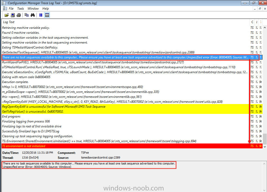

It says I don´t have any Task Sequence available to this computer. I have tried numerous different virtual computers but end up with the same result.
This time I really have no clue what to do.
I made new Task Sequences but it did not help. The one i had I changed the scheduling back 2 or 3 days but no luck.
Question, shouldn´t the TS show even if it´s done in wrong? I deployed the new TS to a Device collection and that shows up and is available in the Frontend. But when I click "OK" it givs the error about no TS available for this computer.
I checked that I didn´t lost my connection but all seems fine there.
Can you please advice? Where should I start looking?

would you like me to do a teamviewer session with you, if so pm me your details and a time frame and i'll connect and have a look
but based on your error are you sure the computer is actually in a collection (and not obsolete) that is targeted with the deployment ?
