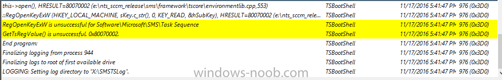

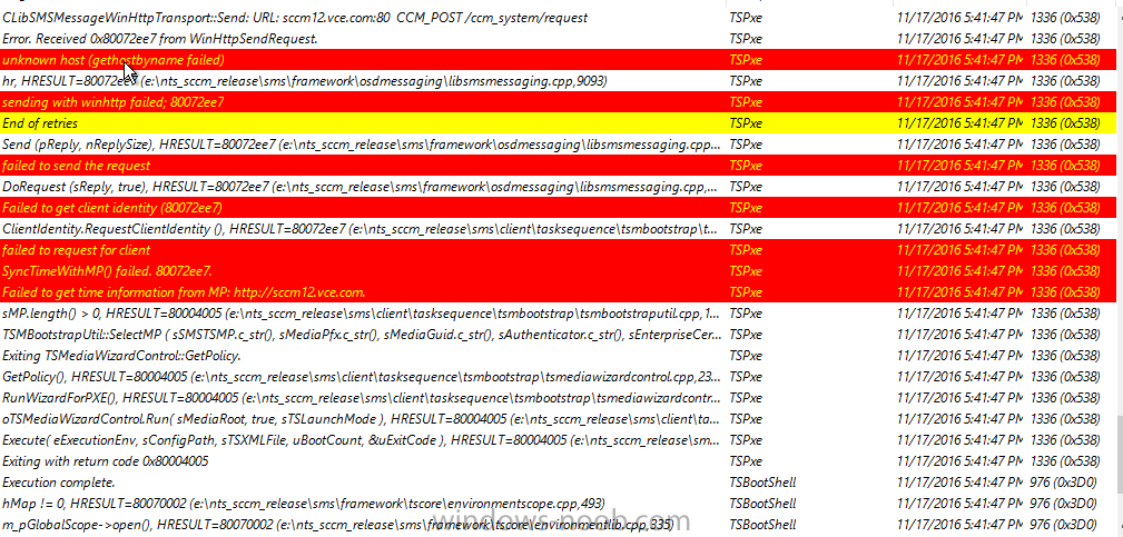

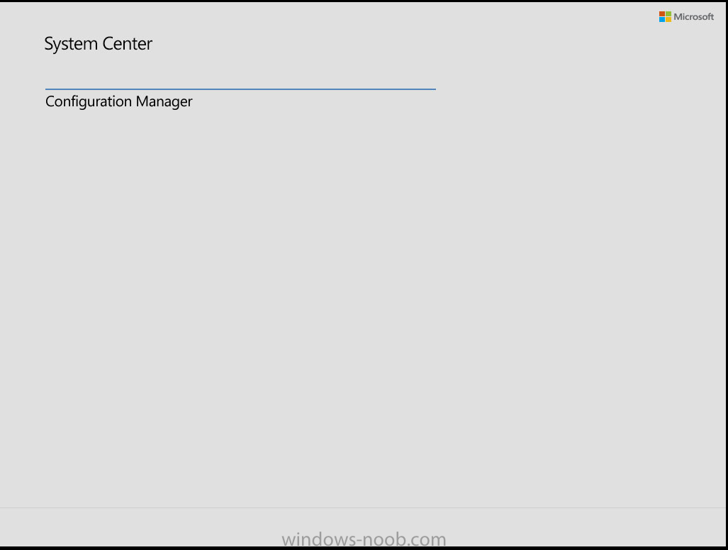

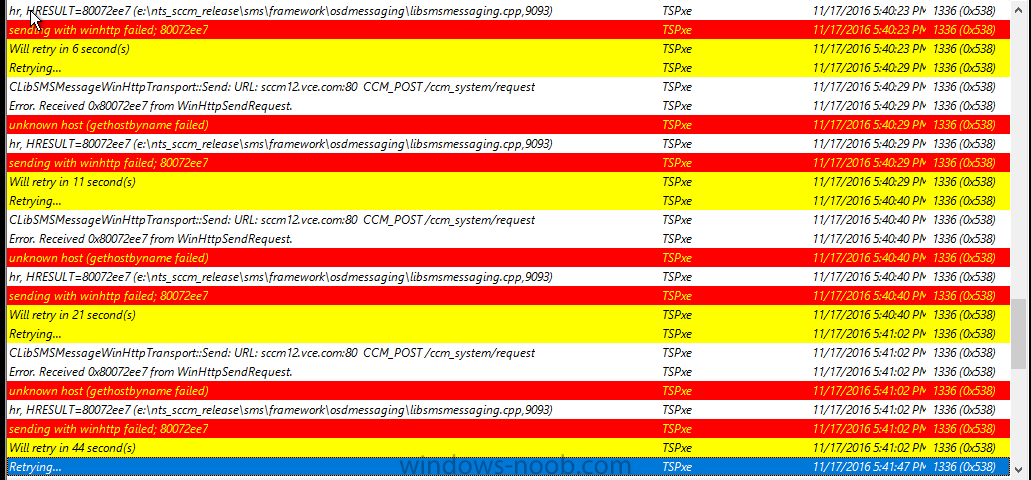

Now I have a new problem that Boot with PXE correctely and it´s load the files and i see the Initializing screen and when its disappear and left me with the only image of System Center grey and then restart.
I chcked the SMSTS.Log on the vm, and I got this errors you can see one the images I attache.
I re-entred the user for Network access agian (I used the same account for client push)
and I tried agian but still not working.I got the same log errors and warning agian as above.

I resolve it, With just adding DNS Server Option 006 to DHCP Server, I was forget about, now I can boot and Install windows 10 without problemas,
