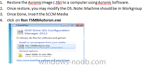

Im newly promoted to System Admin team from Tech Support. And i'm having a problem with regards to SCCM OS Creation.
Because the engineer who handle the SCCM was already resigned (no endorsement). There's a Step by step procedure but i don't have idea in some of the steps. Like this "Insert the SCCM Media" TSMBautorun.exe (cd). We can't find the CD anymore. What is that CD so i can download it?. anyone can help. thank!
