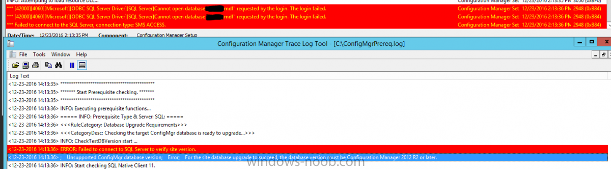

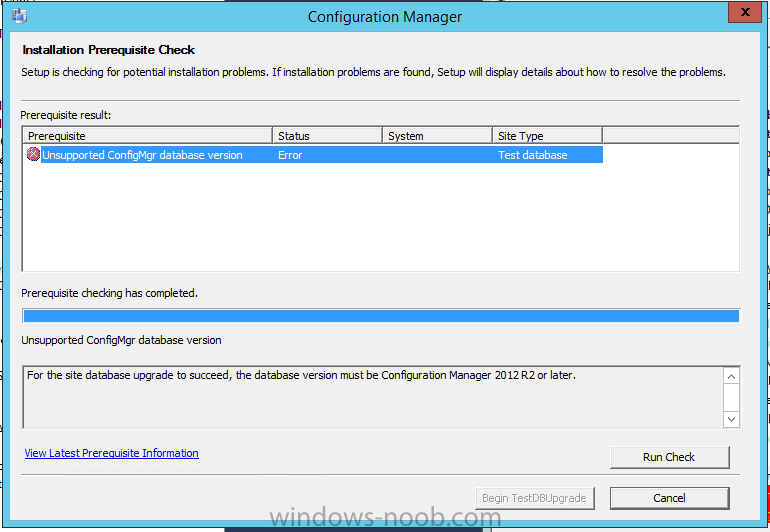

I am trying to upgrade my primary site to 1511 but running into some road blocks when performing the testdbupgrade prereq list. At first, the error is indicating Unsupported ConfigMgr Database version. But as I open the ConfigMgrSetup.log, I noticed its not able to open the database to verify the site version (which is 5.00.8239.1000). I have attached some screenshots below to show the errors.
Can someone assist or guide me to a step that I might be overlooking?

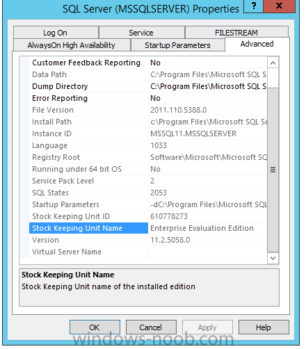

well 11.0.5388.0 is somewhere between SQL Server 2012 SP2 and SP3 according to https://sqlserverbuilds.blogspot.se/
your other version (test env) is using SQL Server 2012 RTM so you must update it to SP2 prior to doing the testdbupgrade
Just upgraded to the version below which matches the production SQL server except for the operating system version number and the Microsoft Data Access Components (MDAC) and still no go; exact same error message within the ConfigMgrSetup.log. Not sure if those component versions matter? Can't see what else I can try to get the test going. Any other suggestion, Anyweb?
