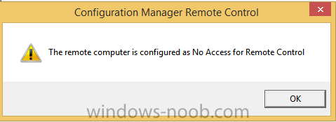

I have problems with remote control. And I don’t understand why it’s working on some computers but others not. Under client settings I have enabled remote tools.
The agent on the client the Remote tools agent enabled.
The client with the problem:
Service: Configuration Manager Remote Control is disabled.
The local group: ConfigMgr Remote Control users are missing
The windows firewall are missing this:
If I enable and start the configuration Manager Remote Control service. I see this in the CmRCService:
If I try to start the remote control from sccm I get this message. All the client have the same client installed
I hope somebody can help me here. Thanks for your help.

Unfortunately no final solution, but I recognized that it has something to do with the client settings.
On some clients the "Remote Tools" Settings simply seems not to be applied correctly. The Group "ConfigMgr Remote Control Users" under Local Users and Groups is missing on the affected clients. That seems to be the reason why it's not possible to connect to the devices.
As a workaround, in that case I simply add the device to an collection with different client settings (different Remote Tools Settings) and force the client to download the Computer Policy. After this the "ConfigMgr Remote Control Users" should be automatically created. Now you can remove the client from the temporary collection and force Policy refresh again to get the correct settings.
It's not so nice but the workaround is working, at least for me.
I'm still not sure why this is happening. I think in our case only "reinstalled" devices (which already was connected to SCCM) are affected, new devices are always working.
We have about 20 different "client settings" for different locations and so on. I'm not sure if SCCM has a bug/problem to handle this number of different settings.
hope that helps some of you..
Thank you! I've tried it and your solution is working.
We have had a separate Clients Device Setting for Remote Control which is deployed to "All Desktop and Server Clients". I had already tried to deploy this additional to "All systems", without any success.
Though we have one Remote Control Setting which is unique for every site, I now configured the RC settings just in the Default Client Settings and at the moment it seems to work.
Thank you for your support!!!
Your client settings aren't in correct priority order or deploy to the correct collections in that case.
Easy way to tell this - find a failing machine, right click it in the console and select resultant client settings. This'll give you a hint as to which set it's applying.
