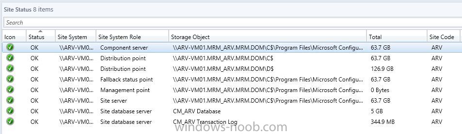

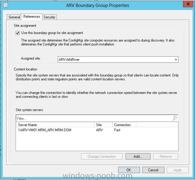

I have tried removing Distribution Point and putting it back, same error.
Attached are some screen shots:
Please point me in the right direction.
