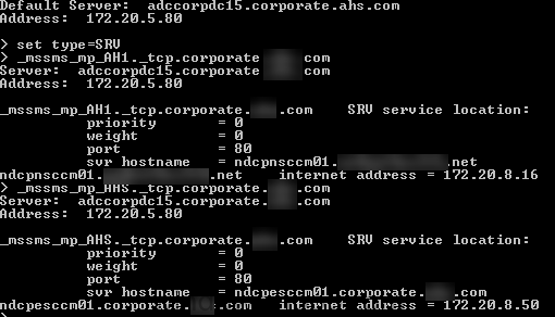

I decided to ensure that the SRV record for the new sitecode was set up correctly in the old domain's DNS and it is.  Attached is a screenshot which I executed from the test VM which I migrated to the new site code upon but was still on the old domain.  The old domain ends in corporate.___.com and the new domain ___health.net.  The new site code is "AH1" which is finds the primary site server (& MP) in the new domain as you can see.  Below that, I queried "AHS" which is the old site code.  This results in displaying the primary of the old domain.
Doesn't look like the SRV record is the issue, but if not; why is it still saying "Failed to refresh MP Error"?  Possibly due to permissions (despite being a two way trust between domains) or am I missing a pointer / record somewhere?
