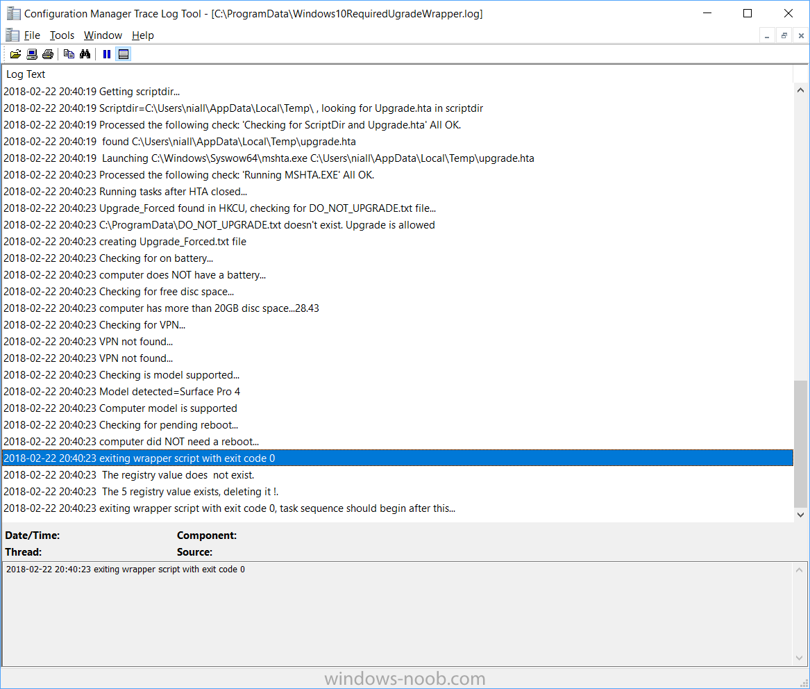

i've changed the code order so it performs the checks like this, i'll upload the updated code shortly
Expand
Thanks. I'll test it out here shortly on a device that I have tricked into thinking it needs to be rebooted. Curious I see that for the pending reboot you returned it to Exit99 I thought you said for the task sequence to kick off after the reboot it would have to be Exit0. Either way I will test and adjust.
I will suggest for sanity of the end user to do the hardware check before disk space, vpn, etc. no sense having them clean up disk space, connect power or disconnect from VPN if they are then going to be told their hardware is not compatible with the upgrade. Just a thought.
/Paul
yes, i tested it some more and decided it's the best option for now, however i have some ideas to improve upon it going forward, and if i get time i'll script the, but for now this will have to do
good point,  i've modified it again so that the check if model supported is the first check, i've uploaded the modified scripts
