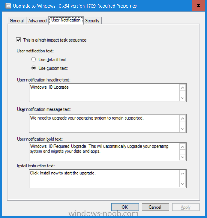

also check your User Notification settings on the task sequence properties, here's an example. It will only display IF the user launches the required upgrade from the software center

Thank you. Tthis is what I already have in the TS, with some custom information like new default BitLocker PIN after completion etc :)
