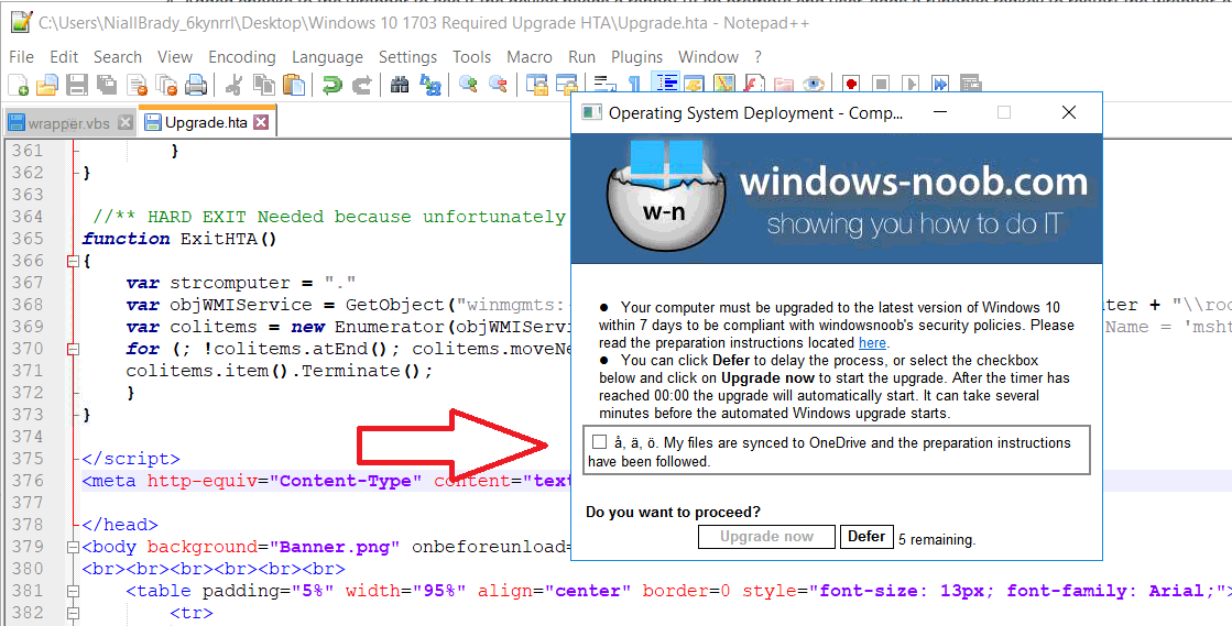

have you tried adding this (the charset)
<meta http-equiv="Content-Type" content="text/html;charset=utf-8"/>
i've just tested it and it works fine with Swedish characters
