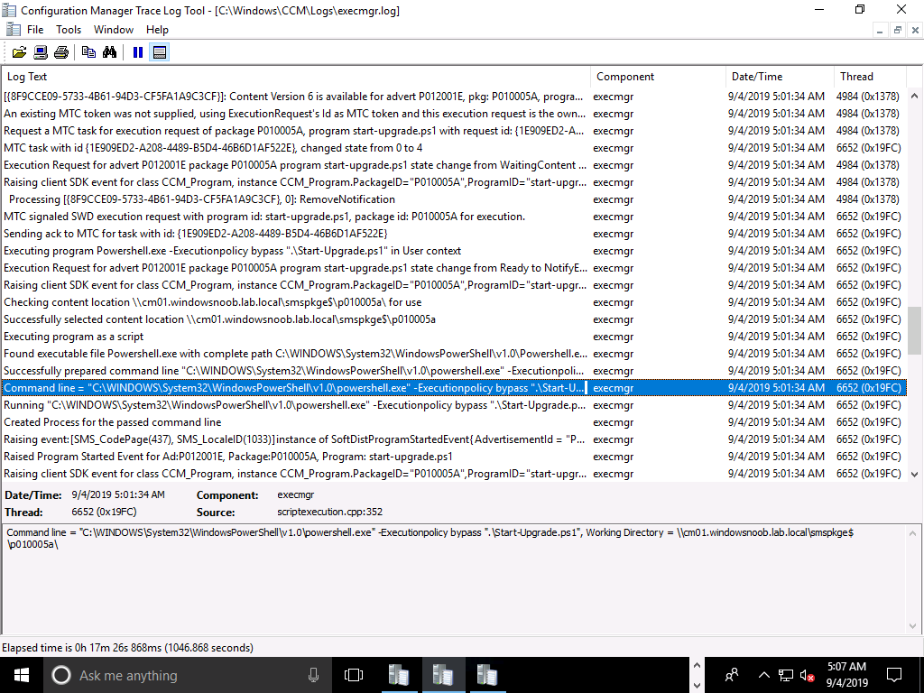

ok just tested it in my lab with a user that is a standard user, and it starts the powershell wrapper no problem at all.
so something else must be different in your environment, double check your settings pls

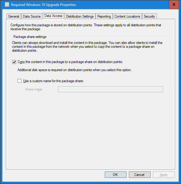

The Copy Content in this package... was already checked.

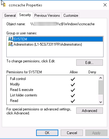

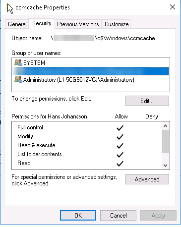

The difference I see between a working client and a non-working is this:
Working (the standard user has Full Control to the folder for some reason):
Non-working (no standard user permissions):
Have you tested the permission difference for the ccmcache folder in your lab?  Notice that the package is pre-downloaded to the cache with a prestage TS. Maybe that can cause problems?

i'm not using any prestage TS, so yes that might be part of your problem.
my user also doesn't have access to the ccmcache but as i said, it's working just fine for me

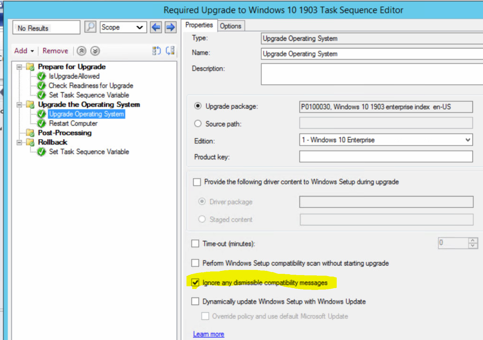

you can adjust the Upgrade Operating System step there's a switch you can add to ignore these types of warnings, have you tried setting this step
yes i did but it keeps failing , here is part of the log:
Windows upgrade progress: 0%    OSDUpgradeWindows    04/11/2019 17:41:54    9176 (0x23D8)
Windows upgrade progress: 12%    OSDUpgradeWindows    04/11/2019 17:42:34    9176 (0x23D8)
Process completed with exit code 3247440392    OSDUpgradeWindows    04/11/2019 17:43:30    10132 (0x2794)
ExecuteWithTimeout returned Windows Setup process hexadecimal exit code 0xC1900208 (decimal 3247440392)     OSDUpgradeWindows    04/11/2019 17:43:30    10132 (0x2794)
Could not read Windows Setup progress regkey value 'SetupProgress' at 'HKLM\SYSTEM\Setup\MoSetup\Volatile'. Stopping UI progress. (0x800703fa)    OSDUpgradeWindows    04/11/2019 17:43:34    9176 (0x23D8)
Windows upgrade progress: 14%    OSDUpgradeWindows    04/11/2019 17:43:34    9176 (0x23D8)
Waiting for Windows Upgrade Setup process to return ...    OSDUpgradeWindows    04/11/2019 17:43:34    9176 (0x23D8)
Wait for event returned 0    OSDUpgradeWindows    04/11/2019 17:43:34    9176 (0x23D8)
Windows setup completed with exit code hexadecimal 0xC1900208 (decimal 3247440392)     OSDUpgradeWindows    04/11/2019 17:43:34    9176 (0x23D8)
Saving exit code of Windows upgrade - hexadecimal 0xC1900208 (decimal 3247440392) -  to Task sequence environment variable '_SMSTSOSUpgradeActionReturnCode', as decimal string    OSDUpgradeWindows    04/11/2019 17:43:34    9176 (0x23D8)
Windows setup in 'scanOnly' mode returned exit code hexadecimal 0xC1900208 ( decimal 3247440392) . Failing task sequence step.    OSDUpgradeWindows    04/11/2019 17:43:34    9176 (0x23D8)
See the list of error codes to identify the type of upgrade compatibility issue found.    OSDUpgradeWindows    04/11/2019 17:43:34    9176 (0x23D8)
upgrade.Run(), HRESULT=80004005 (upgradewindows.cpp,1779)    OSDUpgradeWindows    04/11/2019 17:43:34    9176 (0x23D8)
[ScanOnly]: Exiting with code 0x80004005    OSDUpgradeWindows    04/11/2019 17:43:34    9176 (0x23D8)
Process completed with exit code 2147500037    TSManager    04/11/2019 17:43:34    7388 (0x1CDC)
smsts.logFetching info...
well it could be that your error is a hard block, did you check the appcompat logs to see if it was listed as a hard block ? you can't ignore hard blocks..
