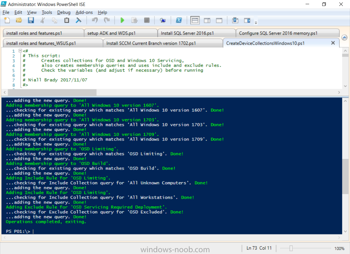

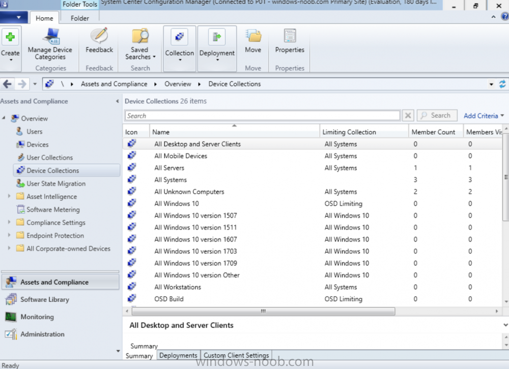

ok, apologies for the delay my lab died and i had to re-import all my vm's but it's running again now and i tested the script, you got the buggy one (sorry), i've re-attached the working one, please try it out and let me know if there's any problems or questions, i've tested it in a CM environment with no extra collections added and it worked just fine as you can see below,
give it a try !
image.pngcheers
