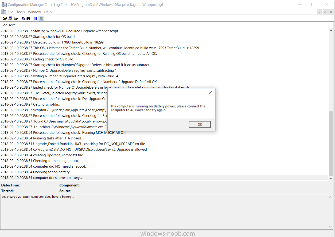

Just wanted to let you know that yesterday, i started using this script with a small group and found that the battery / ACpower detection part of the script doesn`t work.
It was not detecting that the laptop was plugged in even though it was and battery was fully charged.
I rem`ed out that part of the script to get around it and will tell the users to make sure they are plugged in during the upgrade.
i've just downloaded it, and tested it on my surface Pro 4 with power not connected and i see this, in other words,  it's working fine...by the way the battery check only occurs AFTER the user clicks on Upgrade Now... or the 5 defers and 4 hours timeout are done,
can you checek the Windows10RequiredUpgradeWrapper.log file and see what it states for that check ?
also, did you make any modifications to my script ? maybe you accidently bypassed that step somehow
