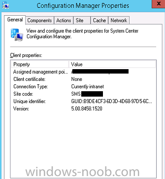

kesh Posted May 22, 2017 Report post Posted May 22, 2017 I have setup my new DP. I have followed all the relevant procedures - eg IIS, WDS Roles, added DP from console, setup my boundary groups, etc. My clients are visible in the console but the are only show as None for Computer Type, and No for client. The site is the the correct site code. The client activity is blank. On the SCCM client on each of the machines, the show client is like this: what I have so fat is to re-do my boundary groups, redo my DP and MP. There is still no luck. the ccmsetup file keeps having me this error and all the fixes on this site for this error haven't helped me.Failed to send HTTP request. (Error at WinHttpSendRequest: 0x80072f78) ccmsetup 2017-05-20 09:31:48 PM 3816 (0x0EE8) WinHttpRequestReponse failed with a non-recoverable failure, 0x80072f78 ccmsetup 2017-05-20 09:31:48 PM 3816 (0x0EE8) GetDPLocations failed with error 0x80072f78 ccmsetup 2017-05-20 09:31:48 PM 3816 (0x0EE8) Failed to get DP locations as the expected version from MP 'http://xxxxxxx'. Error 0x80072f78 ccmsetup 2017-05-20 09:31:48 PM 3816 (0x0EE8) Must the new DP server have its own certificate? Do i need to import it, and if so, how do I do that? Also I have tested the link from the client to to open these sites and they work. http://fqdn of site server/SMS_MP/.sms_aut?mplist Could a firewall issue cause this problem for the certificate? When one of the clients from this site went to another branch, the client installed automatically on the machine and was able to connect to that branch SCCM DP. I compared all my server and boundary settings with my working one and all are the same. I think it maybe be a firewall problem. How can I test this theory to confirm or what can I ask the network tech to check? I have all these for the new SCCM DP Server. Is it correct to have so many certificates? All my other DPs that are working on have 1 certificate each that show up in the console Quote Share this post Link to post Share on other sites More sharing options...
