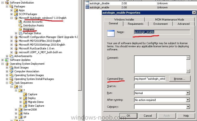

Once Imported you will have to supply it with two packages namely your X86 boot image and a new package called AutoLogin_windows7
The Autologin_windows7 packgage contains a registry file and a program

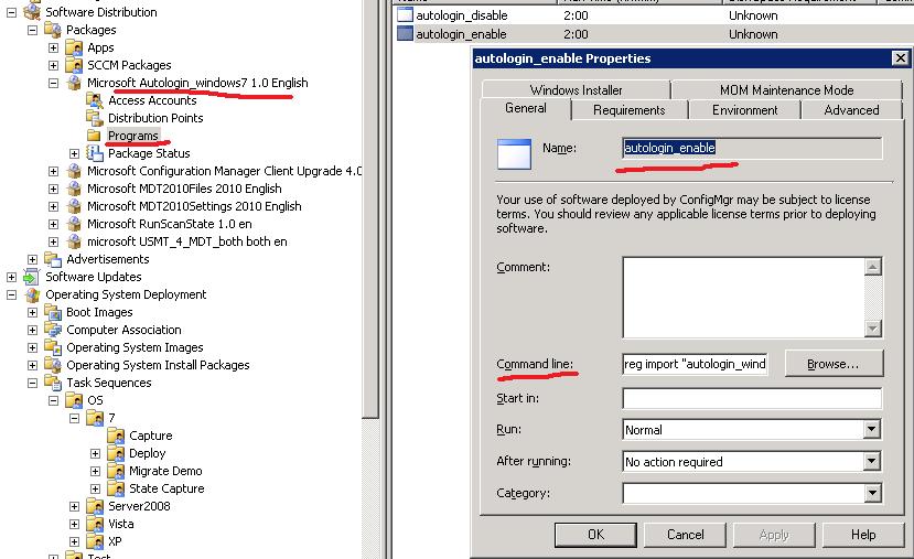

the Program is as follows:
reg import "autologin_windows7.reg"

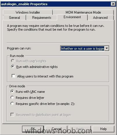

the properties are as follows:
and the autologin_windows7.reg registry file contains the following

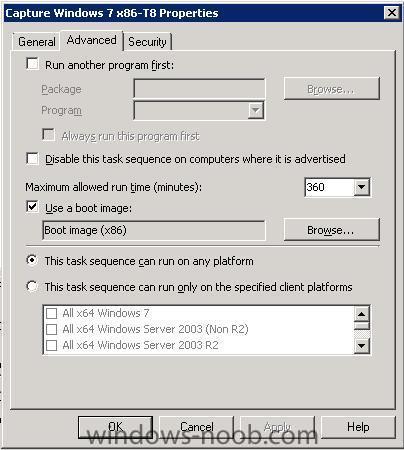

once done, make sure to edit your task sequence so that it's using your X86 boot image by right clicking on the Task Sequence, select properties and select the correct boot image,

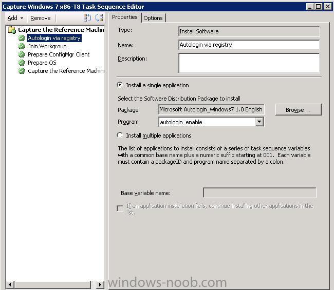

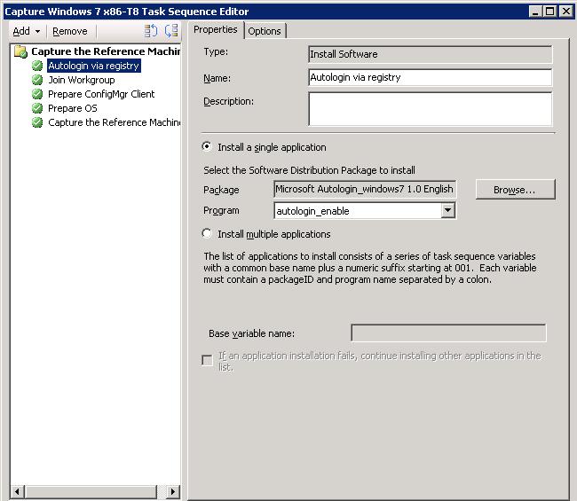

then make sure that the Task Sequence is using your new autologin package by right clicking on the Task Sequence and choose Edit,

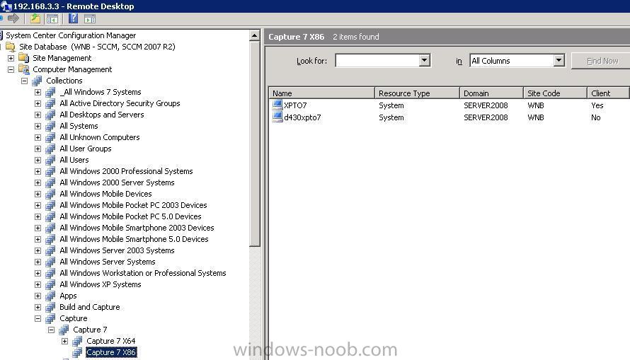

finally advertise it to a capture windows 7 collection and add a computer to that collection using direct membership
After you've added the computer to the collection, start it up, login to Windows, open control panel, open the RAP (run advertised programs) and kick off the Capture windows 7 task sequence.
