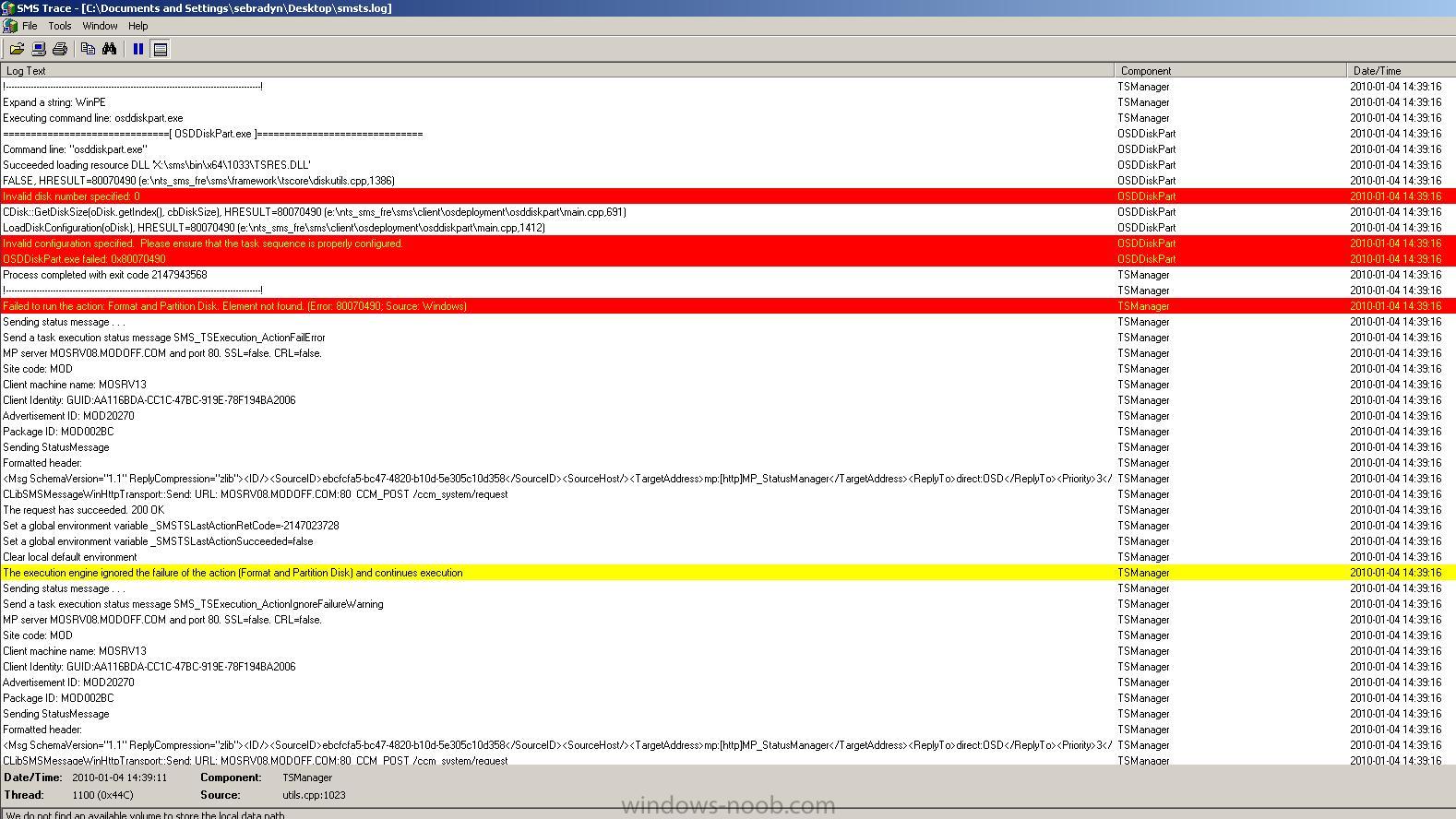

I have similar problem when trying to deploy Server 2003.
In the SMSTS.log on the server I get the following error:
Failed to run the action: Apply Operating System Image. Unspecified error (Error: 80004005; Source:Windows)
Dell Poweredge 1850
Windows Server 2003 R2 SP2
SCCM 2007 R2 SP2
Any ideas would be greatful.
Thanks
here's your problem
  Quote
Invalid disk number specified: 0
Invalid configuration specified. Please ensure that the task sequence is properly configured.
OSDDiskPart.exe failed: 0x80070490
Failed to run the action: Format and Partition Disk.
Element not found. (Error: 80070490; Source: Windows)
and
  Quote
Failed to save environment to (80070057)
Failed to save the current environment block. This is usually caused by a problem with the program. Please check the Microsoft Knowledge Base to determine if this is a known issue or contact Microsoft Support Services for further assistance.
The parameter is incorrect. (Error: 80070057; Source: Windows)
Failed to persist execution state. Error 0x(80070057)
Failed to save execution state and environment to local hard disk
so, is this a RAID system, is RAID configured in any way ? have you added storage drivers ? you'll need to provide more info about the hardware and setup and what you've done so far....
When I was watching it go through I noticed it seemed to fail at the diskpart stage but I wasn't sure for definite. I did add in the storage drivers but I have just lost the connection to my lab and I'm working from home so I will have to get the exact details later.
Did you you use the trace32 to find those other errors?
Thanks
It's R1 mirror, on a Perc 4di and I'm using the PERC 3/QC Raid controller and PERC RAID Virtaul Disk Controller drivers.
In the drivers package itself I have only these drivers and the nic drivers. Is there anything else I need to add?
Thanks
yup trace32 shows up the errors very nicely in red and yellow, after a while you get used to scrolling through it to find the info
Mine formats the disk ok, drops the image OK, but keeps perpetually rebooting.
