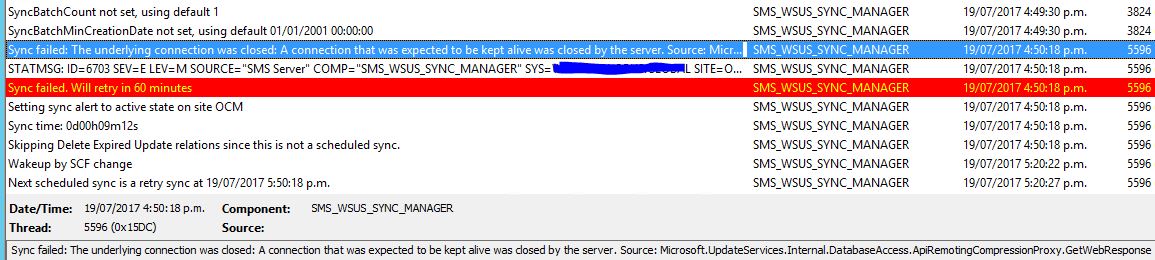

I have a single site server (v1702) with WSUS and SUP role on the same box. Everything has been running fine (mostly) for years but all of a sudden my client machines can no longer get updates. When syncing with the ClientWebService in IIS I get errors like these. The 0x80072ee2 error is a timeout i believe
I tried tweaking some IIS settings and increasing the RAM for the WSUS application pool thinking IIS was struggling with but that hasn't helped.

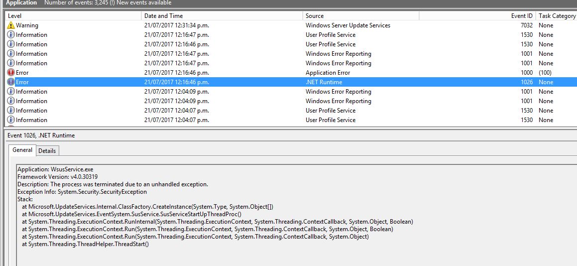

Looking at the logs I see stuff like this
syncmgr.log
wcm.log

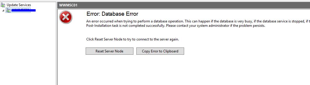

I also tried running the WSUS clean-up wizard thinking the DB has got out of hand but I can't even use that as I keep getting the reset node error as below every few minutes.
