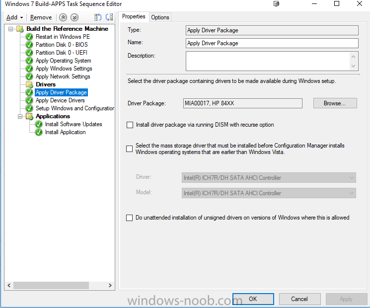

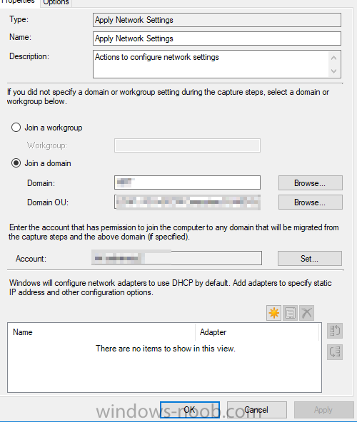

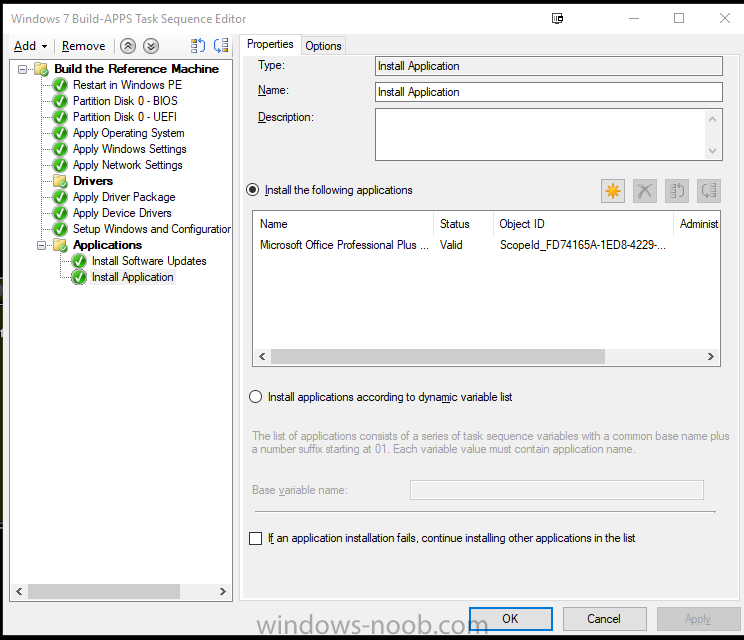

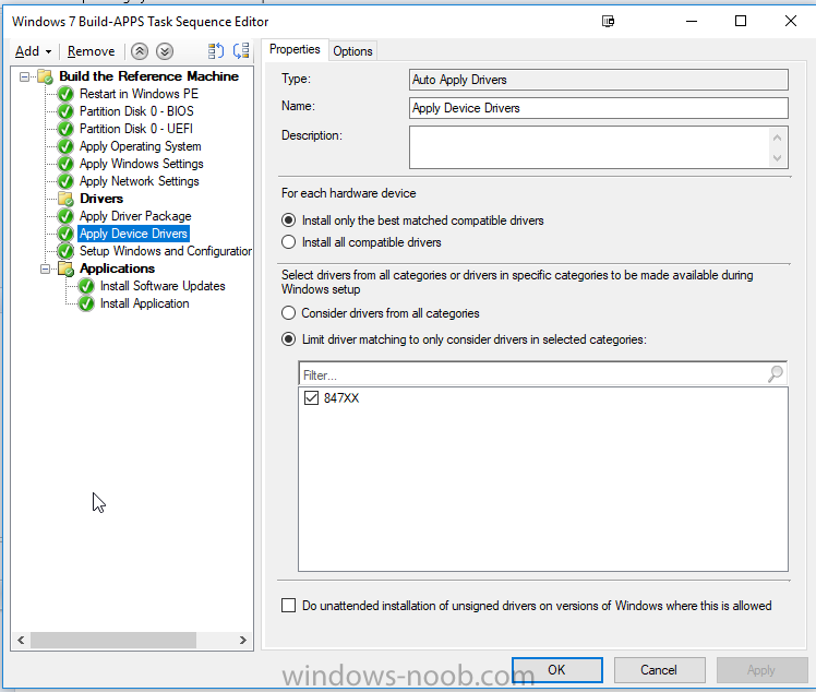

khloro Posted October 13, 2017 Report post Posted October 13, 2017 Even thou the OS installs It doesn't Join the Domain using my AD Admin creds. A simple task sequence of installing Office 2016 never makes it to the PC as well. Task Sequence smsts.log Quote Share this post Link to post Share on other sites More sharing options...

Config Mangler Posted October 17, 2017 Report post Posted October 17, 2017 If it is not joining the domain it will not install apps. You need to troubleshoot that area first. Most likely either network connectivity (no IP address, no NIC driver, no ping server FQDN etc.) or the account used is not doing the join. Quote Share this post Link to post Share on other sites More sharing options...
khloro Posted October 18, 2017 Report post Posted October 18, 2017 Thanks Config Mangler all i did was add a step to add to domain after drivers are applied simple solution thanks! Quote Share this post Link to post Share on other sites More sharing options...
