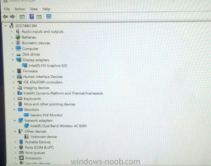

-Post-image the HP USB-C Elite Docking Station indefinitely installs drivers when anything on the computer is done (opening CMD, IE, etc.)
Troubleshooting thus far:
-If we image the device with only the install.wim from the Microsoft ISO, it works fine. This is a non-domain joined device with a local admin. Device works 100% as it should. Joins domain and still no issues
-If we image using my image (unmodified install.wim), but my drivers, it fails
-Created a package for drivers (tutorial found on this site) using DISM. This has worked perfect in 2012 R2 and now in CB
-Added the docking station executable after the driver install step. This was working (though dock still didn't work), but now this step produces "This version of %1 is not compatible with the version of Windows you're running"
-Opened a ticket with Microsoft Premier Support
-Opened a ticket with HP Elite support. They reviewed an IDR .cab file from the aforementioned working device and my broken device. Their engineers say it is missing key drivers and they need to be installed in a specific order. This still isn't working and the docking station is now failing with the "This version of %1 is not compatible with the version of Windows you're running" error
-I've installed every driver and firmware update I can find for these two items post-image and still nothing works

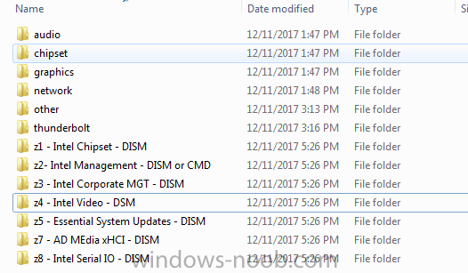

The only thing I have not done is imported drivers into SCCM natively and create a driver package. I've since done that and after this image finishes I will test that method. I was hoping to avoid this because in 2012 R2 I had many issues uploading drivers because SCCM was not handling duplicate drivers very well. I abandoned doing it this way so maybe I never learned how to properly do it since manually using DISM in the TS with packages worked flawlessly on 8 dells and 6 HP's -- but just no this x360
The above attempt failed. Same result; after logging in the device indefinitely began installing the docking station again.
I now have an image going with all of my drivers imported into SCCM with a standard package created.
If the standard SCCM package also fails, I am using the HP SoftPaq downloader and instead of creating a cab with "Show latest SoftPaqs", I am creating it with "Show all SoftPaqs" and "SSM Compliant". SSM Compliant means they will "automatically install". Moving the contents of this new cab into the above screengrabbed folder and redistributing content...
