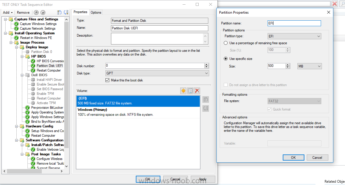

For my HP machines, I am trying to run a TS booted from USB into WinPE to format disk, make necessary changes in BIOS, then reboot into UEFI mode the apply OS.  The format disk and BIOS changes (using the BIOS config utility from HP) go through with no problem but encounter an error immediately upon getting to my reboot step. smstslog tells me "Unable to find a partition on the system disk that can be set as active" but im 95% positive im partitioning this thing proper.  After the failure error message, the machine then reboots into UEFI so go figure.   smstslog and TS attached.  Any advice appreciated!
