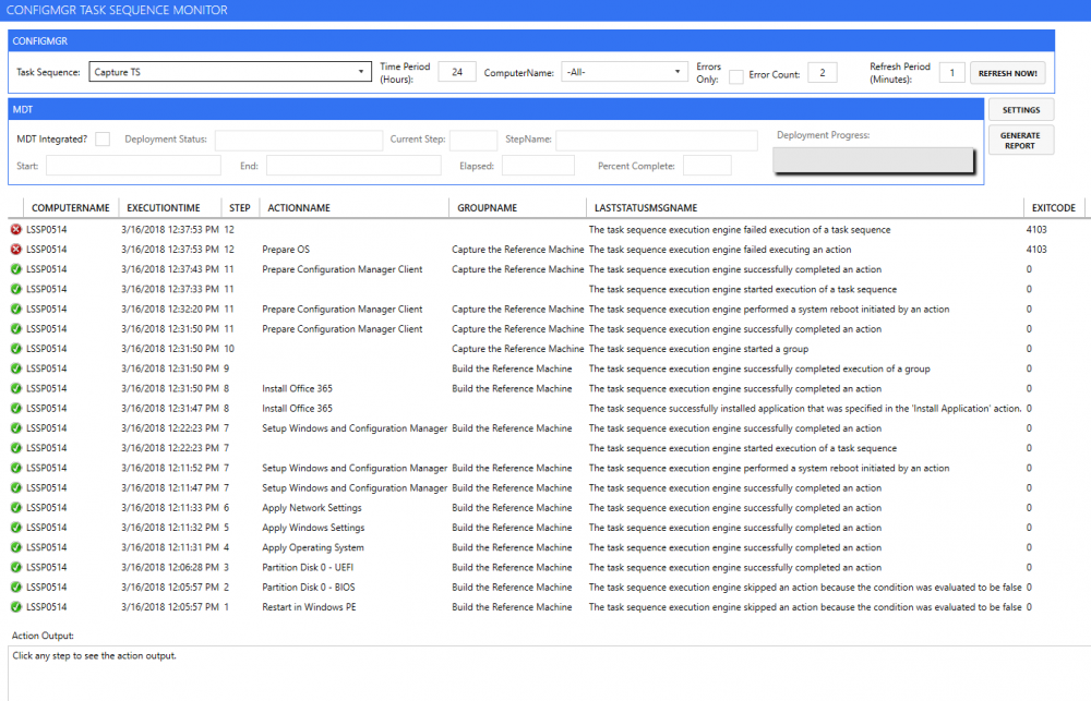

Error 0x00001007 when capturing Windows 10 Fall Creators Update 1709 via Task Sequence SCCM 1606
My task sequence is pretty simple, I just want to include Office 365 in it as it takes a long time to install during a normal W10 deployment, which is why I'm including it in my Capture.
It's coming up with this error
0x00001007
This is the log from CONFIGMGR TASK SEQUENCE MONITOR

Any help is much appreciated.
Edited by RiDER07
try re-distributing the content that it's failing the hash on, if that doesn't help, then redeploy the task sequence and try again
