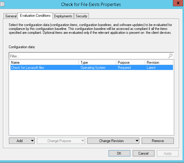

If you are looking for a specific file/version of a file, I have used "Compliance Settings" to do this.  It works well.  I configure it, let it run for a few days to collect my information, then I get a report.
Assets & Compliance --> Compliance Settings --> Create your Configuration Item --> Then create your baseline to scan or what ever your criteria is.  I attached a quick set of rules I have used.  The first 2 captures are the Configuration Item and the other is the action or baseline.
