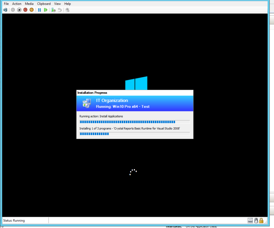

I'm having trouble installing applications after OS install in a Task sequence. The following pictures depicts what's happening. It says applications are installing and then it errors out and only the OS is installed. If I deploy the applications in their own task sequence, they install fine, so I know it's not the applications. Is there some step I need to add before installing the applications? I feel like I'm missing something.

So I figured out I need to set the SMSP property and the applications started installing. But at the end of the process I got this error:
Looks like they all installed fine, but why did I get such error?
