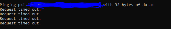

    after you ping the url pki.whatever.com it should list the correct INTERNET based ip address which you are sharing internet from in your pki lab, does it ?
    you are not answering my question, if you ping your pki.yourdomain.com it should return the IP address you configured in godaddy, does it ? and does that ip address also correspond to the internet ip address which www.whatismyipaddress.com revealed on the webserver ?
    NO ITS NOT  RETURNING THE IP. ITS RETURNING "REQUEST TIME OUT"
    NO
    then you may have issues with godaddy, because the ip address (in yellow) is returned from the DNS provider, if it returns no ip address then it is not resolving the url to an ip.
    use https://dnschecker.org/
    to verify what your configured url is telling you
    Hi @Mayur
    ok then you are contradicting what you said earlier, oh well, if it is indeed returning the correct ip address then that means godaddy is working, the 'request timed out' could be because of your firewall solution blocking ping or windows firewall itself, and it's not the end of the world,
    you now need to verify that you can browse the IIS welcome page on your url by browsing on a phone (not connected to wifi, use 3g instead..) to the http://pki.windows-noob.com
    obviously use your own url for this testing.
    if that doesn't work, then your vyos firewall is not routing port 80 correctly to the local ip address of the webserver
