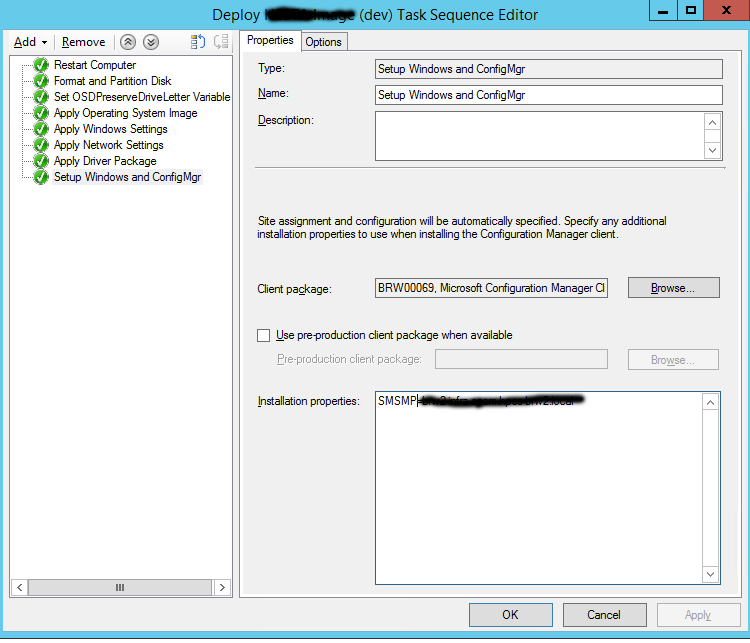

I've attached the task sequence steps. The reboot after 'Setup Windows and ConfigMgr' setups some drivers and so on, reboots again, and then goes to the default installed OS. The SCCM client is never installed. In essence the 'Setup Windows and ConfigMgr' task never really completes...
Appreciate your help on this so far ?

There were a couple of errors / warnings in the log along the way, I am not sure if they a relevant to the issue or not but I thought they were worth mentioning:
ShellExecute ('raserver.exe') failed. 0x80070002.	TSPxe	1/08/2018 9:29:33 AM	1264 (0x04F0)
Failed to open "SOFTWARE\Policies\Microsoft\Windows\WindowsUpdate" (0x80070002).	ApplyOperatingSystem	1/08/2018 9:52:47 AM	1780 (0x06F4)
Unsuccessful in releasing BRW0005F. 80070490.	OSDSetupWindows	1/08/2018 9:53:28 AM	1088 (0x0440)
The package ID mentioned above is the is actual OS Image.
The output from 'All Status Messages for a Specific Deployment at a Specific Site'  was exactly the same as the previous one.
I'm really scratching my head now.. could it be the image itself causing these issues? They are fairly basic images with a couple of additional small applications installed, nothing complex or really large in size.
