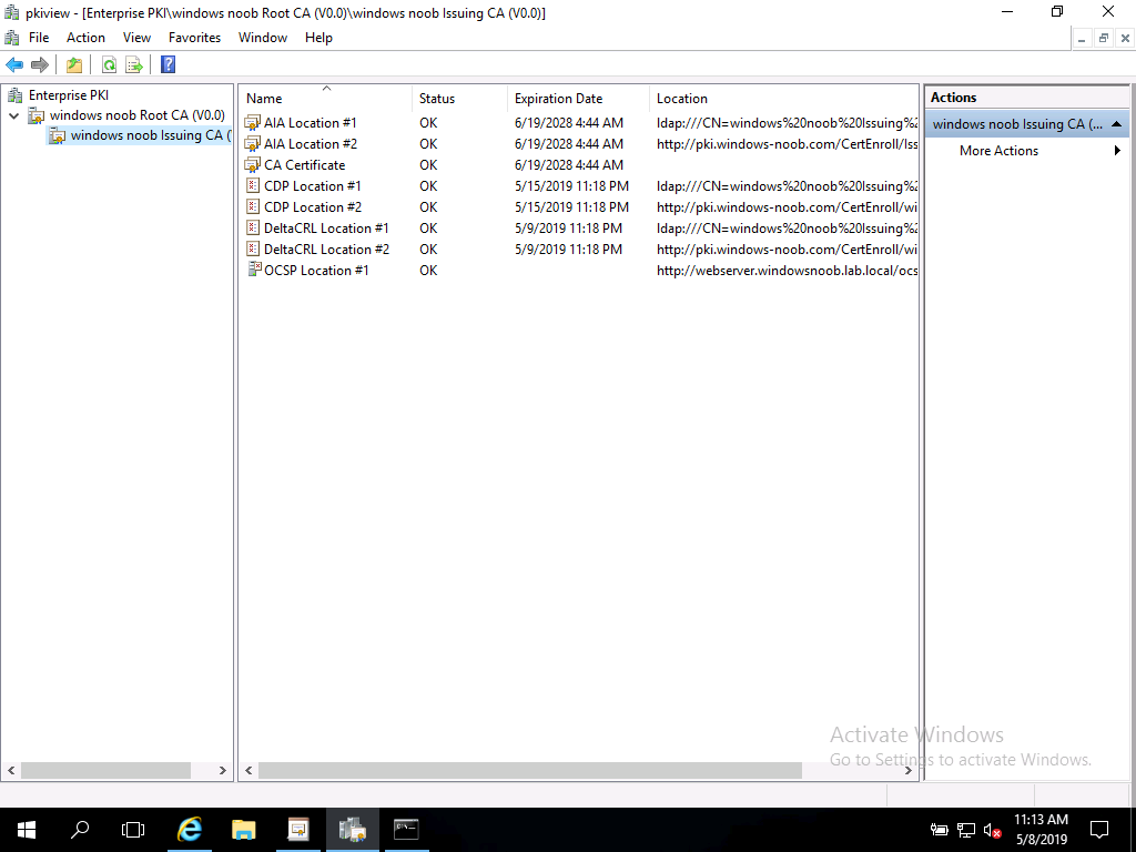

on the IssuingCA republished my certs and all is ok now. I've tested the PKI lab guides 3 separate times (I built 3 completely unique labs based on my own guides, eg: Lab #9, Lab #10, Lab #11) and all suceeded 100% as you can see below in my #11 lab...
I would suggest you guys try again and verify each and every step as you go, also, take checkpoints (snapshots) between each part so that you can always go back if you make a mistake, lastly, the pki.windows-noob.com webserver URL, will of course be your 'own' url, and it must be reachable by the issuing CA and others or pkiview.msc will list a bunch of errors/failures.
Troubleshooting Tip: in PKIview.msc, highlight an entry and click on the Refresh button in the ribbon, it should re-verify the highlighted item.
also, can you guys post screenshots of your issue(s) so we can try and figure out what the issue really is

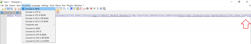

Great guide! I initially had the 'CDP Location' and 'unable to download' issue. For me, it was the http entry CDP #2. One thing I did notice is the the path shown using pkiview ended with '.crl%EE%BE%FF' rather than just the '.crl' (I can't remember the exact hex numbers). I could get to the crt via http if I removed the percentage part.
I looked in the registry on RootCA and the CDP #2 path was last entry in the value. I know that each line must end with a return (in the registry), but for this particular line, there was an extra invisible character included before the return. I removed it (but kept the return), then republished from root > issuingca and it started working
Maybe this is due to cut-and-paste from the website? If anyone has a similar issue, check the registry of potentially affected machines for invisible characters. I was scratching my head and looking at other stuff, so I can't be sure that this was the cause, but the %EE%EF%FF didn't seem right.

I've seen this before too, and i thought i fixed all code in the 8 part series, if you could point me to the commands that you copied the code from i'll verify them again (with notepad++)
It was in Part 4. There are two sections:
Step 3. Configure the AIA
certutil -setreg CA\CACertPublicationURLs "1:C:\Windows\system32\CertSrv\CertEnroll\%1_%3%4.crt\n2:ldap:///CN=%7,CN=AIA,CN=Public Key Services,CN=Services,%6%11\n2:http://pki.windows-noob.com/CertEnroll/%1_%3%4.crt"
Step 4. Configure the CDP
certutil -setreg CA\CRLPublicationURLs "1:C:\Windows\system32\CertSrv\CertEnroll\%3%8%9.crl\n10:ldap:///CN=%7%8,CN=%2,CN=CDP,CN=Public Key Services,CN=Services,%6%10\n2:http://pki.windows-noob.com/CertEnroll/%3%8%9.crl"
I triple-clicked to select the text, then copy pasted into notepad so I could change the name of the .crt and .crl
I've just copy-pasted into notepad again, and now I'm looking for it, I can recognise that the invisible characters are there.
I'm using Firefox 68.0.1
ok thanks, i'll fix it today, i can see the characters when switching to Ansi in NotePad++, so are these the characters you are referring to ?
I've no idea how they ended up there, maybe it's the forum software...
