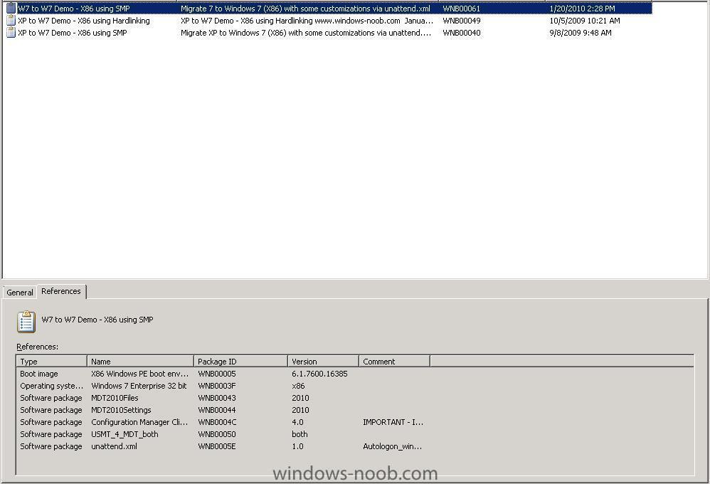

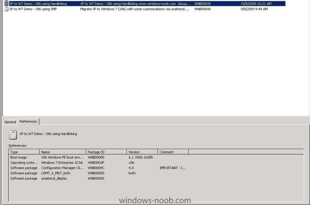

simply import these task sequences into ConfigMgr, and replace the missing package references (configmgr X86 boot images, microsoft deployment 2010 settings, mdt2010 files, windows 7 autologin enable package, usmt4 package and the Windows 7 X86 WIM file itself).
See below screenshots to help you with that
Task Sequence References with hardlinking
Task Sequence References with SMP

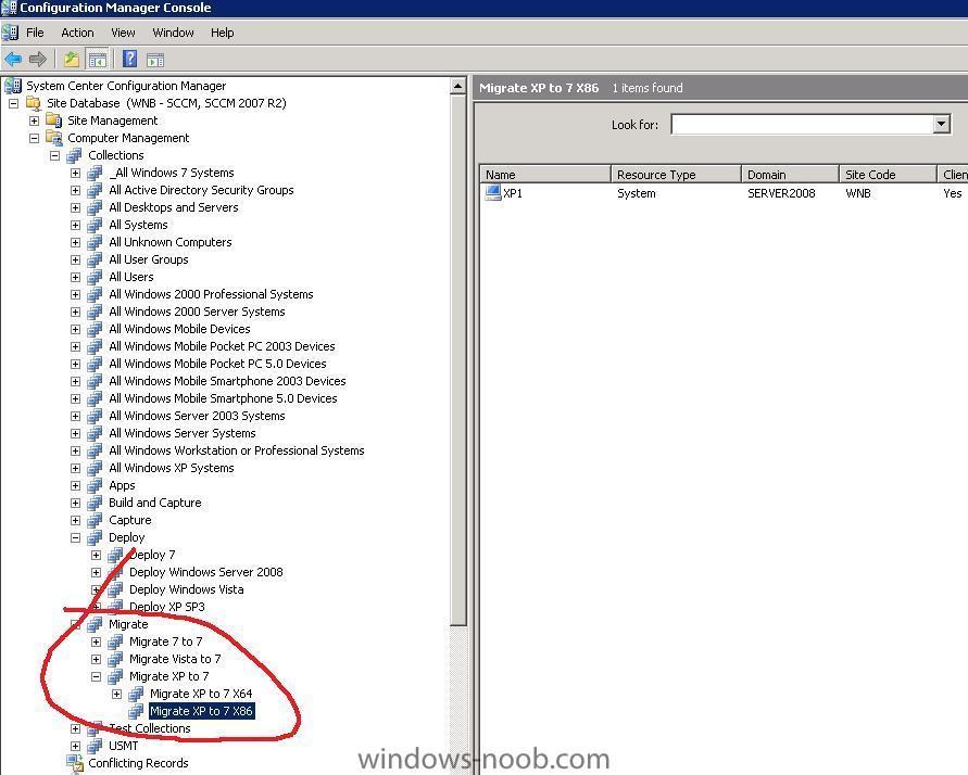

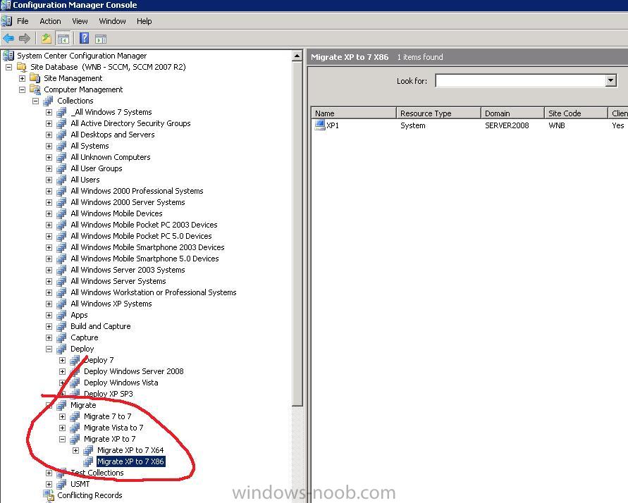

and then advertise the task sequences to a migrate XP to Windows 7 collection
add computers to the Migrate XP to Windows 7 collection and kick off the appropriate TS via RAP.
