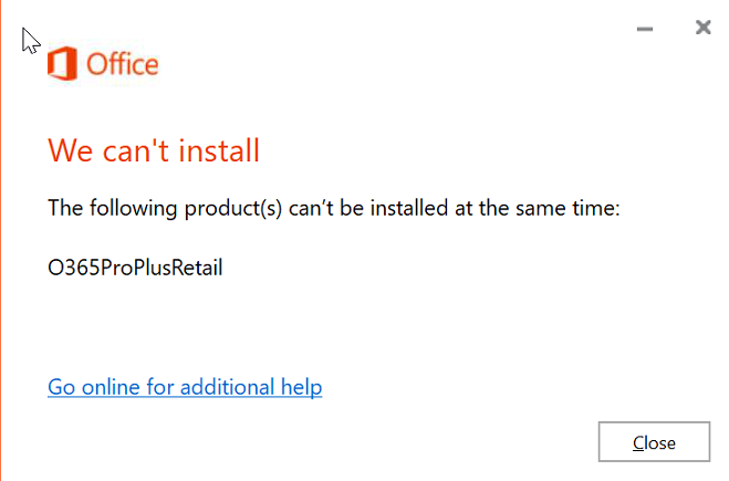

kleonard Posted September 7, 2018 Report post Posted September 7, 2018 I have been installing O365 2016 click to run using the same job in SCCM for the past 6 months. Beginning this week, when trying to install O365 we get the following error: Office We can't install The following product(s) can't be installed at the same time: O365ProPlusRetail. I have tried removing and reinstalling with the same results. Installation by hand gives the same result. There are no error codes, just a link to go online for more help. It could be purely coincidental but it started happening right after Microsoft had the cloud outage in the Southeast at the beginning of this week. Does anyone have any ideas? Quote Share this post Link to post Share on other sites More sharing options...
Drew Whittle Posted September 12, 2018 Report post Posted September 12, 2018 I just noticed this error as well. Ended up downloading the latest O365 deployment tool (updated setup.exe) and my packages are now working as expected. Weird... Quote Share this post Link to post Share on other sites More sharing options...
kleonard Posted September 12, 2018 Report post Posted September 12, 2018 I did the same thing, and it worked for the first couple of deployments. Then on one deployment I got a progress bar which went about 1% and just stopped and has been sitting there for about 4 hrs like that. I tried another PC and now I get nothing again. Im scratching my head over this one. Quote Share this post Link to post Share on other sites More sharing options...
