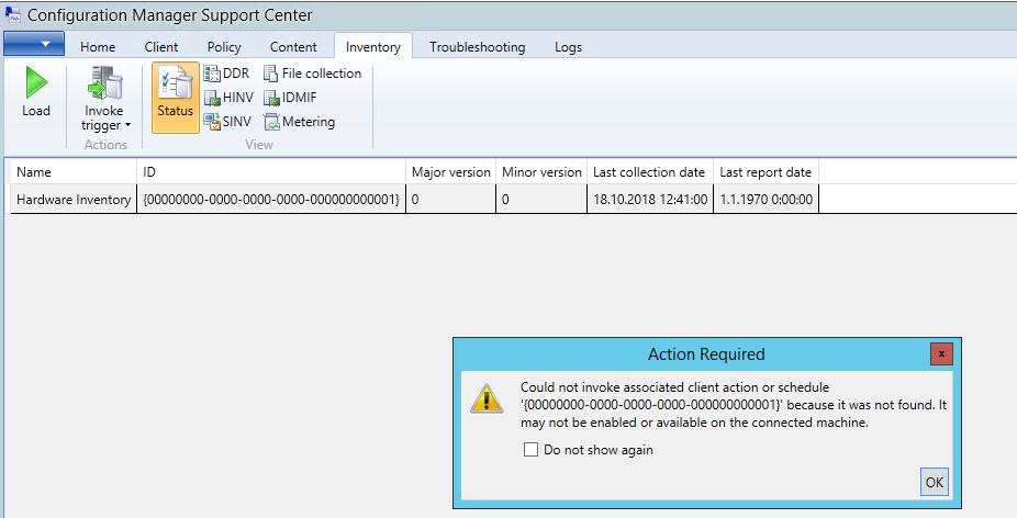

Hi guys,
I've been struggling with this one for over a week. I updated SCCM from 1710 to 1806. Had some trouble with AV software, but all in all the update finished with success. All components seems to be working (OS deployment, Software updates, Application Installation...). But hardware inventory just won't work, neither on workstations and neither on servers. In InventoryAgent.log there always appears the same message:
Inventory: *********************** Start of message processing. *********************** InventoryAgent 12.10.2018 8:50:14 5128 (0x1408)
Inventory: Message type is InventoryAction InventoryAgent 12.10.2018 8:50:14 5128 (0x1408)
Inventory: Temp directory = C:\Windows\CCM\Inventory\Temp\ InventoryAgent 12.10.2018 8:50:14 5128 (0x1408)
Inventory: Clearing old collected files. InventoryAgent 12.10.2018 8:50:14 5128 (0x1408)
Inventory: Opening store for action {00000000-0000-0000-0000-000000000001} ... InventoryAgent 12.10.2018 8:50:14 5128 (0x1408)
CInvState::VerifyInventoryVersionNumber: Mismatch found for '{00000000-0000-0000-0000-000000000001}': 15.5 vs. 0.0 InventoryAgent 12.10.2018 8:50:16 5128 (0x1408)
Inventory: Version number mismatch; will do a Full report. InventoryAgent 12.10.2018 8:50:16 5128 (0x1408)
Inventory: (80004005) InventoryAction does not exist () InventoryAgent 12.10.2018 8:50:16 5128 (0x1408)

steps I have tried so far:
- Repair CM Client
- Uninstall/install Client
- Created custom HINV setting and deployed, but still same error
- Forced a full HW inventori via WBEM https://blogs.technet.microsoft.com...p-forcing-a-full-hardware-inventory-for-sccm/
I am managing arround 4000 clients, and HINV doesn't work on any of them. Also there is no SCCM Hardware inventory task in Task Scheduler. On the other hand, software inventory works fine.
Previous to the upgrade, Hardware Inventory worked.
Can anyone please point me in the right direction to solve this problem.

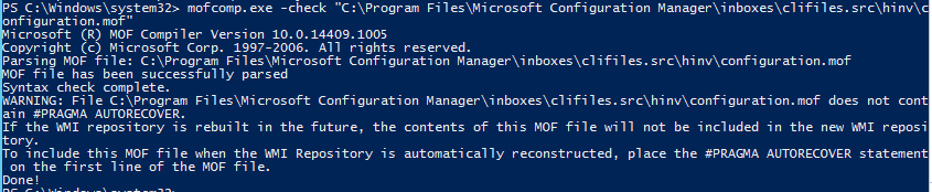

When that has happened to me before--and it has--it's almost always 'something' in the configuration.mof file.  My suggestion for you is to take a copy of your current \clifiles.src\hinv\configuration.mof file, and save it ELSEWHERE.
then on your primary site (or cas, if you're cursed with a cas), go to <installed location>\Data\HinvArchive  In there will be multiple backups (usually 5) of previously used configuration.mof files.
Hopefully you have one backup from prior to your upgrade--aka, a known good one.  Grab a copy of it (or if you're super paranoid, copy every file in \hinvarchive to another location, just in case), but copy a "I think it's good" configuration.mof.bkxxx file, rename it to just configuration.mof, and drop it into \clifiles.src\hinv, replacing the one you mofcomp'd and it was a success... but I'll bet there's still something wonky with it.
Once you've copied in an old one, monitor dataldr.log on the primary site, make sure it's not rejected.  Then a couple of policy refreshes on a client, and carefully watch policyagent.log on that client--make sure it doesn't error on getting a new policy.  If policyagent.log says all is good... go check if the inventory action is back in the control panel applet.  If so, your clients should start sending inventory again.
Once you have inventory working again, then use your favorite text comparison tool, and compare the one you restored, vs the one you pulled out--and see what's different.  I could be as simple as a special character somewhere in the mof file which although passes a "syntax" check (mofcomp -check), still is not able to be processed at the clients and compiled.
Hi Sherry, I found 5 bak files dating 3 years back and 5 bad.bak dated last year. Tried them all, but all they do is remove Hardware inventory action from CM Applet.
When copying them to hinv folder I see Warning in dataldr.log: Warning - could not get current time/date/crc of C:\Program Files\Microsoft Configuration Manager\inboxes\clifiles.src\hinv\configuration.mof (retry later)
When applying back the original configuration.mof file I receive error on applying 2 policies in PolicyEvaluator.log:

    Namespace = "\\\\.\\root\\cimv2";
    Properties = "BankLabel, Capacity, Caption, CreationClassName, DataWidth, Description,         1.1.1601 0:00:00    1682186272 (0x64442020)
Bad policy dumped to C:\Windows\CCM\Temp\badpolicy-SMS_PSM-{bede4f4a-65f8-41f7-89bb-02b01bc5862b}-63.00-{091bb494-310a-4acc-8351-66ecab5e7d8a}.txt    PolicyAgent_PolicyEvaluator    19.10.2018 9:11:00    18916 (0x49E4)
Already sent a policy rule application failure status message within the last 6 hours, not sending.    PolicyAgent_PolicyEvaluator    19.10.2018 9:11:00    18916 (0x49E4)
Failed to apply policy rule {091bb494-310a-4acc-8351-66ecab5e7d8a}.    PolicyAgent_PolicyEvaluator    19.10.2018 9:11:00    18916 (0x49E4)
The policy CCM_Policy_Policy5.PolicyID="{bede4f4a-65f8-41f7-89bb-02b01bc5862b}",PolicySource="SMS:PSM",PolicyVersion="63.00" failed to compile. State has been set to 'Error' and policy will be rolled back.    PolicyAgent_PolicyEvaluator    19.10.2018 9:11:00    18916 (0x49E4)
So what can I do about sms_def.mof file?
