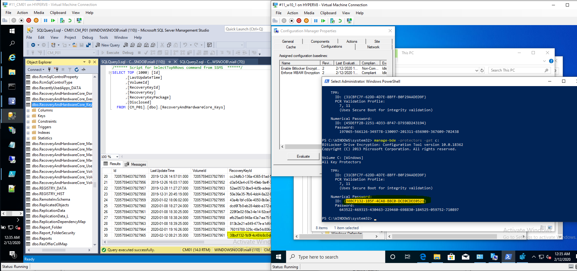

If you have a computer that is already encrypted with Bitlocker, let's say with AES 128 (or some other encryption algorithm), and you later add this computer to your Bitlocker Management collection that has a policy targeted to it, the computer will get the Bitlocker management policy and then decide whether it is compliant or not based on the settings of that policy, it will NOT re-encrypt the already encrypted drive (if for example the algorithm doesn't match your configured Bitlocker Management policy).
In addition on that already encrypted drive, regardless of whether or not it is compliant with your bitlocker management policy, the MDOP agent will rotate the existing bitlocker recovery key and store the newly rotated recovery key in the ConfigMgr database.
In the screenshot below you can see the recovery key has rotated on the already encrypted (with Bitlocker) client, and the new key is now stored in ConfigMgr's database, this computer was previously encrypted with Bitlocker using GPO settings from AD but it doesn't matter how it was encrypted with Bitlocker, the fact is it was already encrypted.

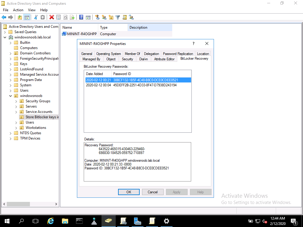

Side note #1: if you were saving the key to your on-premises Active Directory prior to using the Bitlocker Management features in ConfigMgr, then the newly rotated recovery key will also be stored in Active Directory

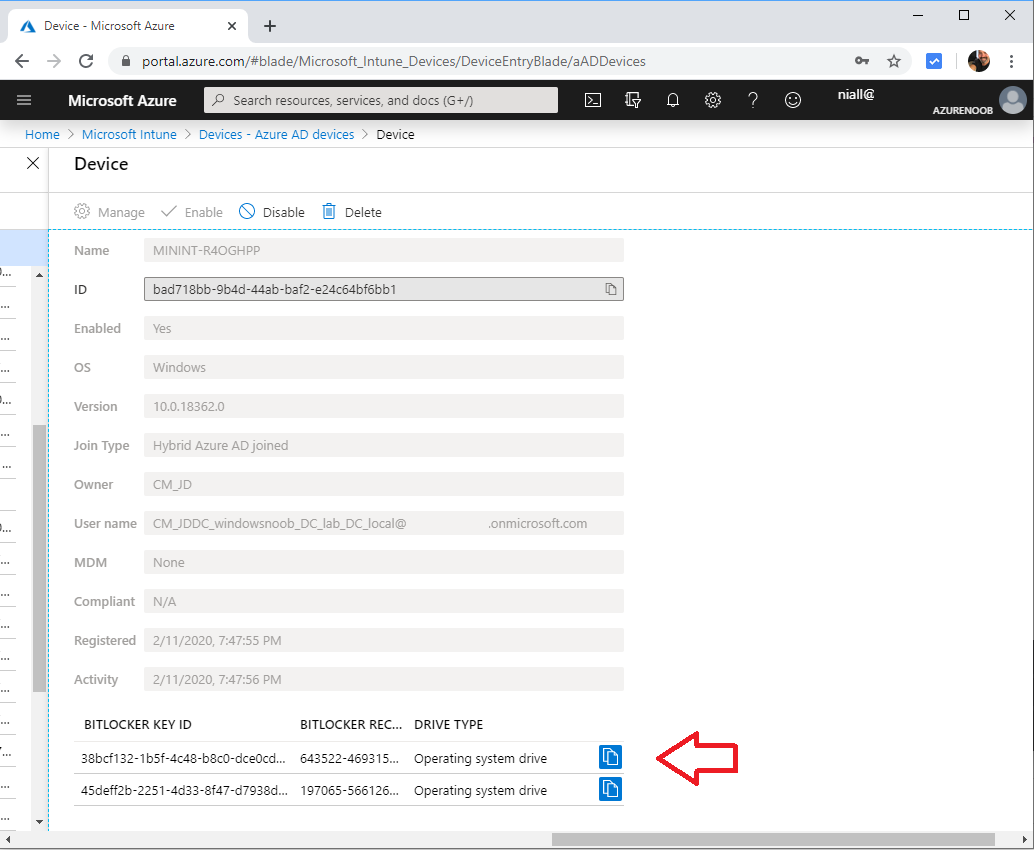

Side note #2: Those same keys will also be stored in the cloud (if you have Azure AD connect setup) as shown below:
Starting Windows 10 v1903 the keys are now backed up to On-Prem AD and to Azure AD on Hybrid Joined machines provided the machine has line of sight to On-Prem DCs and Internet connectivity to reach Azure AD for backing up keys. Source: https://microsoftintune.uservoice.com/forums/291681-ideas/suggestions/34015732-bitlocker-recovery-keys-in-a-hybrid-aad-joined-dev
What about compliance of your Bitlocker Management policy ?
if you look closely at the first screenshot, you can also see that the client is non-compliant for the 'enable bitlocker encryption' Bitlocker Management policy i created, and that is because this client computer only has AES-128 as the algorithm and the policy requires AES-256,
to resolve the compliance problem, you'd have to decrypt the drive and then re-encrypt with the correct algorithm as defined in your Bitlocker Management policy in ConfigMgr,
only after doing that would it register as compliant
