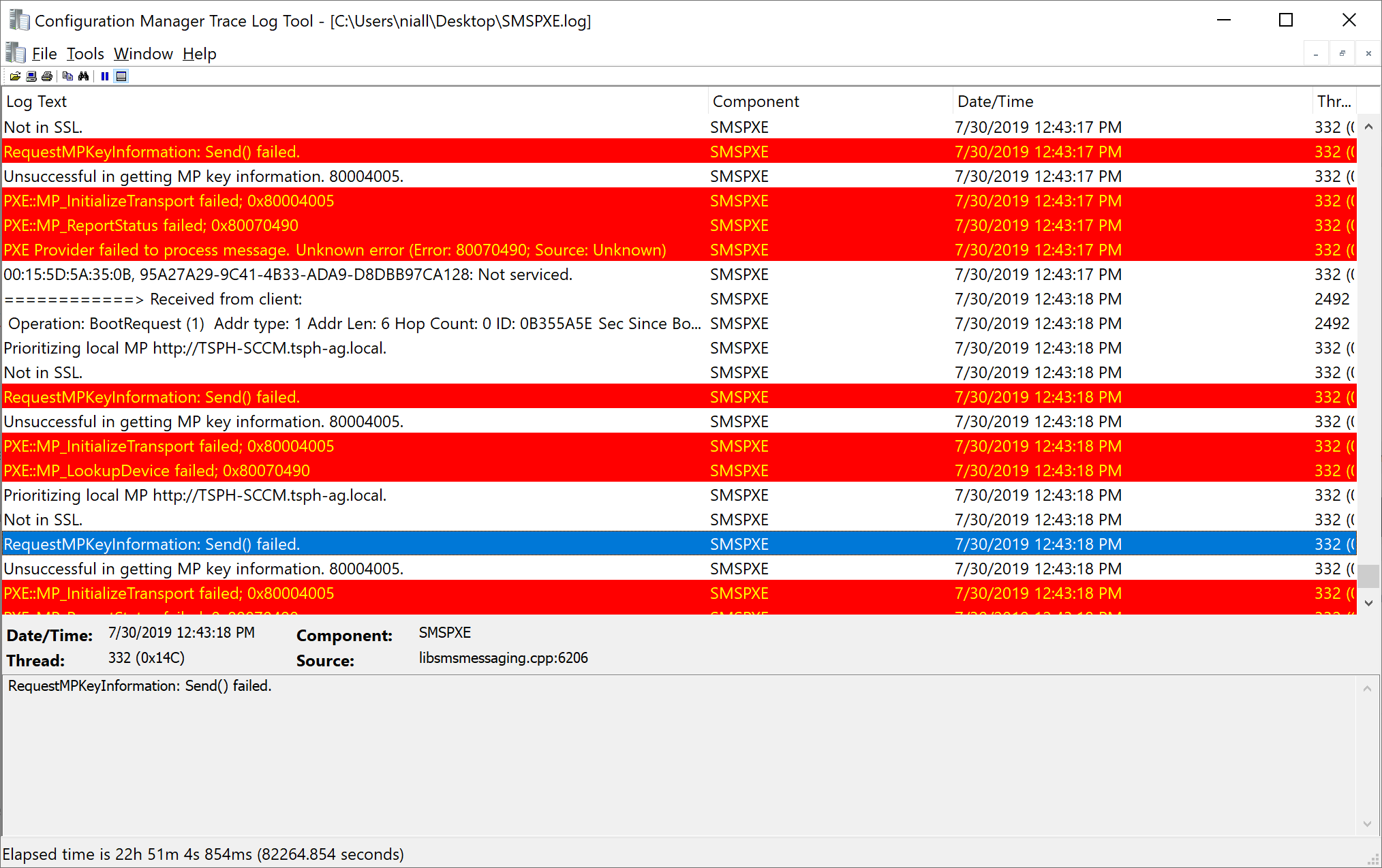

try uninstalling the Management Point role, then reinstall it, then retest PXE on the dp. You've a lot of management point errors in that log
RequestMPKeyInformation: Send() failed.
  On 7/31/2019 at 8:45 AM, anyweb said:
how are you boundaries setup ? did you configure two separate boundaries for these 2 offices ?
Expand
Sure are, 2 separate boundaries based on IP add ranges - no overlap. Am I right in saying that this is something handled by WDS? I mean, DHCP is doing what its supposed to which is issuing a IP address. It just so happens that the issuing DHCP server is also a PXE enabled DP (that should be serving its own office only)
