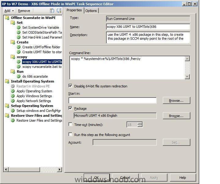

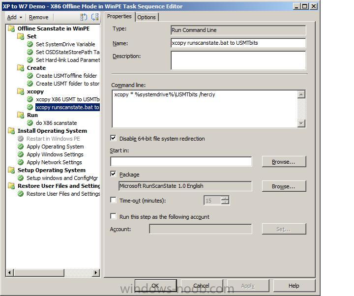

In the xcopy group we do the clever stuff, we copy the X86 USMT stuff to the newly created folder, and then we copy our batch file for later user.

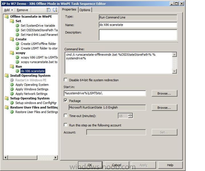

The Run group does the actual running of the batch file and passes two variables to the file.

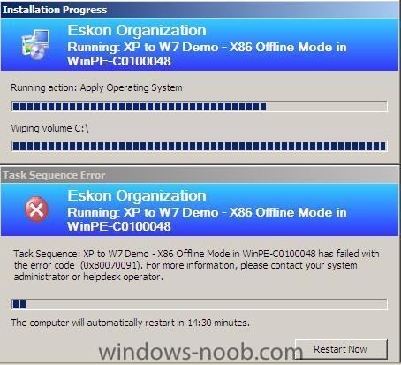

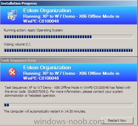

Created a Media from the TS(off-line mode) and boot from DVD on a standalone machine to upgrade to win 7 but it fails at wiping the system Drive task.could not find any error messages form the smsts.log .Attached the screenshot as well Log file.(PAckage ID:C0100047 is runscan state and C0100049 is USMTx86) .anything wrong in the TS?
smsts.log
hi Eswar,
if you press f8 before it gets this far can you browse to c:\ and do you see the folders we need to create like c:\usmtoffline etc ? remember when testing if you fail for whatever reason that you'll have to delete those two usmt folders as i havn't built in any checking into the TS to see if they are there already (in the create folder part...)
Yes,it created 2 folders and i am testing it on Virtual with option Undo Disk(which doesnt require to delete created folders)
Hmmmm.The interesting thing is ,i ran it once again on a Vitual to see if it works.It passed the wiping system drive without any error and now applying the image.There are no changes that has been done since this error occurd but it works greatly.I will let you know the result on this soon!
