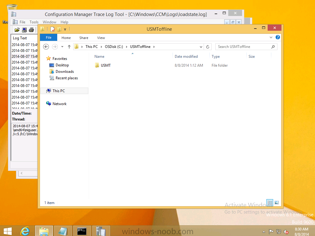

Once it is completed your migrated data will now be stored in C:\USMToffline\USMT
browse it and verify

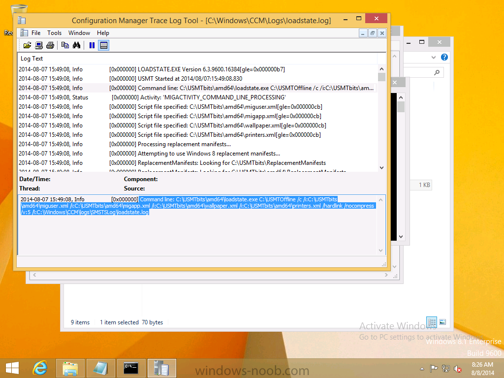

Ok now what ?
So how will I be able to use your xml files and other associated items if I'm going from windows xp 32 bit to windows 7 64 bit as far as files and folders within the task sequence?
Paul
Thanks for all your helpful SCCM 2007 guides they have been great (understatement) references. I was nearly there and about to celebrate until I noticed that the migrated files have not inherited permissions of their user and that there are padlocks on all of the files that migrate across. For example username JB had a document called letter.txt on their desktop which is migrated across. The document is there but when checking the permissions of the file only myself, administrators and system have full control on it and there are no other permissions meaning it is useless for JB. On checking the parent folder Desktop this has the correct permissions and allows user JB full control.
I know I can simply inherit the permissions but that won't be handy when doing this on 1000's of PCs. Is this anything that has been experienced before I couldn't see it on the previous 14 pages.
Thanks.
Edit : I tested this on Windows 7 to Windows 7 migration, is this specifically XP to Win 7?
interesting i havn't seen this behaviour, right now i'm using the bitlocker frontend HTA (which incorporates this functionality), and i've not noticed any padlocks, can you show me a screenshot and are you using Configuration Manager 2012 or 2007 for this ?
Paul
easy, use x86 to capture (scanstate) and x64 to restore (loadstate) in terms of USMT.

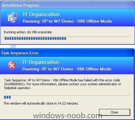

i followed the process but it is failed in Runscanstate(do X86 Scanstate) with below mentioned error . can you please help me on this
Failed to run the action: do X86 Scanstate.
The specified disk or diskette cannot be accessed. (Error: 0000001A; Source: Windows)]LOG]!

scanstate log:-
2014-06-08 12:42:40, Info [0x000000] Command line: c:\USMTbits\x86\scanstate.exe c:\USMToffline /c /o /hardlink /efs:hardlink /nocompress /offlinewindir:c:\windows /v:5 /l:c:\windows\TEMP\SMSTSLog\scanstate.log /progress:c:\windows\TEMP\SMSTSLog\scanstateprogress.log /i:c:\USMTbits\x86\miguser.xml /i:c:\USMTbits\x86\migapp.xml
2014-06-08 12:42:40, Status [0x000000] Activity: 'MIGACTIVITY_COMMAND_LINE_PROCESSING'
2014-06-08 12:42:40, Error [0x000000] Invalid Windows folder for offline gather to start - c:\windows[gle=0x00000003]
2014-06-08 12:42:40, Info [0x000000] Failed.[gle=0x00000006]
2014-06-08 12:42:40, Info [0x000000] Unable to find a valid Windows directory to proceed with requested offline operation;

Hi guys. We have an Offline refresh USMT TS and our Restore User State step fails. TS is set to Access content from DP. NTFS/Share permissions are ok. I have deleted previous store folders before running the TS again. The Restore User State Step in the Task Sequence is set to use default unmodified MigUser.xml. Any ideas will be much appreciated!
smsts.log:
Executing command line: "\\DISTRIBUTIONPOINT\PACKAGE\x86\loadstate.exe" "C:\USMToffline" /c /v:5 /l:"C:\Windows\system32\CCM\Logs\SMSTSLog\loadstate.log" /progress:"C:\Windows\system32\CCM\Logs\SMSTSLog\loadstateprogress.log" /i:"\\DISTRIBUTIONPOINT\PACKAGE\x86\MigUser.xml" /hardlink /nocompress OSDUSMT 07/08/2014 05:02:05 p.m. 424 (0x01A8)
Process completed with exit code 27 OSDUSMT 07/08/2014 05:02:05 p.m. 424 (0x01A8)
USMT completed with exit code 27 OSDUSMT 07/08/2014 05:02:05 p.m. 424 (0x01A8)
uExitCode == 0, HRESULT=8007001b (e:\nts_sms_fre\sms\client\osdeployment\osdusmt\main.cpp,384) OSDUSMT 07/08/2014 05:02:06 p.m. 424 (0x01A8)
USMT returned exit code (0x0000001b). Look USMT log file loadstate.log for detail error message. OSDUSMT 07/08/2014 05:02:06 p.m. 424 (0x01A8)
OSDMigrateUserState finished: 0x8007001b OSDUSMT 07/08/2014 05:02:06 p.m. 424 (0x01A8)
Process completed with exit code 2147942427 TSManager 07/08/2014 05:02:06 p.m. 1852 (0x073C)

Thanks sir. I have been able to get it sorted out. I was copying amd64 folder instead of x86, hence the error. If I may, let me ask you another question: I only want to to migrate my domain user profile and its files/folder (C:\users\MYDOMAINUSER\) and not local users.. Nothing fancy, no file exclusions, only my domain user folder.
Logs show that everything works, however, my user profile is not being copied. My loadstate.log shows that my command line is the following:
\\DISTRIBUTIONPOINT\USMTPACKAGE\x86\loadstate.exe C:\users\public\USMToffline /v:5 /l:C:\Windows\system32\CCM\Logs\SMSTSLog\loadstate.log /progress:C:\Windows\system32\CCM\Logs\SMSTSLog\loadstateprogress.log /i:\\\DISTRIBUTIONPOINT\USMTPACKAGE\x86\MigUser.xml /hardlink /nocompress /ue:*
In my TS, the Restore User State step is set to Customize how user profiles are restored, and MigUser.xml is selected (I do not know if this is redundant or not).MigUser.xml is unmodified.
