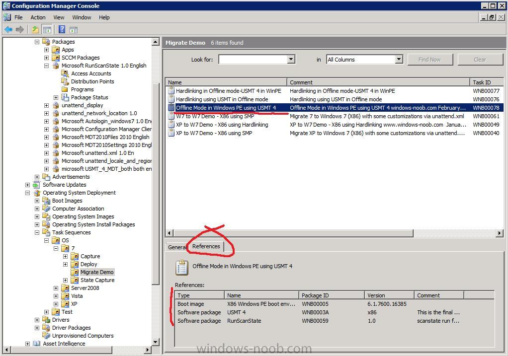

The task sequence depends on three packages, the X86 bits from your USMT 4 (ie: copy everything in the X86 folder from C:\Program Files\Windows AIK\Tools\USMT folder. There are two versions, one for 32bit (X86) and one for 64bit (amd64), we are only using the X86 bits in this guide), the Batchfile

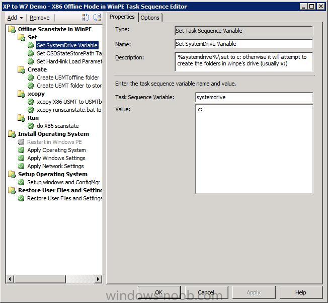

SET

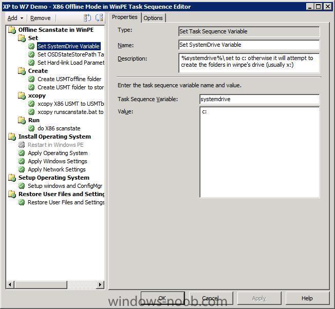

In the Set group I set SystemDrive to c: (otherwise it will try and do this on the windows PE x: drive)

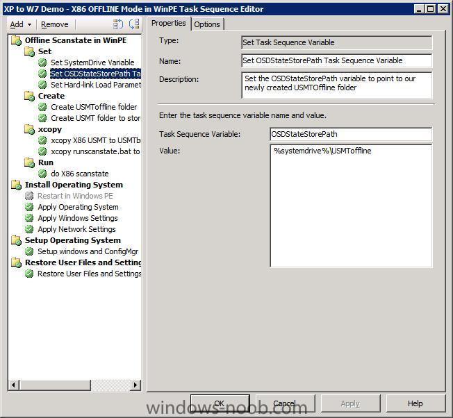

Next we set the OSDStateStorePath Task Sequence Variable to %systemdrive%\USMToffline which translates to c:\USMToffline, this directory will store our migration data during scanstate operations and when the new os is being applied.

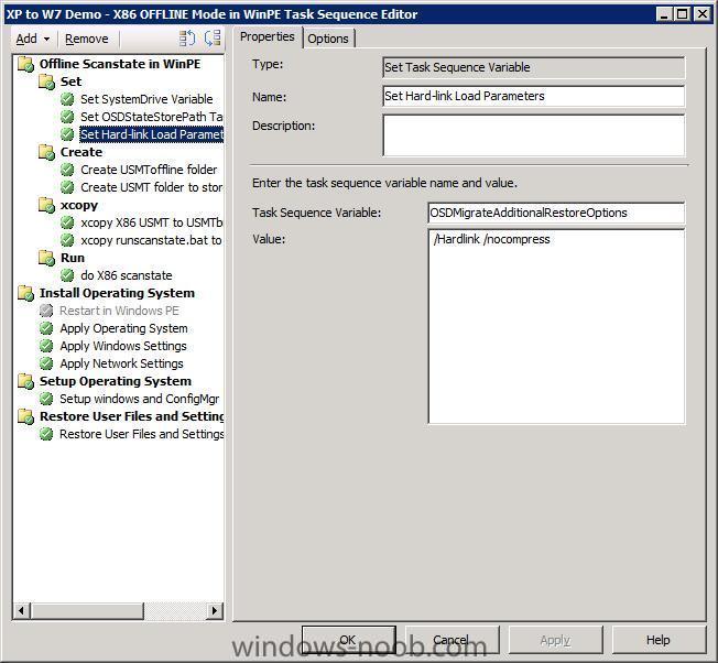

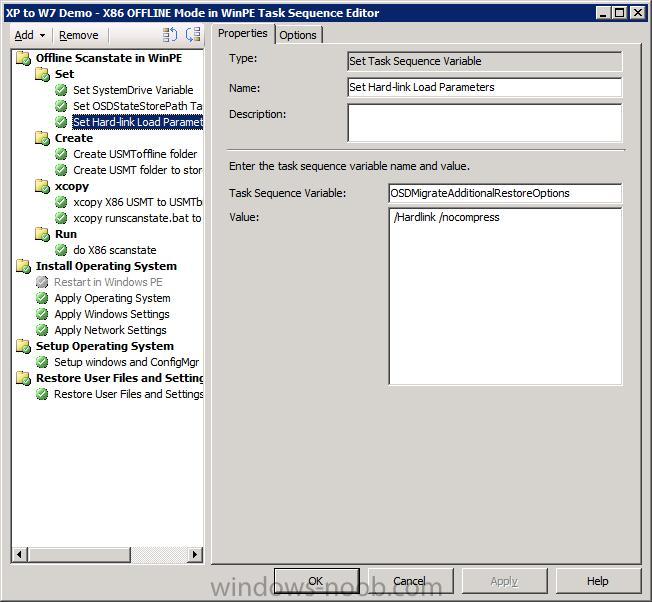

Finally we set the hardlink load parameters

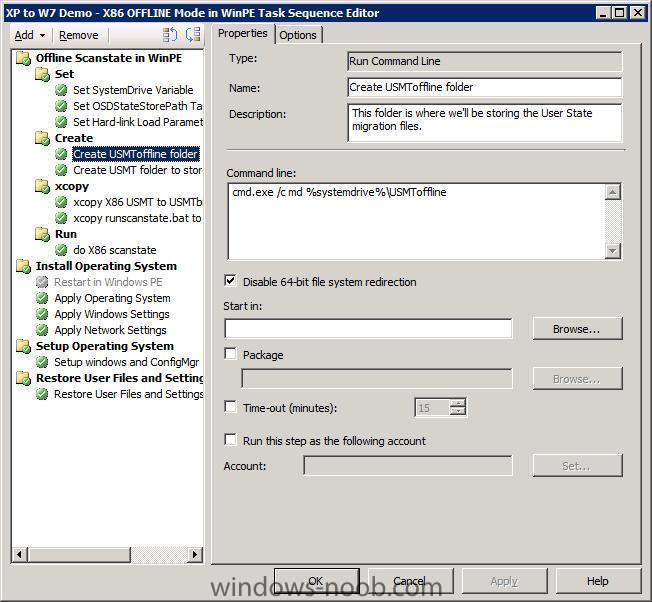

CREATE

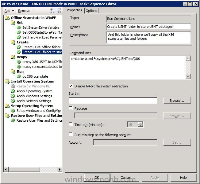

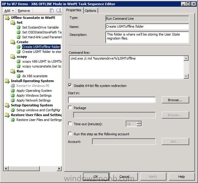

In the Create group we just create two folders, c:\USMToffline,

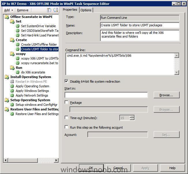

and c:\USMTbits\X86
the c:\USMTbits\X86 will store all our scanstate native files.

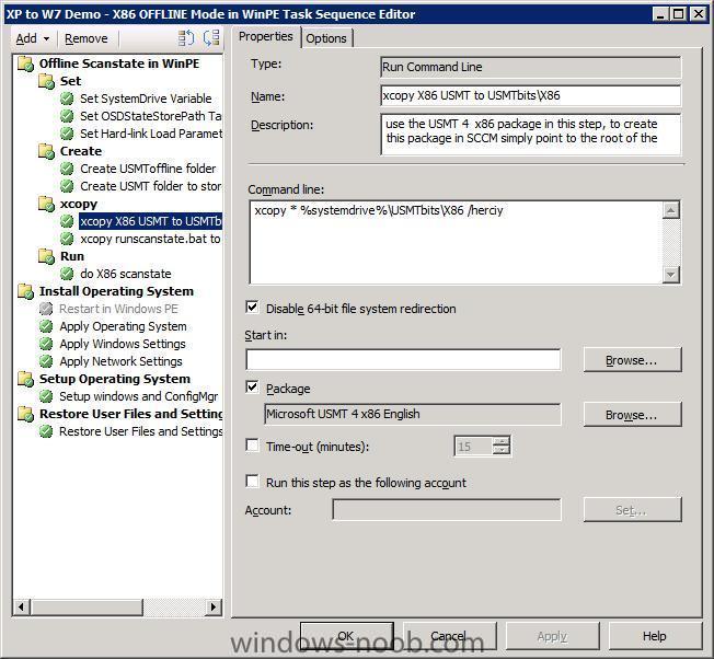

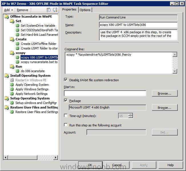

XCOPY

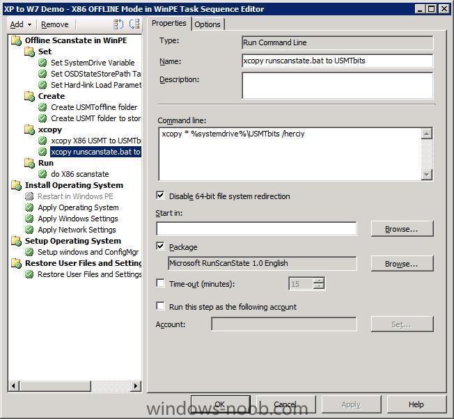

In the xcopy group we do the clever stuff, we copy the X86 USMT stuff to the newly created folder, and then we copy our batch file for later user.
The batch file itself has the following contents
@set USMT_WORKING_DIR=%~2%\USMTbits\x86
"%~2\USMTbits\x86\scanstate.exe" "%~1" /c /o /hardlink /efs:hardlink /nocompress /offlinewindir:c:\windows /v:5 /l:%~2\windows\TEMP\SMSTSLog\scanstate.log /progress:%~2\windows\TEMP\SMSTSLog\scanstateprogress.log /i:%~2\USMTbits\x86\miguser.xml /i:%~2\USMTbits\x86\migapp.xml
You can download the batchfile below however you must rename it back to .bat
runscanstate-offlinewindir.bat.txt

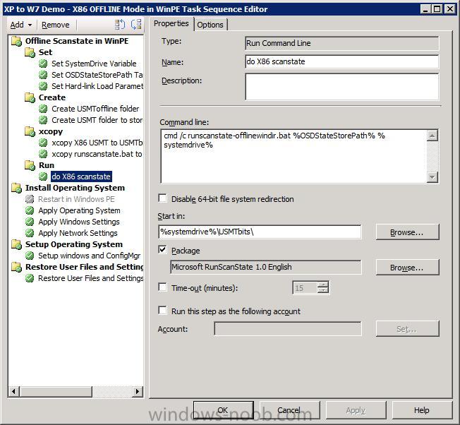

The Run group does the actual running of the batch file and passes two variables to the file.

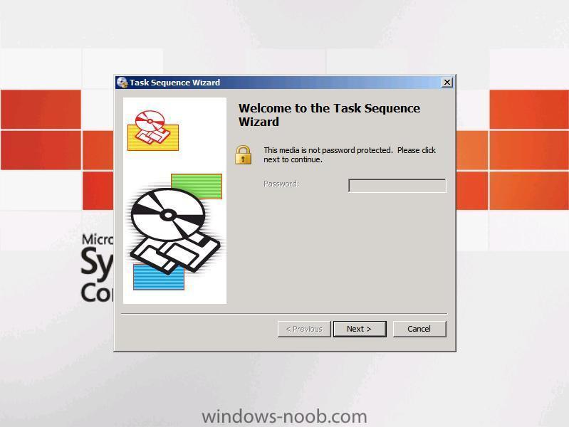

Create an optional advertisement to a Migrate XP to W7 X86 collection for the Task Sequence and PXE boot your XP client (press F12 first....), select the Task Sequence when the wizard appears,

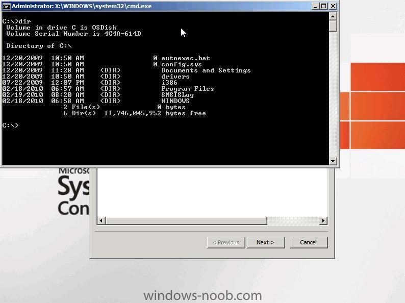

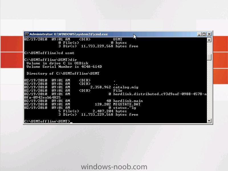

at this point press F8 to bring up the command prompt, you are doing this to verify that your data is getting migrated in OFFLINE mode. So here we can see the command prompt is open.

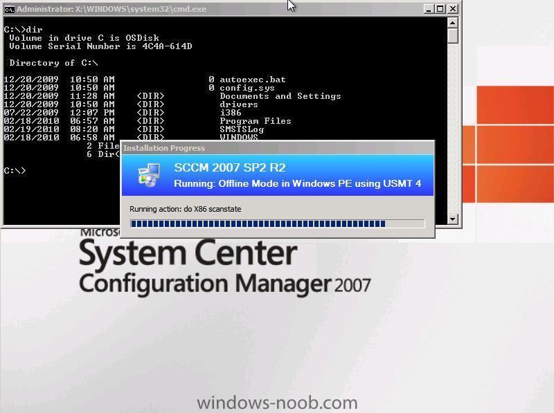

Ok switch back to the TS and start the task sequence. You will see it starts creating the folders, copying the USMT stuff and our batch file(s) and then actually running the scanstate command.
Once it is completed your migrated data will now be stored in C:\USMToffline\USMT
browse it and verify
