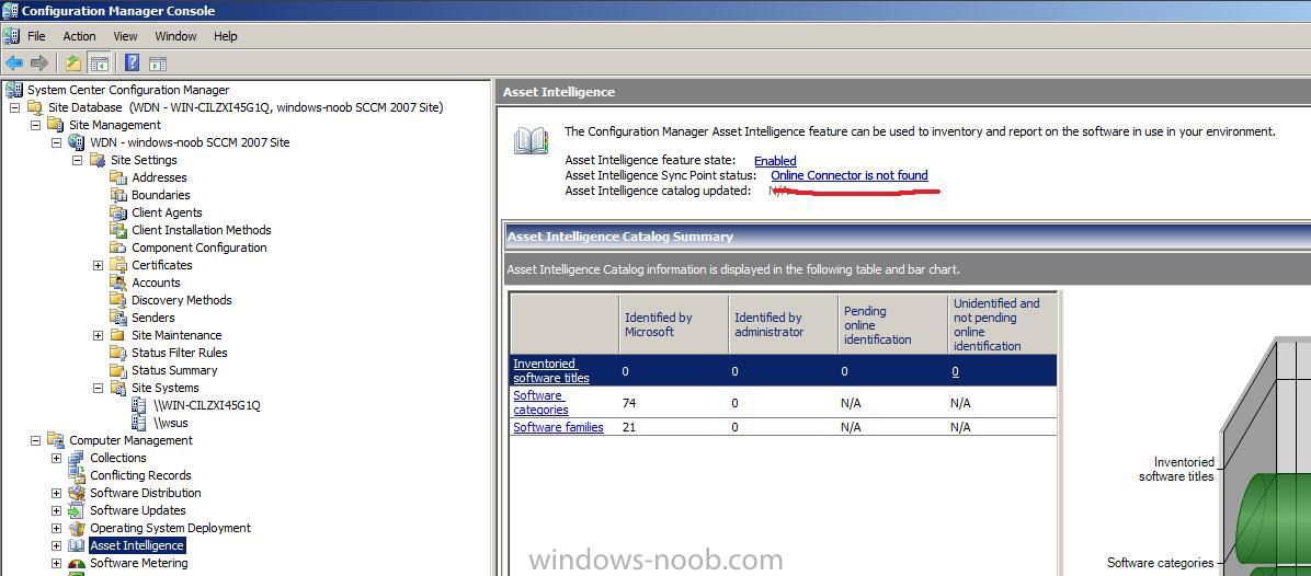

Before we start, we can see that the Online Connector is Not Found.
So let's fix that.

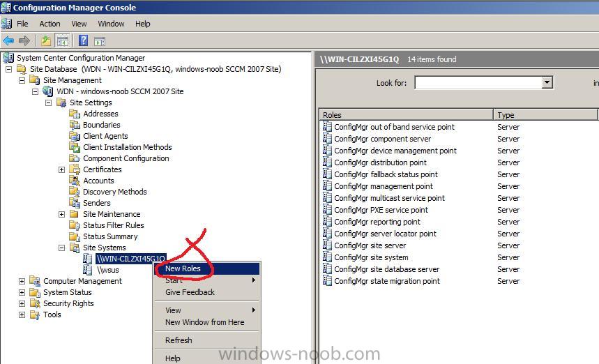

Adding the Asset Intelligence Role

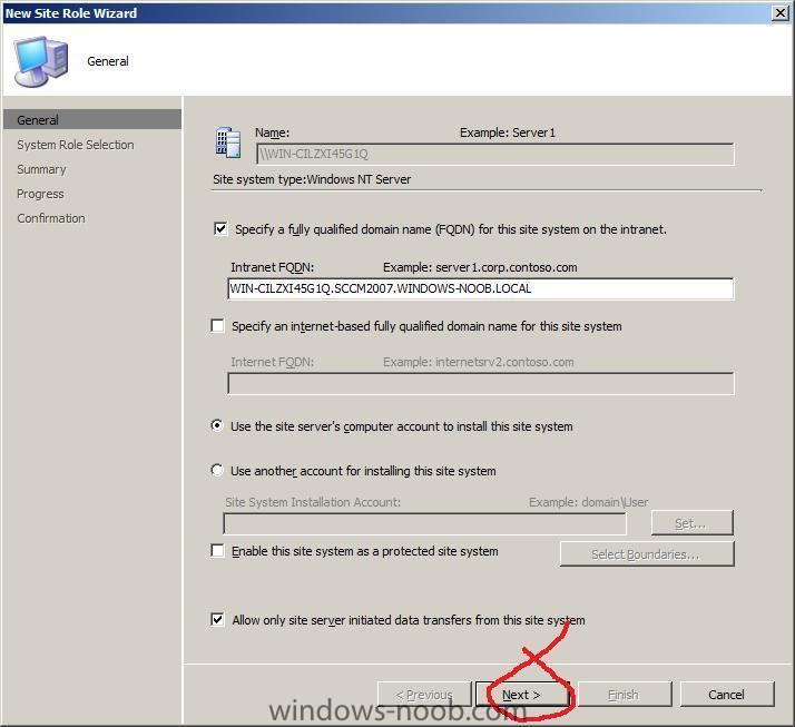

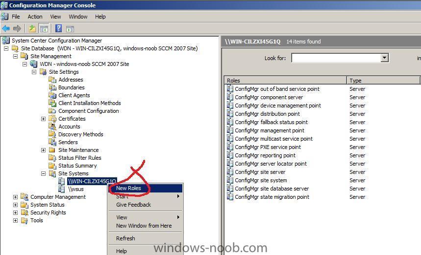

In Configuration Manager, expand Site Systems, locate your site server, expand it right click and choose New Roles

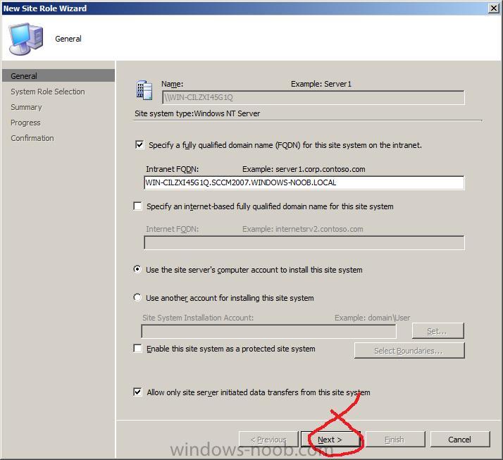

When the New Site Role Wizard appears, click Next

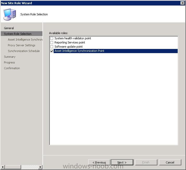

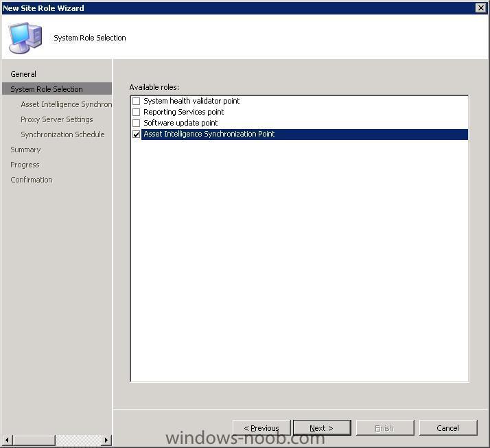

Select the Asset Intelligence Synchronization Point role and click next

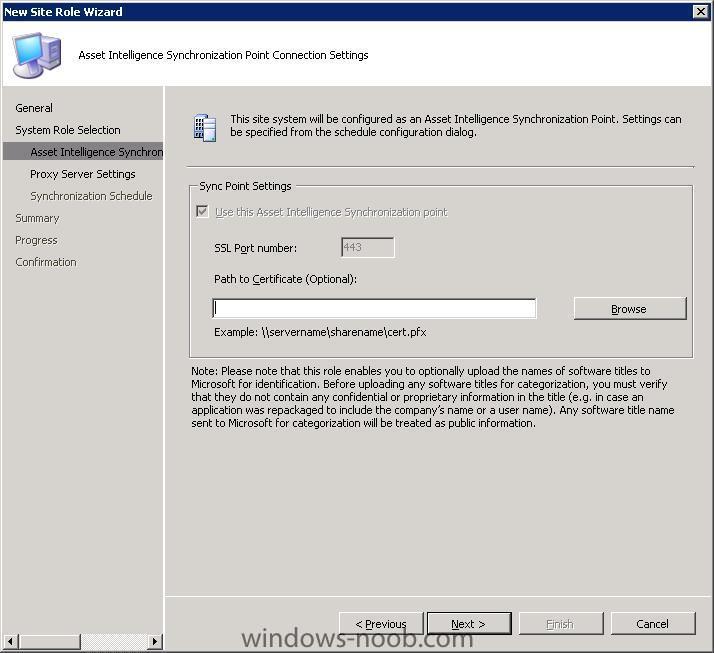

When the Asset Intelligence Synchronisation Point connection settings window appears, browse to the path of your Certificate if using SCCM 2007 Sp1.
Note: This step is not necessary for Configuration Manager 2007 SP2 sites because the connection certificate is automatically provisioned during site role installation.
Click Next to continue.

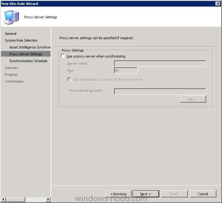

enter your proxy settings

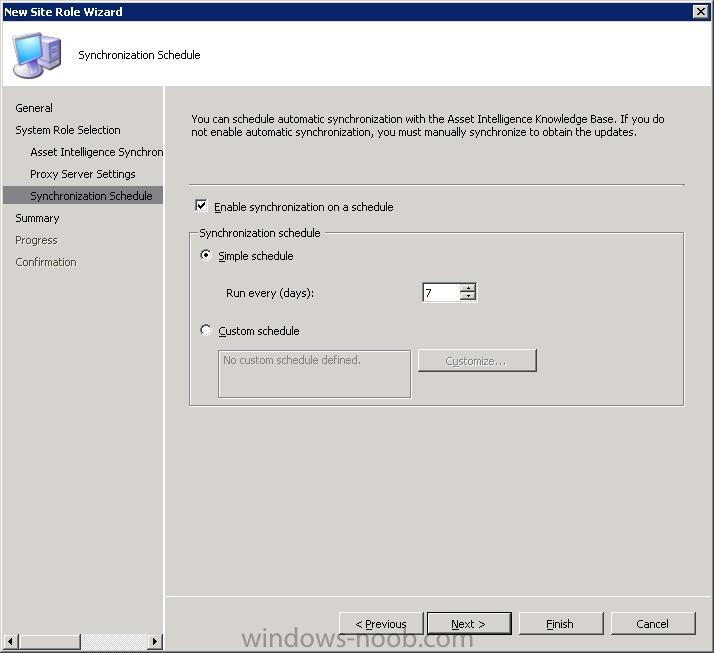

set your Synchronization schedule settings

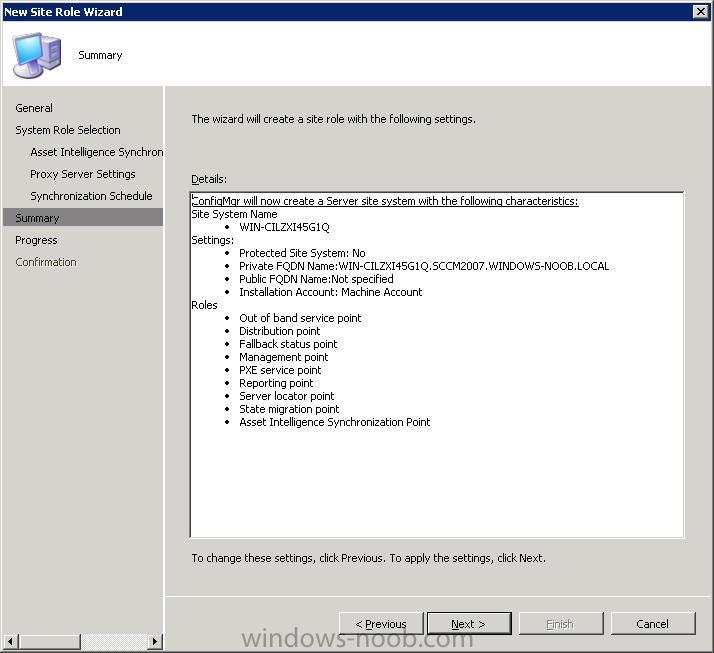

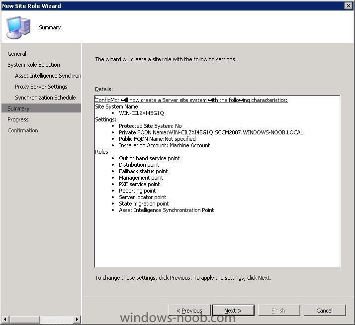

Review the summary

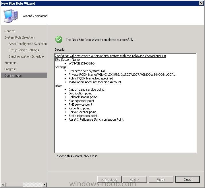

and the confirmation...
Now that we are done, go back into the Asset Intelligence node and refresh (F5), you should see the Sync Point is Deployed.

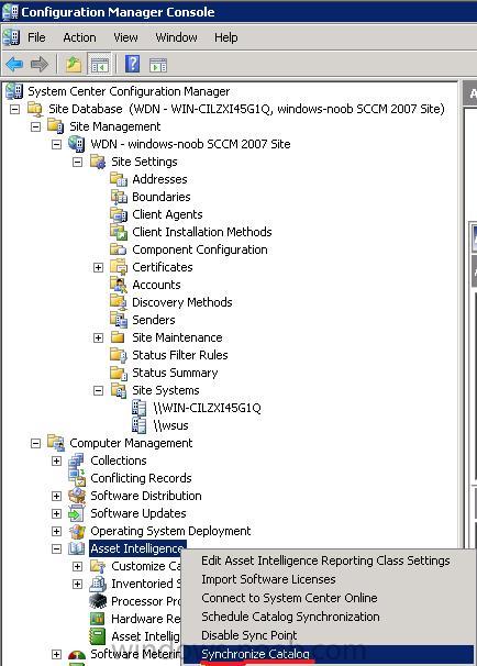

Starting a Manual Sync
To initiate a manual Syncrhonisation, right click on Asset Intelligence and select Synchronize Catalog

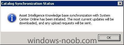

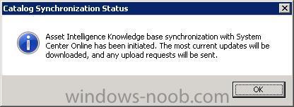

review the Sync initiated message
Note: you can only do one sync in any 12 hour period, if you try again it will pop up a message telling you this.

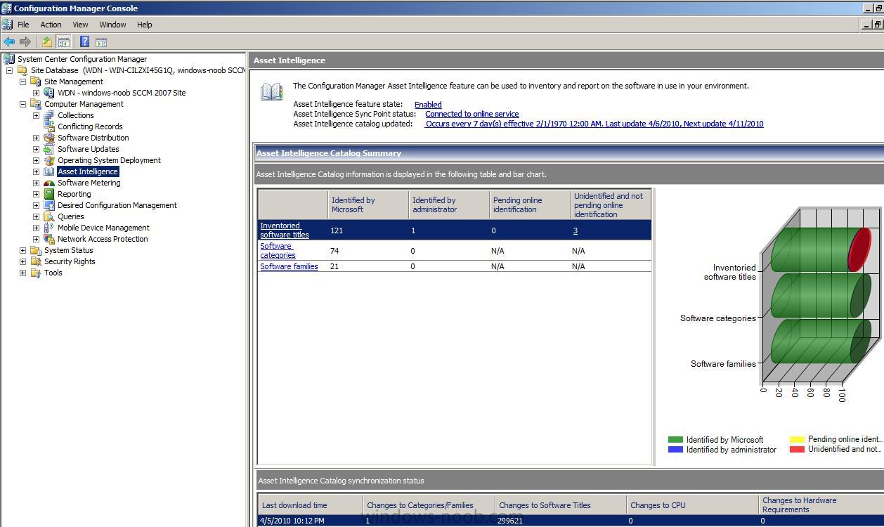

Connected to Online Service

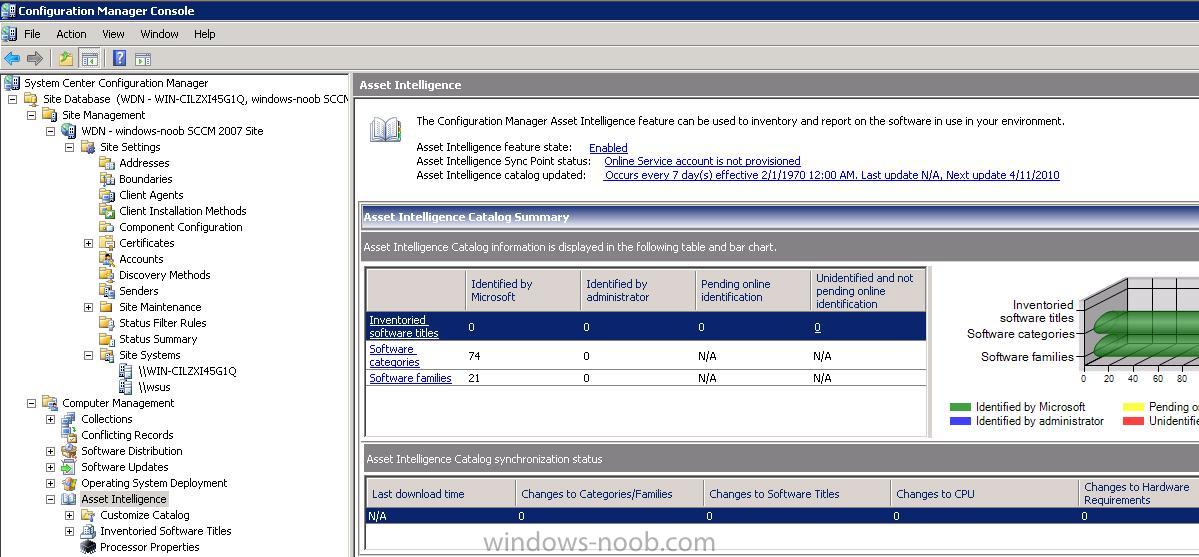

Once the sync has taken place the Asset Intelligence Sync Status should be listed as Connected to Online Service
If it is not, for example if it states that the online service account is not provisioned [see below screenshot], you could try changing the sync schedule to every 1 days until the sync has taken place, then change it back to the default of every 7 days once it is listed as Connected to Online Service.
If it's still failing verify your connection settings (proxy) and review the AIupdatesvc logs and see if the following Hotfix is applicable to you.
