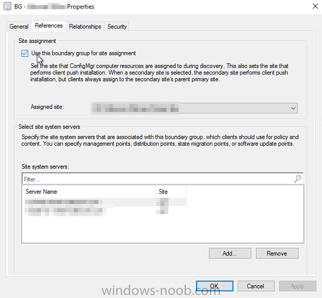

And yes, this is now resolved.
On the Boundary Group, I had only added the local DP (which carries the SMP role as well) and lives in the same subnet.
I hadn't added the main Site System which is over WAN and is holding the Primary Site server role and the MP.
I don't know if this is the proper way to set this up, but this has now solved the problem.

I found the following that happens on 1610 and seems like a bug which Microsoft acknowledged.
https://social.technet.microsoft.com/Forums/en-US/7bfdd65e-d81f-447c-a132-3df9f2b296c7/client-fails-to-request-user-state-store-no-local-smp-found?forum=configmanagerosd
Removing the Failback boundary group from the Boundary, solves the problem.
Just tested it and verified that this bug is still there.
Alex

I was having the same issue on ConfigMgr 1902. Removing the failback fixed my problem.
I tried just about everything and nothing worked for me.
I realized i changed some boundaries and fixed the environment I was working on, then it dawned on me, let me reinstall the SMP role.
When I did, everything starting working again.
