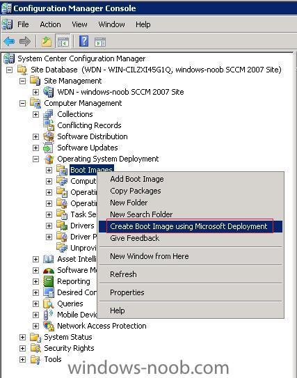

Create boot image using Microsoft Deployment
Expand the OSD section of ConfigMGr and right click on boot images, choose Create Boot Image using Microsoft Deployment

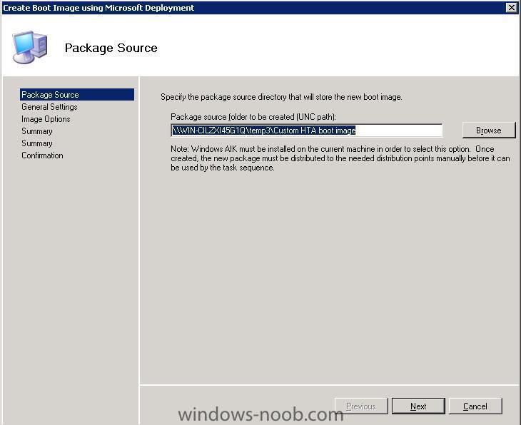

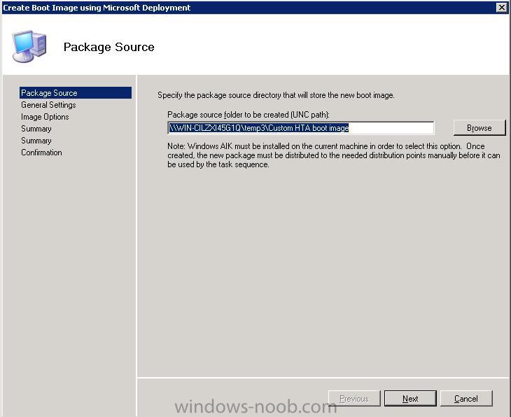

Enter the UNC path and make sure the folder you point to is Empty otherwise the wizard will fail

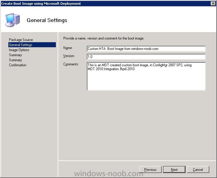

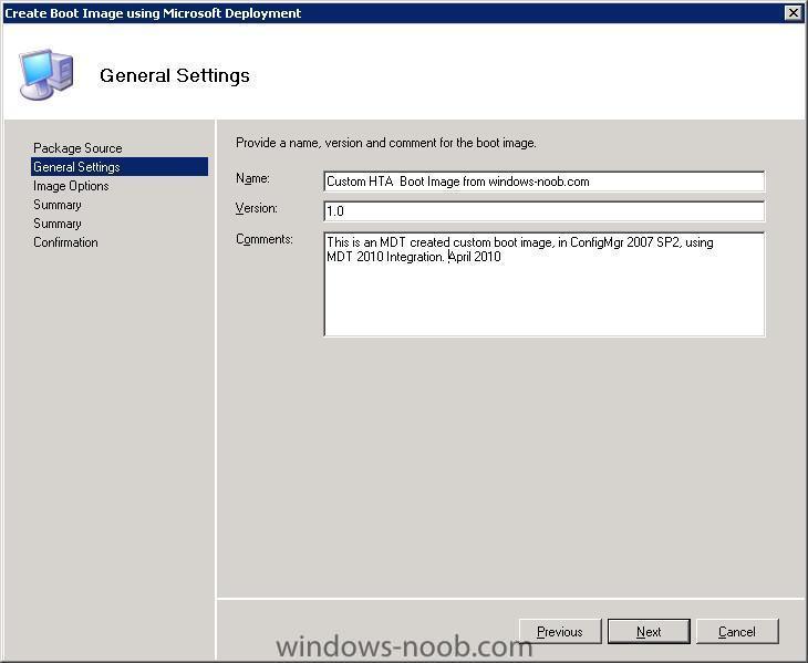

fill in the General Settings

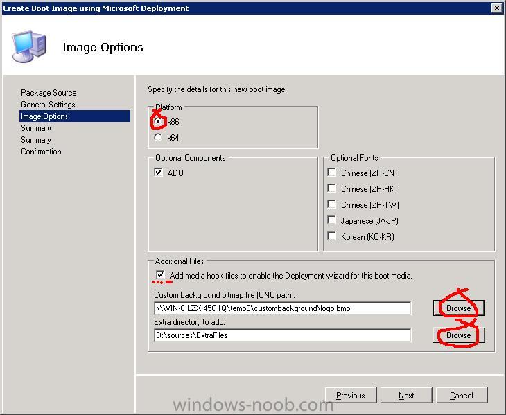

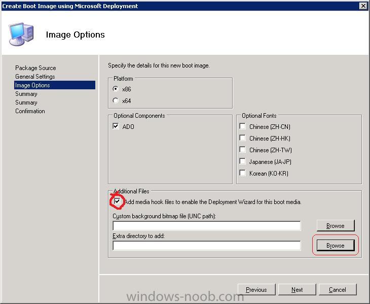

for Image options select Add Media hook files to enable deployment Wizard for this boot media
in the Extrafiles field point to your ExtraFiles folder, in mine I have copied Trace32.exe and also point to the UNC path to your custom background

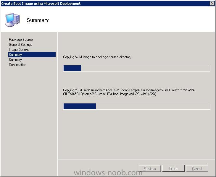

review the summary and click Next
this takes some time so be patient

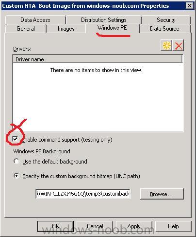

Enable Command Support (F8)
Once done, enable command support by right clicking on your new Boot.wim file in boot images, select the Windows PE tab

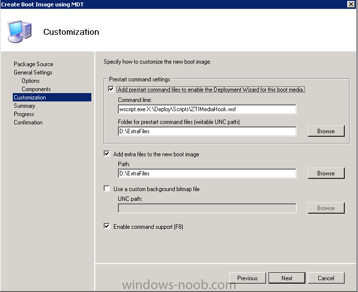

Thanks for this article. My screenshots look a bit different - I am running SCCM 2007 with MDT 2012. On the Customization page, I am not sure what to fill in for the "Prestart command settings" section (especially the "Folder for prestart command files" line) - please see attached screenshot.
Any help would be greatly appreciated.
look at what's in the ztimediahook.wsf file, is it referencing anything ? if not then dont worry about it
secondy the prestart files need to be a writable UNC path
eg; \\someserver\someshare
