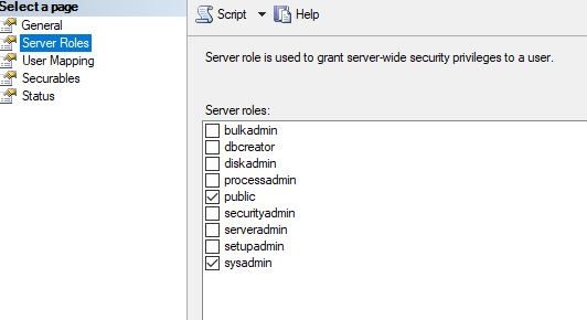

edie209 Posted December 16, 2019 Report post Posted December 16, 2019 Thanks for that I have just gone into sql management studio and this is the permissions my account has Quote Share this post Link to post Share on other sites More sharing options...
anyweb Posted December 16, 2019 Report post Posted December 16, 2019 what account was used before with the database mentioned ? Quote Cannot open database "cd_ste" requested by the login. The login failed. Quote Share this post Link to post Share on other sites More sharing options...
edie209 Posted December 16, 2019 Report post Posted December 16, 2019 I have two accounts on SQL my admin account and a SCCM Admin account that was the account used, yet on the recovery it seems to use my admin account possibly because I am logged in as a domain admin not the sccm admin? Should I be logged in as the sccm admin to recover the site? Quote Share this post Link to post Share on other sites More sharing options...
