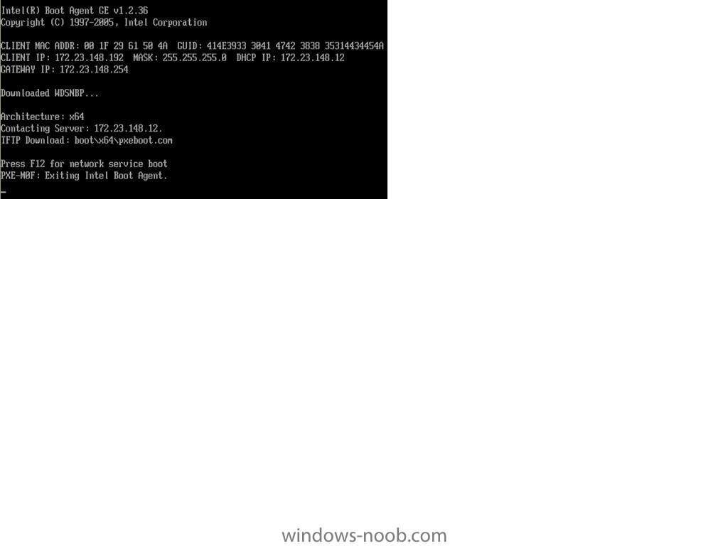

SBabicki Posted May 6, 2010 Report post Posted May 6, 2010 I seem to be having a PXE OR WDS ISSUE. INFO 2 enviorments PROD 27 servers it has it's own SCCM server PREPROD 19 servers it has it's own SCCM server the last time a server had to PXE from either SCCM server was over a year ago. I have inspected both servers side by side all looks the same. I have recently had to pxe a server to reimage it and i get nowhere please see the screenshot. it scrolls through all nics with the same result. any help is greatly appriciated. Thanks Sean Quote Share this post Link to post Share on other sites More sharing options...
0 anyweb Posted May 6, 2010 Report post Posted May 6, 2010 what you are seeing is a 'normal' Optional PXE boot menu, if you press F12 (as you see at the bottom of the screen) when it appears, do you then see Windows PE loading and a task sequence (or task sequences menu) kick off ? Quote Share this post Link to post Share on other sites More sharing options...
0 SBabicki Posted May 6, 2010 Report post Posted May 6, 2010 On 5/6/2010 at 6:39 PM, anyweb said: what you are seeing is a 'normal' Optional PXE boot menu, if you press F12 (as you see at the bottom of the screen) when it appears, do you then see Windows PE loading and a task sequence (or task sequences menu) kick off ? This is actually whet i see there. Quote Share this post Link to post Share on other sites More sharing options...
