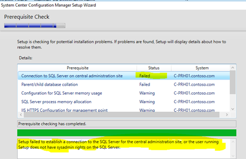

SCCM Adding Primary Site Error Connection to Central Site SQL Database
SCCM setup failed to establish a connection to the SQL Server for the Central Administration Site ...

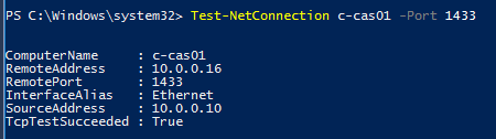

On the Primary Server :  Test Test-NetConnection C-CAS01.contoso.com -port 1433
On the Central Site Server: Netstat -a | find /I “1433”
Result is good, that mean it is not SQL problem,

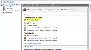

Check if  proxy or FW blockage:
Go to Windows Firewall and turn it off:
Test again  :

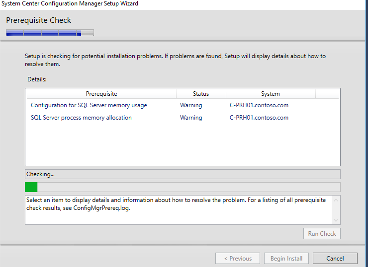

Now SCCM Setup should be good again!
