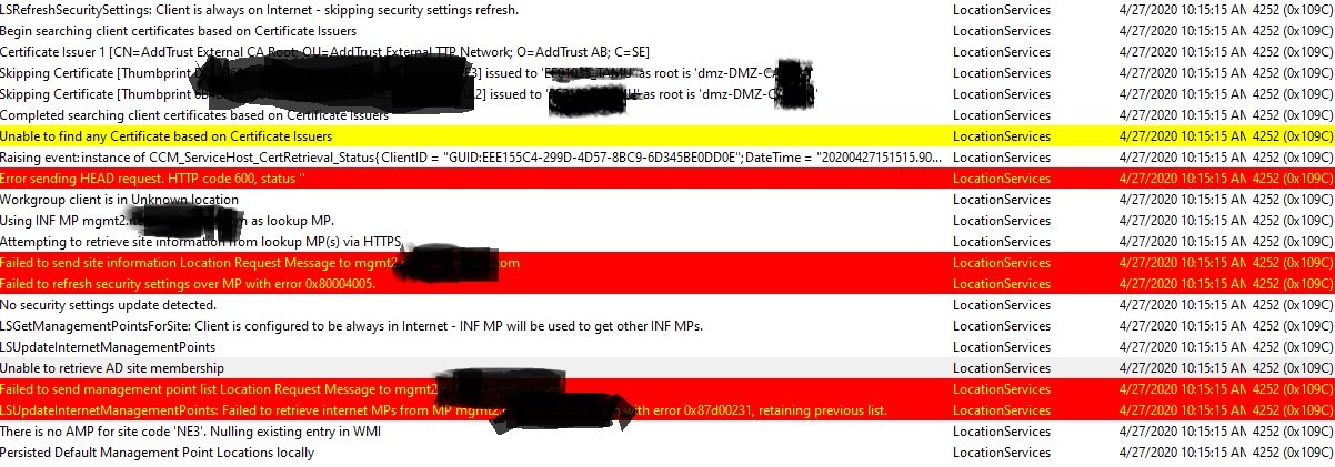

Location services log shows this

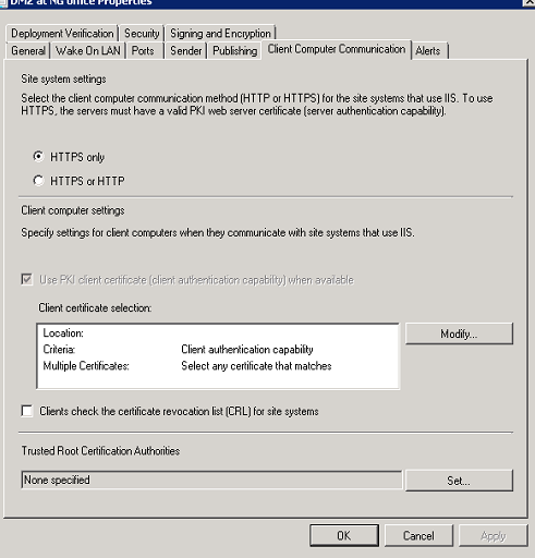

Settings in client computer communications tab are set as this:
However, none of these settings were touched, only the certificate updated.     All clients were communicating properly before we updated the certificate.  When visiting the management site directly from a client, it shows the updated cert on the management point Site as being the updated one, and all intermediate certificates are shown and have the status of OK.

So I think we have made some progress on this....we removed the AddTrustCA Root cert from the server (which appears to be what the issue is; client is seeing that cert and skipping the correct one (Thumbprint XXX  cert showing screenshot).  On a handful of working machines, they have gone back to validating the correct cert (one with Thumbprint) and they are communicating again.  However, Most all other clients are still using the AddTrustCA one, even though it's been removed from the server.
How can we force clients to 'recheck' for the cert to use?   We've tried rebooting the systems to no avail.  Is there a way to force this?

This is a unique situation...these are all workgroup systems out in the field and were imaged with their personal store-specific certificate when they were first built.  We would update these certs using SCCM when they approached their expiration date using package deployments.  However now we're in a "chicken or the egg" situation since these clients are pulling the wrong cert (AddTrustCA) instead of the cert in the personal store to authenticate with.      Since yesterday, we've determined that if we remote into an individual system and clear out the HKLM:\SOFTWARE\Microsoft\CCM\Security\Certificate Issuers key (which on broke systems shows the AddTrustCA) to be blank, they systems immediate fall back to using their personal store cert and they all start communicating properly again.
However we have a large number of these systems that are not communicating back properly to get this change from the MP.  I'm assuming because they can't authenticate...however what's weird is that a handful of them (20 or so) did succesfully connect back in and get the update to the trusted root authorities change we made (back to none specified).
I think our issues started when we incorrectly changed that field in Client computer Communication tab to point to the root CA.   They all pulled that setting, and now they can't communicate. Switching it back isn't working for all the systems.
