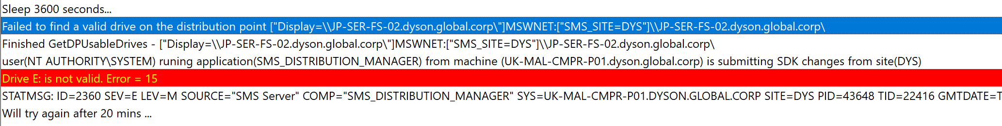

anyweb Posted May 3, 2020 Report post Posted May 3, 2020 did you look at your logs ? there are some errors in there, i've highlighted one for you 1 Quote Share this post Link to post Share on other sites More sharing options...

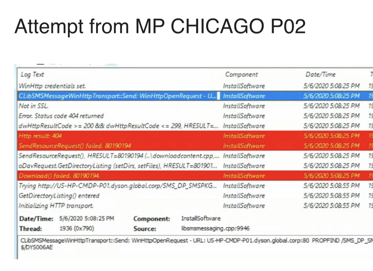

SHASHIDUBEY01 Posted May 6, 2020 Report post Posted May 6, 2020 Dear Sir, this is a newly set up distribution for locally for speeding up the production machine reimage process which is used to reimage the device using PXE and this DP is set up to provide the content to all the machine of this boundary to avoid latency or network bandwidth consumption. And yes we have not been able to get this DP working right from the moment we have got it online. We haven't tried to reinstall the role cause some of the small packages gets distributed but most of them and specially the one with the bigger size aren/t able to get distributed at all. I mean "reimagine the device" as this distribution point that was designed to provide the content to the device of designed boundary at the time of network boot using PXE which we have been failing to do for days. overtime we try to reimage this device using PXE with the Help of this boundary group assigned DP we get the error as attach in the screenshot.and it doesn't even happen with only this package but other packages too. Hope to get the reason for this error message and how to overcome it. Thanking in advance. Regards, Shashi Dubey Quote Share this post Link to post Share on other sites More sharing options...
