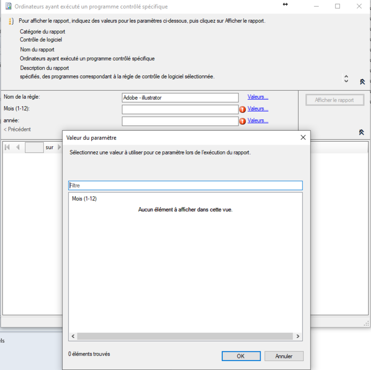

Bonjour,
J'ai un petit problème quand je veut afficher un rapport de logiciel . Il m'est impossible de sélectionnez le mois et l’année affin de générer le rapport :
Version english
Hello, I have a little problem when I want to view a software report. I am unable to select the month and year in order to generate the report:
I looked, and in that log I didn't find anything that looked like "illustrator" ; but then again, maybe I don't know what to look for.
For example, that log has a line like this:
<![LOG[Process ID 17748 is for process C:\Program Files\Microsoft Office\Office16\EXCEL.EXE]LOG]!><time="14:54:55.862-120"
<![LOG[No matching rule found for process 17748]LOG]!><time="14:54:55.862-120" date="06-03-2020"
So that shows that Excel launched...but there is no rule for Excel.exe
Since your example indicates it's for Illustrator, do you have a box with Illustrator, which you KNOW has run Illustrator, then read the mtrmgr.log on that box; looking for a matching rule.  (and yes, you're going to have to teach yourself how to read log files, I know it's not the most glamorous job in the world; but everything you ever wanted to know and more about CM is in the logs...)
