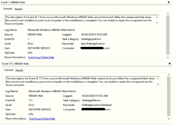

yes, i've seen your guide.  and i don't what i missed in the configuration. this is my first implementation of bitlocker management. I also check the event viewer when i access the portals
Event ID 1
The description for Event ID 1 from source Microsoft-Windows-MBAM-Web cannot be found. Either the component that raises this event is not installed on your local computer or the installation is corrupted. You can install or repair the component on the local computer.
 If the event originated on another computer, the display information had to be saved with the event.
 The following information was included with the event:
 Application: Default Web Site/HelpDesk is missing the following Service Principal Names (SPNs):
http/
 Register the required SPNs on the account: CHSV001012019$.
 The publisher has been disabled and its resource is not available. This usually occurs when the publisher is in the process of being uninstalled or upgraded
Event ID 111
The description for Event ID 111 from source Microsoft-Windows-MBAM-Web cannot be found. Either the component that raises this event is not installed on your local computer or the installation is corrupted. You can install or repair the component on the local computer.
An error occurred while retrieving the database schema version from the Compliance database.
Could not find stored procedure 'ComplianceCore.GetVersion'.

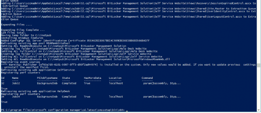

well it's hard to make out from your screenshot but it appears you had errors installing the portals, what cmdline did you use to install them ?
I re-run the script. with this (changed to generic.)
.\MBAMWebSiteInstaller.ps1 -SqlServerName sservername -SqlDatabaseName CM_abc -ReportWebServiceUrl http://server/ReportServer -HelpdeskUsersGroupName "abc\BitLocker HelpDesk Admins" -HelpdeskAdminsGroupName "abc\BitLocker Admin Users" -MbamReportUsersGroupName "abc\BitLocker Reporting Users" -SiteInstall Both
I got no error on the powershell, then I tried to access the site again, but kept on asking for credentials.
then there's this error on the event viewer
http/

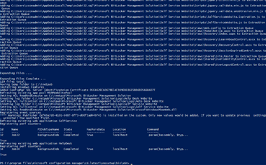

ok still very hard to see the output from your powershell but if there's no errors then that's better, what type of environment do you have, is it a  single primary with the helpdesks installed on the same server or something more complex, please explain... can you do a remote session so i can take a look  (teamviewer ?)
using 2 servers , sccm server and database server
It would be nice if you can check via remote session, but actually this is a client environment so I don't have access to other servers except for sccm and DB server
This is the result in PowerShell
