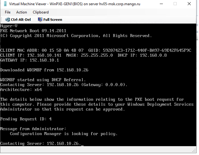

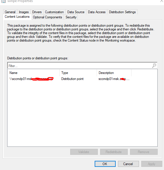

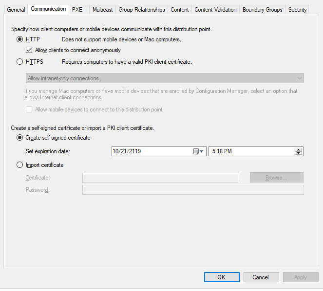

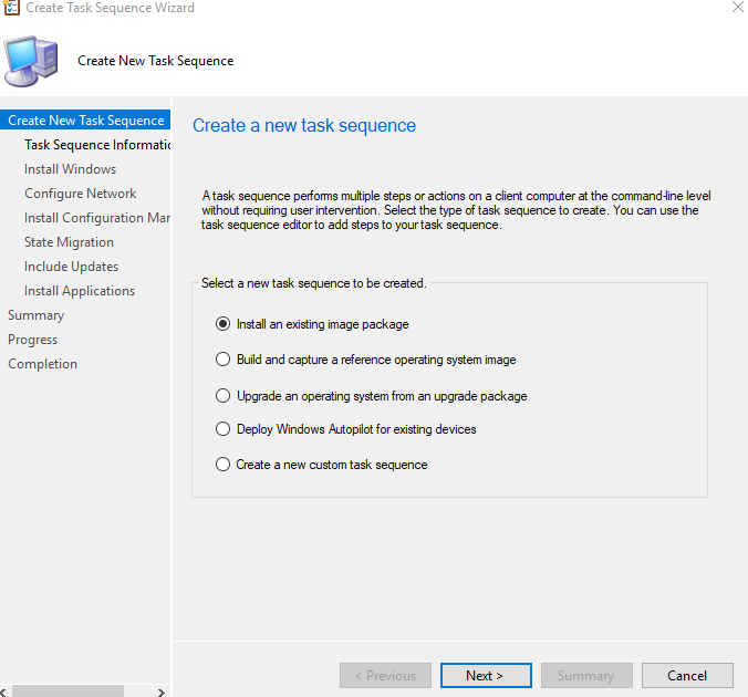

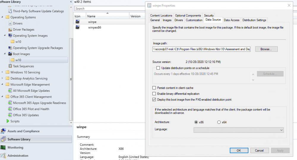

Hello. two weeks i can't beat the problem of loading MDT via MECM.
My configure in screenshot:
for two weeks now i can't get this to work. After receiving the message that you see in the VM picture.
Log from SMSPXE.log.

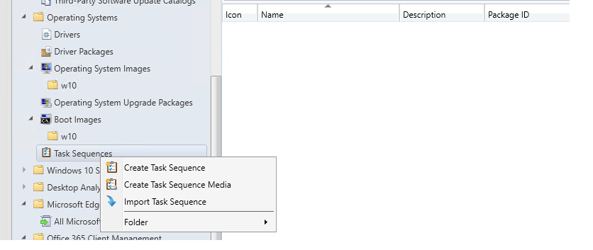

according to this manual:
I do not have an MDT task creation (Step 7.)
WDS and MDT are located on the same server as mecm. I have a basic configuration. those. just installation and that's it.
============> Received from client:   SMSPXE               10/28/2020 1:09:34 PM               19264 (0x4B40)
Operation: BootRequest (1)  Addr type: 1 Addr Len: 6 Hop Count: 0 ID: 074B0A5E
Sec Since Boot: 65535 Client IP: 192.168.010.141 Your IP: 000.000.000.000 Server IP: 000.000.000.000 Relay Agent IP: 000.000.000.000
Addr: 00:15:5d:0a:4b:07:
Magic Cookie: 63538263
Options:
  Type=53 Msg Type: 3=Request
  Type=60 ClassId: PXEClient
  Type=97 UUID: 002374205912170f44ba9769e42f645f9c
  Type=93 Client Arch: Intel x86PC
  Type=55 Param Request List: 03013c8081828384858687            SMSPXE               10/28/2020 1:09:34 PM               19264 (0x4B40)
Prioritizing local MP http://sccmdp01-msk.corp.corp.ru. SMSPXE               10/28/2020 1:09:34 PM               20964 (0x51E4)
Not in SSL.          SMSPXE               10/28/2020 1:09:34 PM               20964 (0x51E4)
Client lookup reply: <ClientIDReply><Identification Unknown="0" DuplicateSMBIOS="0" DuplicateMACAddress="0" ItemKey="0" ServerName=""><Machine><ClientID/><NetbiosName/></Machine></Identification></ClientIDReply>
00:15:5D:0A:4B:07, 59207423-1712-440F-BA97-69E42F645F9C: Device is not in the database.  SMSPXE                10/28/2020 1:09:34 PM               20964 (0x51E4)
============> REQUEST Reply to client ([192.168.010.141:68]) Len:348             SMSPXE               10/28/2020 1:09:34 PM         20964 (0x51E4)
Operation: BootReply (2)  Addr type: 1 Addr Len: 6 Hop Count: 0 ID: 074B0A5E
Sec Since Boot: 65535 Client IP: 192.168.010.141 Your IP: 000.000.000.000 Server IP: 192.168.010.026 Relay Agent IP: 000.000.000.000
BootFile: smsboot\x86\wdsnbp.com
Options:
  Type=53 Msg Type: 5=Ask
  Type=54 Svr id: 192.168.010.026
  Type=250 02010105040000000503020014040200ba062c436f6e66696775726174696f6e204d616e61676572206973206c6f6f6b696e6720666f7220706f6c6963792e0b0101                SMSPXE               10/28/2020 1:09:34 PM               20964 (0x51E4)
<============ REQUEST Reply (end)   SMSPXE               10/28/2020 1:09:34 PM               20964 (0x51E4)
Sec Since Boot: 0 Client IP: 192.168.010.141 Your IP: 000.000.000.000 Server IP: 000.000.000.000 Relay Agent IP: 000.000.000.000
Options:
  Type=250 0d0208000e010101020006050400000005ff
Getting boot action for unknown machine: item key: 2046820353             SMSPXE               10/28/2020 1:09:34 PM                20964 (0x51E4)
Request using architecture 9.     SMSPXE               10/28/2020 1:09:34 PM               20964 (0x51E4)
Client boot action reply: <ClientIDReply><Identification Unknown="0" DuplicateSMBIOS="0" DuplicateMACAddress="0" ItemKey="2046820353" ServerName=""><Machine><ClientID/><NetbiosName/></Machine></Identification><PXEBootAction LastPXEAdvertisementID="" LastPXEAdvertisementTime="" OfferID="" OfferIDTime="" PkgID="" PackageVersion="" PackagePath="" BootImageID="" Mandatory=""/></ClientIDReply>
Request retry.  SMSPXE               10/28/2020 1:09:34 PM               20964 (0x51E4)
00:15:5D:0A:4B:07, 59207423-1712-440F-BA97-69E42F645F9C: no advertisements found          SMSPXE                10/28/2020 1:09:34 PM               20964 (0x51E4)
============> REQUEST Reply to client ([192.168.010.141:68]) Len:280             SMSPXE               10/28/2020 1:09:34 PM         20964 (0x51E4)
Sec Since Boot: 0 Client IP: 192.168.010.141 Your IP: 000.000.000.000 Server IP: 192.168.010.026 Relay Agent IP: 000.000.000.000
BootFile: smsboot\x64\abortpxe.com
Options:
  Type=60 ClassId: PXEClient       SMSPXE               10/28/2020 1:09:34 PM               20964 (0x51E4)

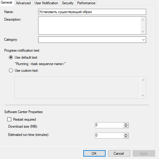

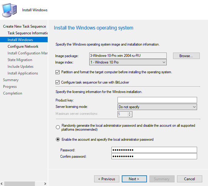

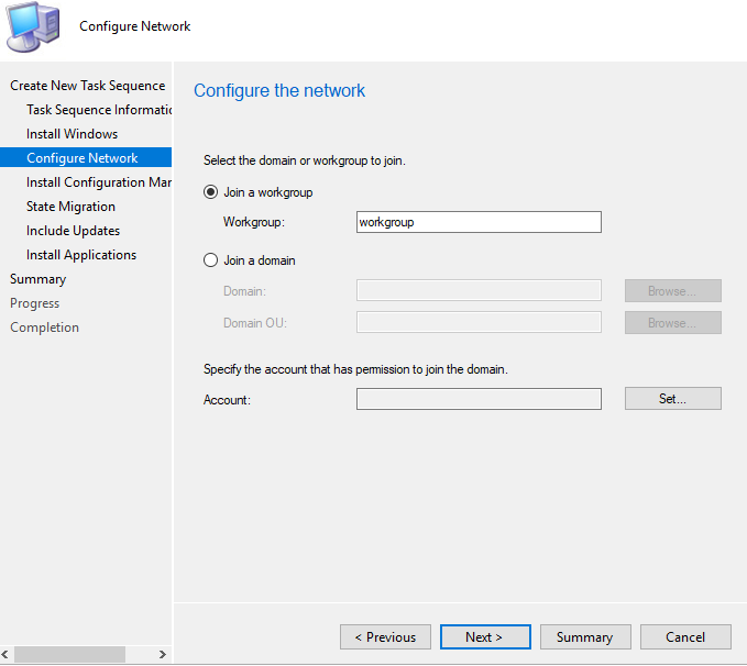

if you're talking about "Task Sequence", then I don't have paragraph "Create MDT Task Sequence". look at the penultimate picture. so I didn't create any tasks.
I have a separate MDT server, it works. OS can be installed.

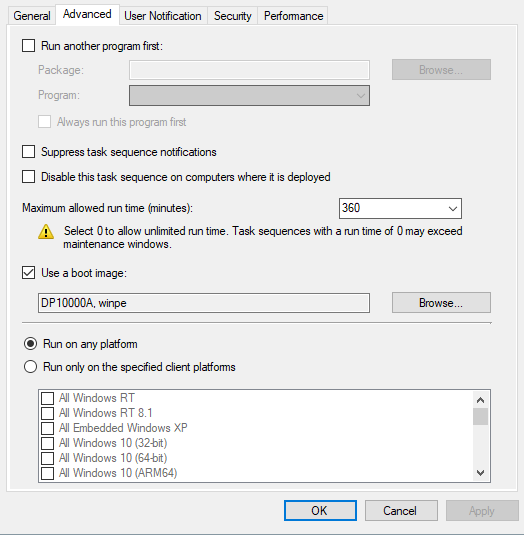

I created an unusual image installation task
the result is unfortunately the same. - like the last picture in the last post

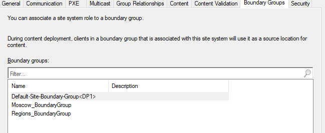

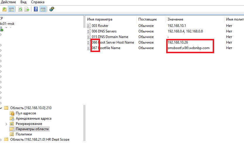

it's only necessary to deploy to the Unknown computers collection if those are your target, for example, in a New Computer type of scenario, if however you want to deploy to existing (known) computers then you can do so to via whatever collections they are members of.
