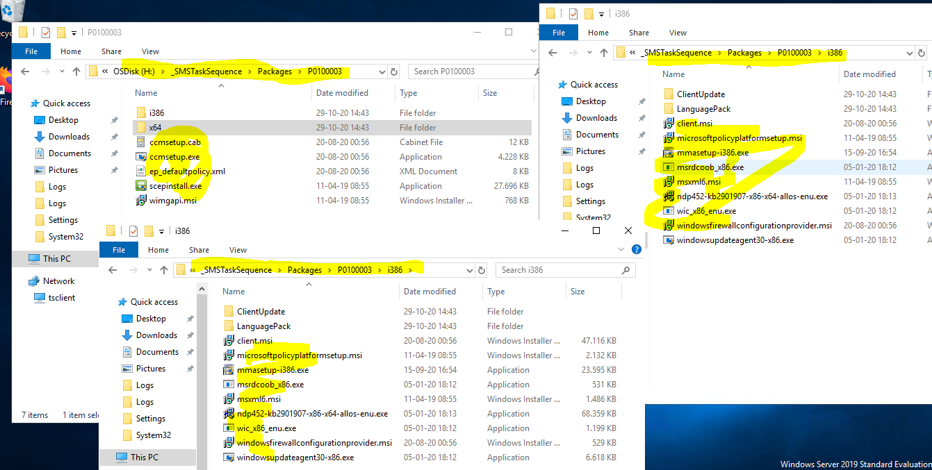

Can you please help solving the following problem:
In a lab I'm testing the last Sccm CB server, following your procedures, during an OSD TS to install the last W10 version the sccm client agent wont install, in the ccmsetup.log i see:
Downloading C:\_SMSTaskSequence\OSD\P0100028\i386\vcredist_x86.exe to C:\WINDOWS\ccmsetup\vcredist_x86.exe    ccmsetup    29-10-20 10:56:54    1112 (0x0458)
Failed to access source file (2). Waiting for retry...    ccmsetup    29-10-20 10:56:54    1112 (0x0458)

Hello
The dist point is updated, boundaries defined and the network account, the required package is also available locally where it should be ? the package name in the following p.s. is different because I tried with a new one but the problem is the same like you see :
