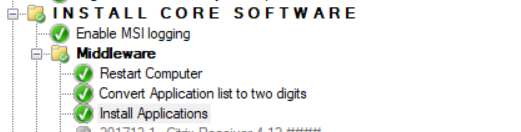

what steps are in the install software group, can you show a screenshot of the task sequence, what i can see from the log is it sets a reg key in that group and then restarts, that's about all.
ok well your smsts.log doesn't include the Install applications step at all, I think your task sequence is failing just after restarting the computer, so why are you restarting it and is it restarting to the operating system ? can you disable that step and see what happens.
OK, I disabled the Restart computer step before the convert applications.
