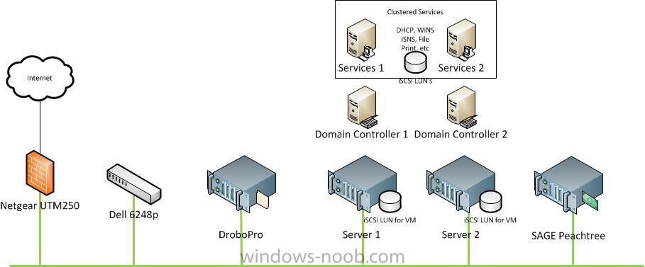

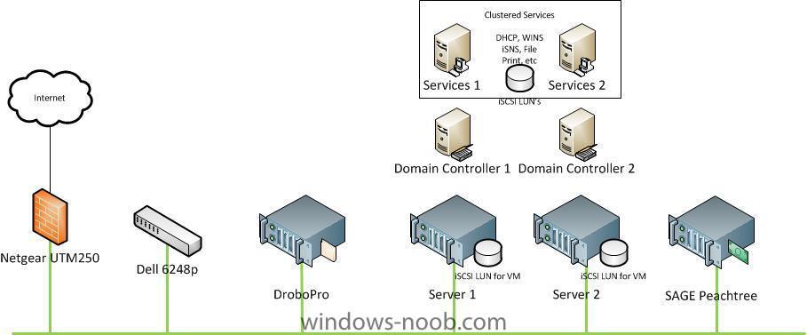

OK, so your looking to avoid any large scale business outages.
You can run 2 x DHCP services however 1 would have to be offline. I would build the system like this
