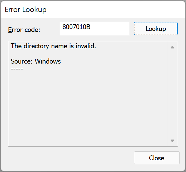

the first problem seems to be this
CreateProcessAsUser failed. Code(0x8007010B)
which translates to...
