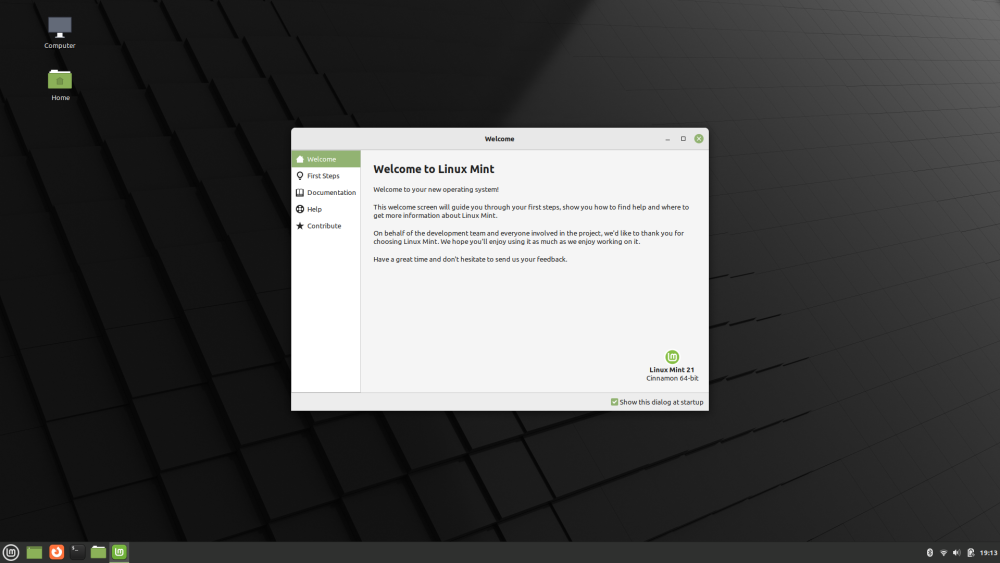

LinuxMint is based on Ubuntu, which in turn is based on Debian. I downloaded LinuxMint version 21 from here and installed it on a HP EliteBook 830 G8 via USB bootable media created using http://unetbootin.github.io/. The installation was fast and I selected to also include 3rd party codecs when prompted during installation.

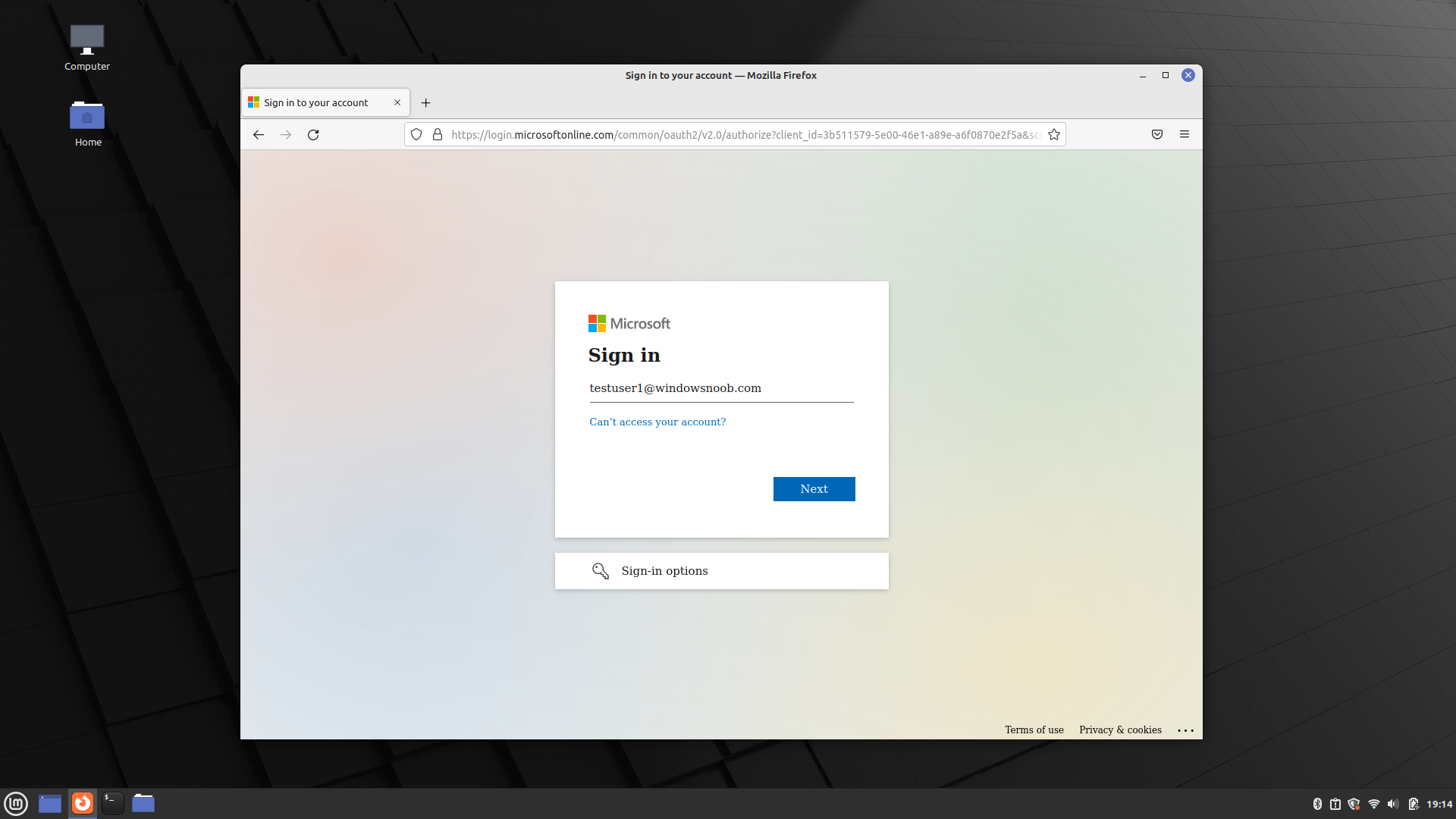

After I installed LinuxMint I updated it. That too was quick and painless. Once done, I launched Firefox and browsed to https://windows365.microsoft.com

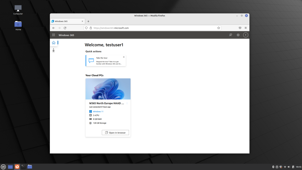

I entered my credentials, satisfied the MFA request and within a few seconds could see the normal Windows 365 welcome screen showing my available Cloud PC.

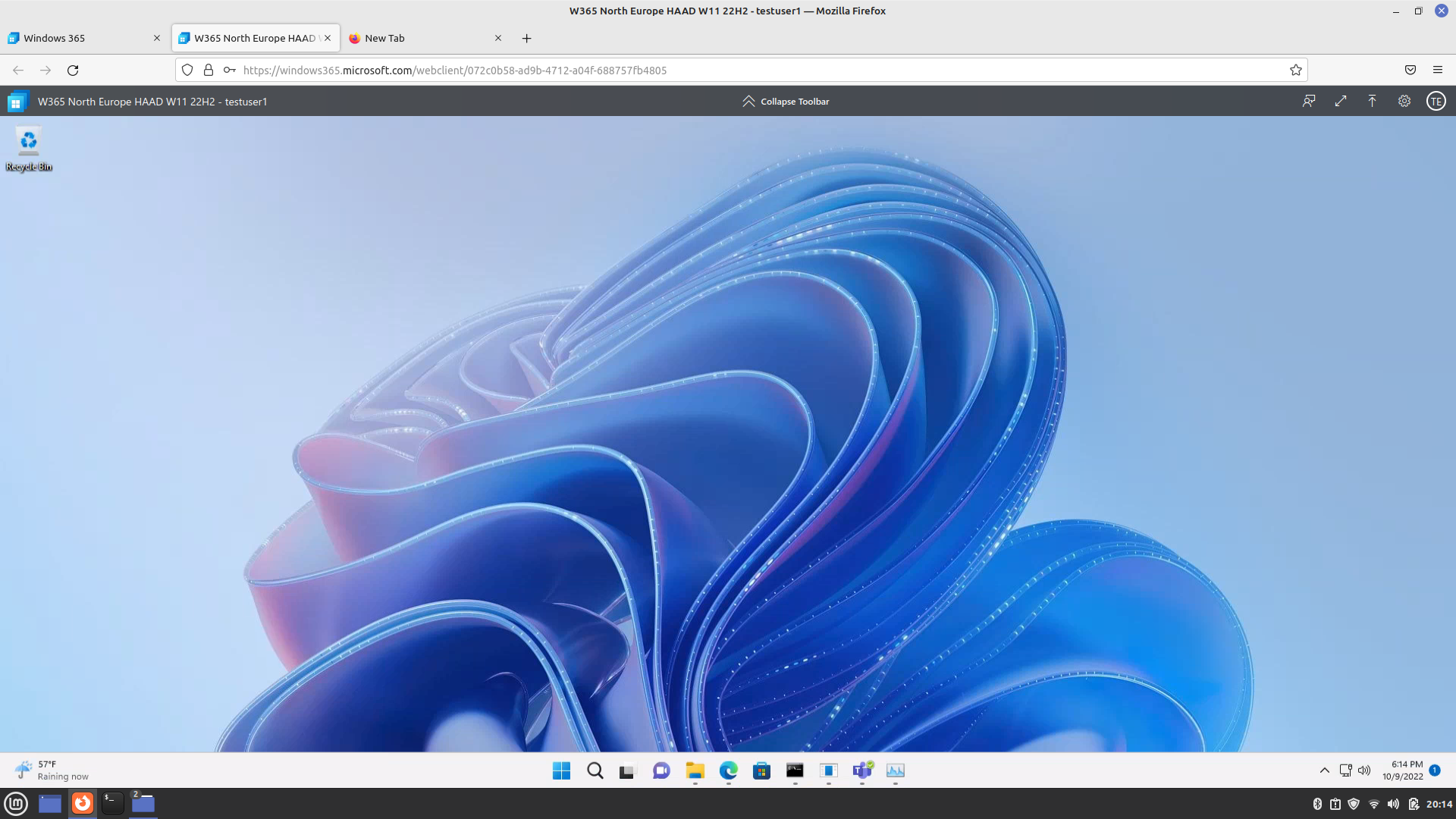

After clicking on Open in browser, I could launch the Cloud PC proper. This particular Cloud PC was a 2vCPU, 8GB RAM, 128GB Storage running Windows 11 22H2 using the Hybrid Azure Ad Join method as described here.
As you can see the Windows 365 toolbar is at the top of the web browser session, and you can click on the Collapse Toolbar section to make it hide away.

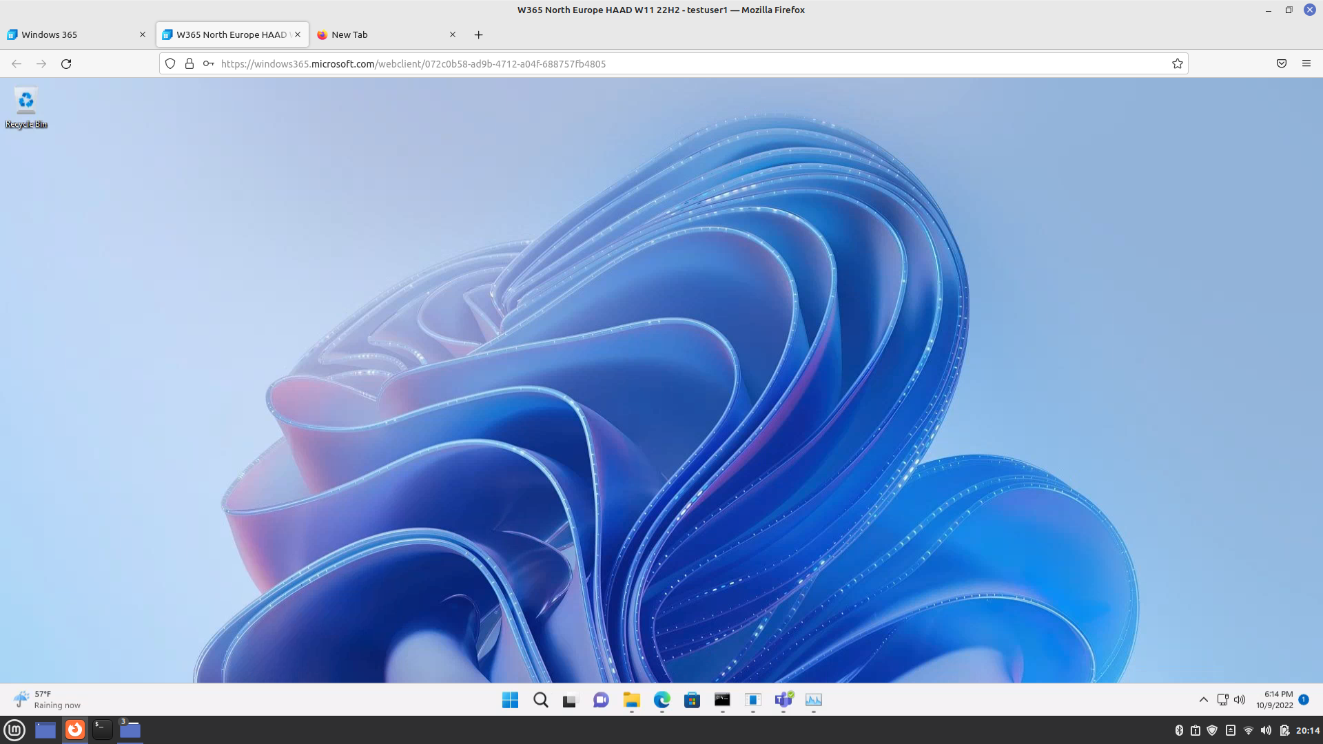

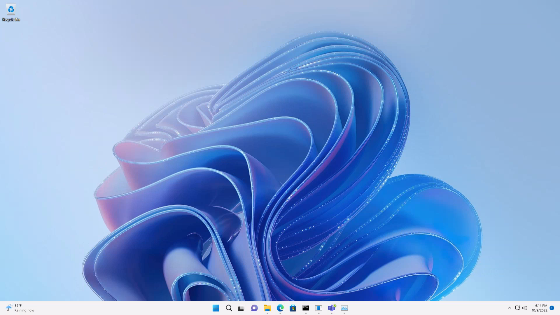

This is better, but to get the best experience out of your Cloud PC via a web browser from Linux, press F11 to maximize the browser window, this will show only the Cloud PC.
So now that it looks and feels like Windows 11 (on LinuxMint Linux) it's time to actually use the Cloud PC.

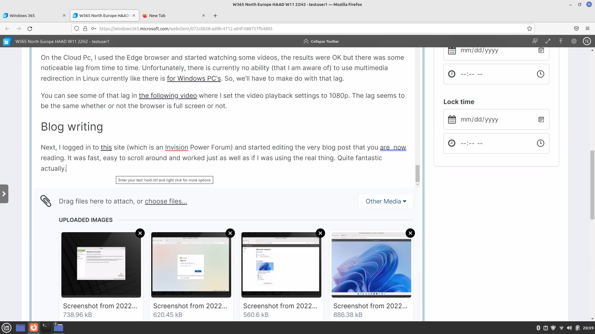

Next, I logged in to this site (which is an Invision Power Forum) and started editing the very blog post that you are  now reading. It was fast, easy to scroll around and worked just as well as if I was using the real thing. Quite fantastic actually.

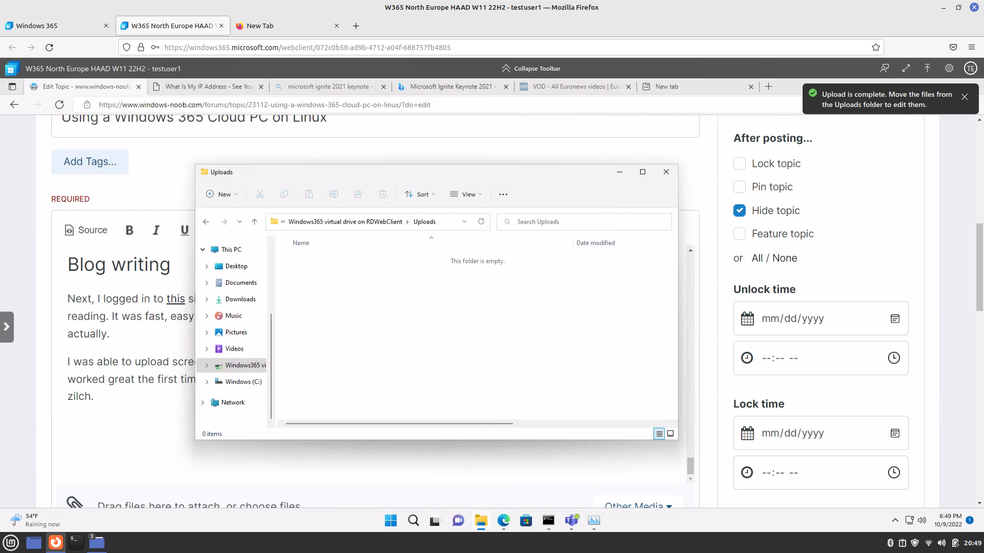

I was able to upload screenshots that I had taken in LinuxMint using the upload ability in the W365 toolbar. That worked great the first time I did it and I uploaded several screenshots successfully, but the 2nd, 3rd and 4th attempt it uploaded nada, zilch. I think this is possibly a bug in the toolbar and I'm not sure if it's related to Linux or the version of the Windows 365 client on Windows 11 version 22H2, I've asked the Microsoft Product Group for comment.
Below you can see my later attempts at uploading screenshots, it said it was done and that I should move them but they did not appear in the uploads folder.

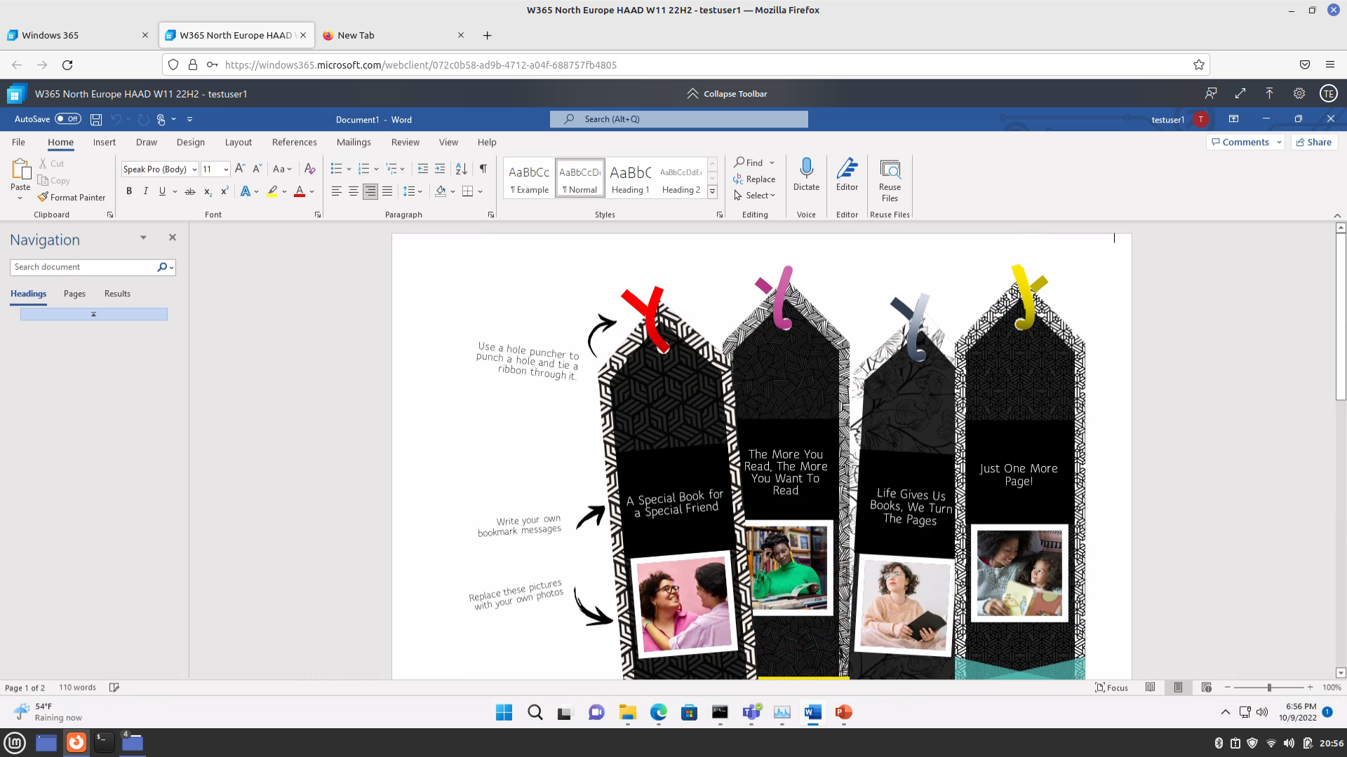

Using Office 365 apps

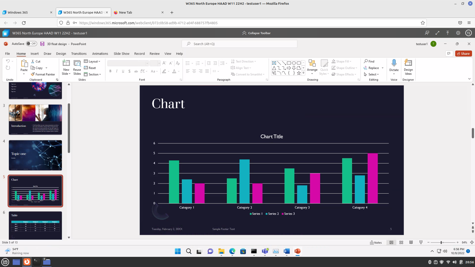

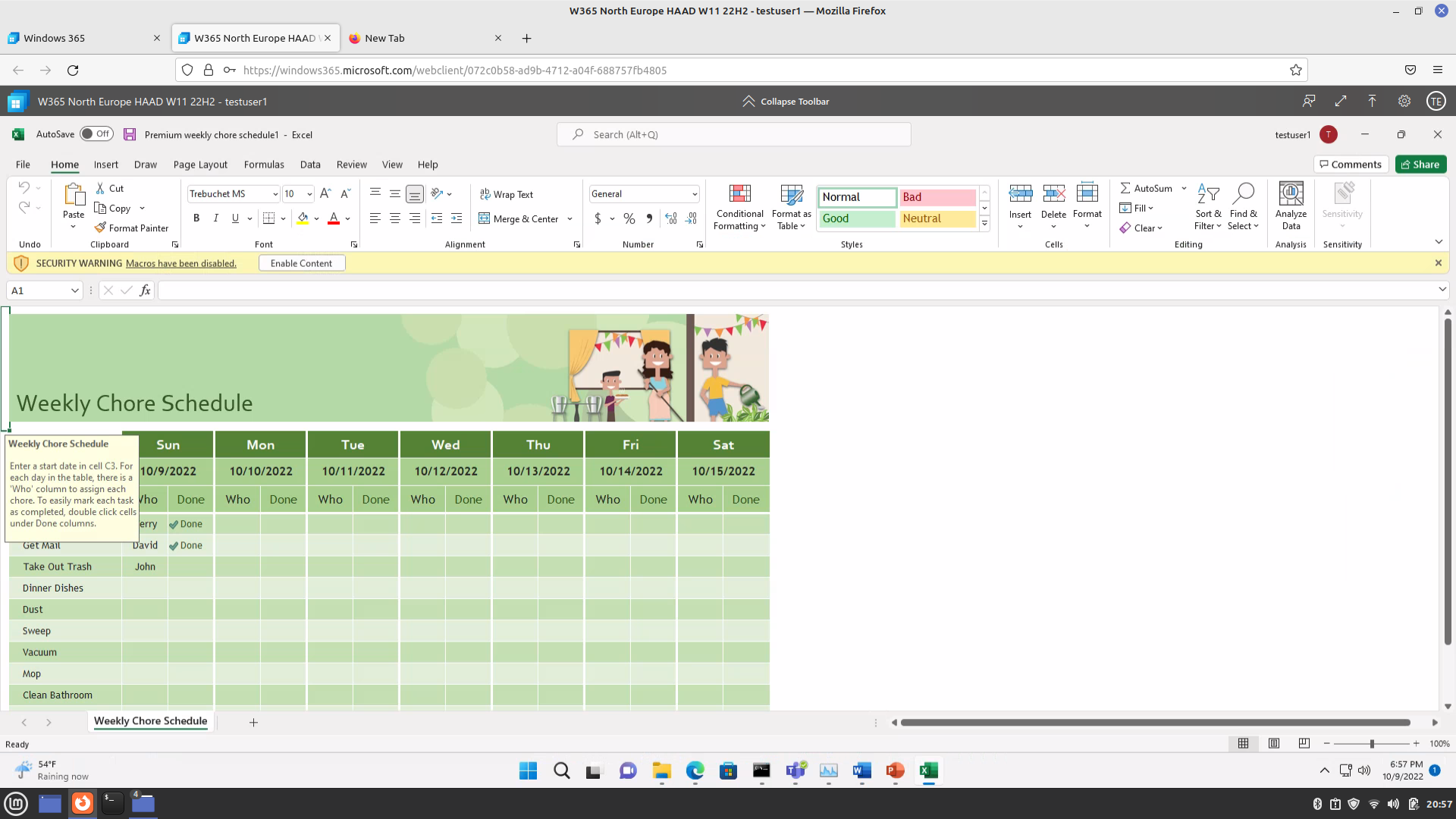

I started up PowerPoint, Excel and Word and had no issues with creating content on the Cloud PC, it honestly felt very easy indeed and I would forget that I was using Linux at all when creating content using Office 365.
Scrolling through Powerpoint was easy and fast and rendered perfectly in the web browser.
Word was a breeze
And Excel was also equally easy to work with.
I launched Outlook and that too worked seamlessly, no issues to report. From an Office perspective, I definitely think this worked just fine in test conditions. That said, my Cloud PC is not laden down with a plethora of security and other agents designed to read every file a million times while consuming every last iota of CPU and storage bandwidth.

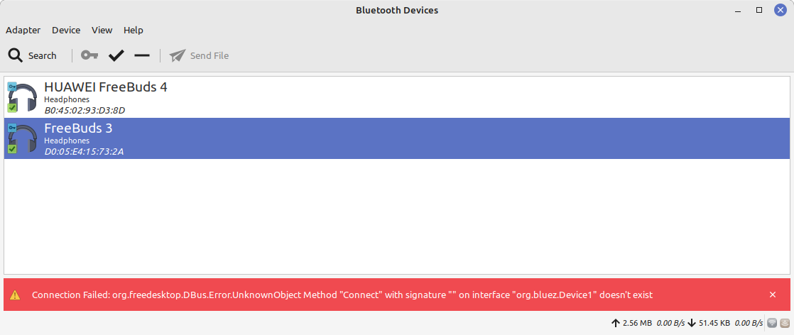

I'm not a touch pad fan so I connected my trustee Think Pad mouse with an USB dongle. It worked perfectly. Next, I tried to connect my Bluetooth headphones (Freebuds 4). But when I tried to connect to them in LinuxMint it failed. Same thing for my Freebuds 3. It seems that this version of LinuxMint has bluetooth issues as reported here: https://forums.linuxmint.com/viewtopic.php?t=378859

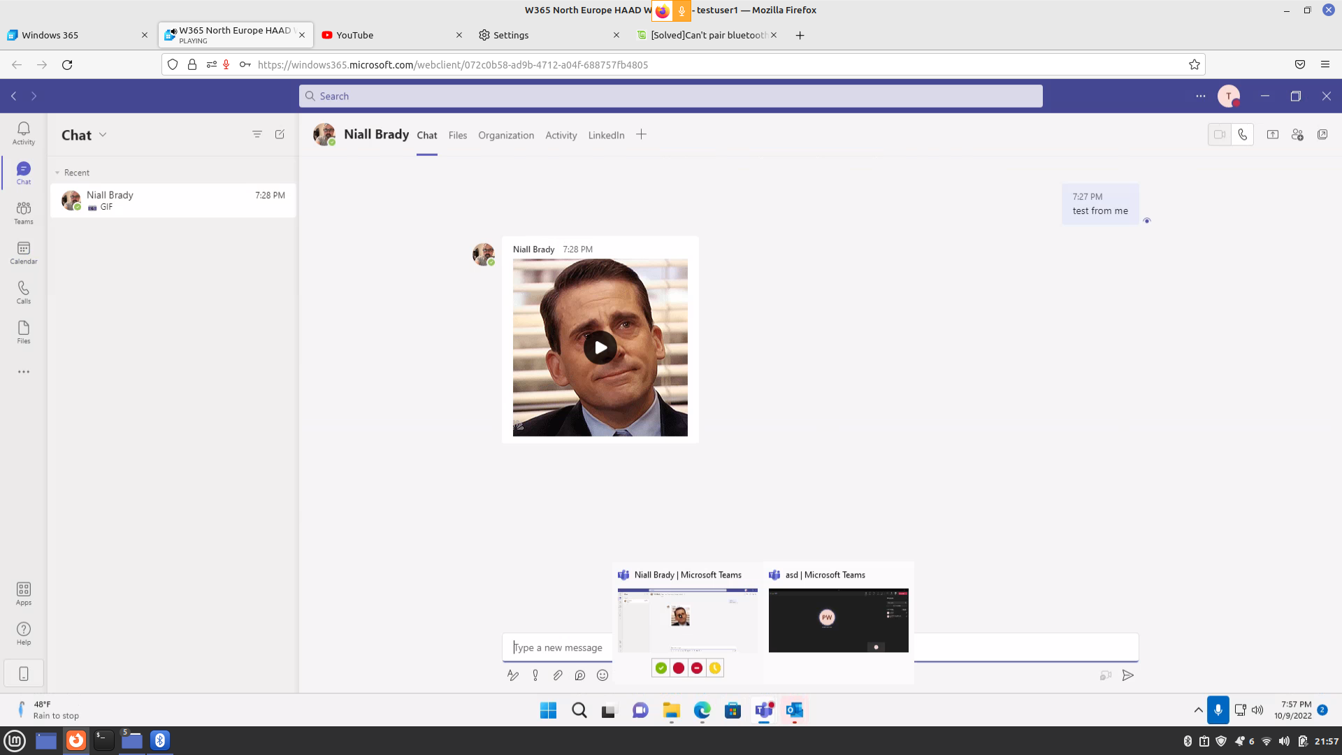

Teams performed just fine, without any noticeable lag. I held an audio meeting with Paul and it was totally fine, no lag, very little audio issues until the end of the call, in fact it worked better that I'd normally expect a teams meeting to perform.

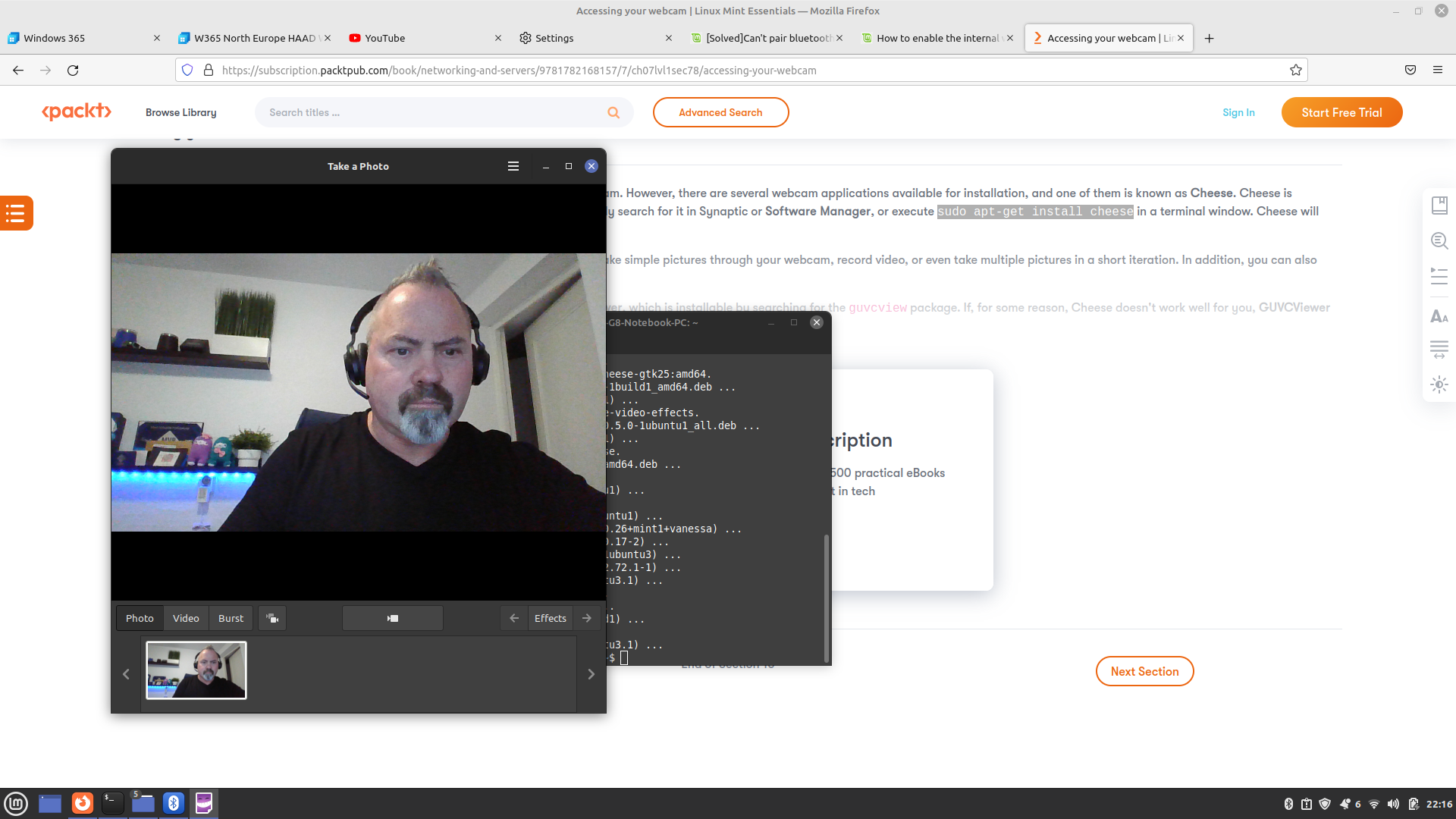

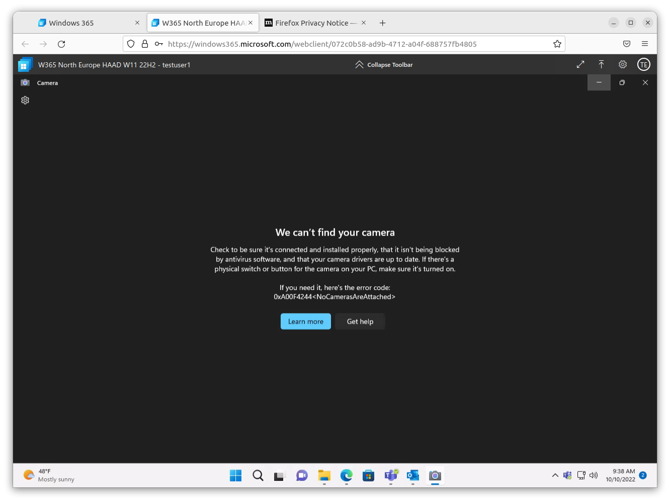

I wasn't however able to to a video meeting as my web camera on the HP was not detected or shared with Teams.
sudo apt-get install cheese -y
got the camera working in LinuxMint. However I cannot see any way to share that camera with Windows 365 via a web browser session. If you'd like to vote for a Linux client for Windows 365 then click here.

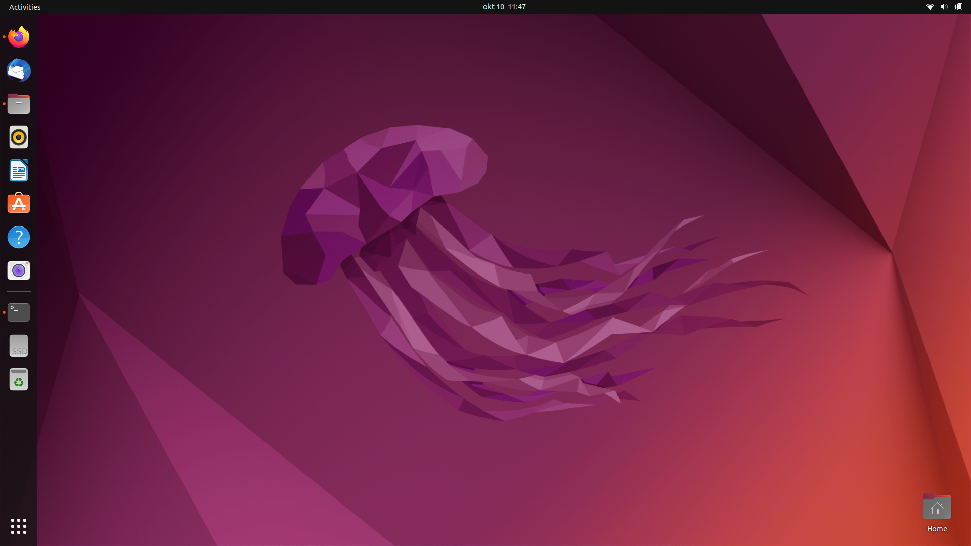

During the installation, I split the disk into two, allowing me to keep LinuxMint as well as have Ubuntu, that's a really nice ability with Linux. The installation was very easy and within minutes Ubuntu was installed.

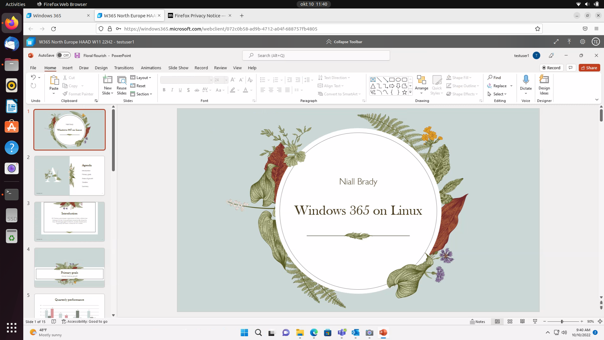

I fired up the usual Office 365 apps and all worked as before, no issues there.

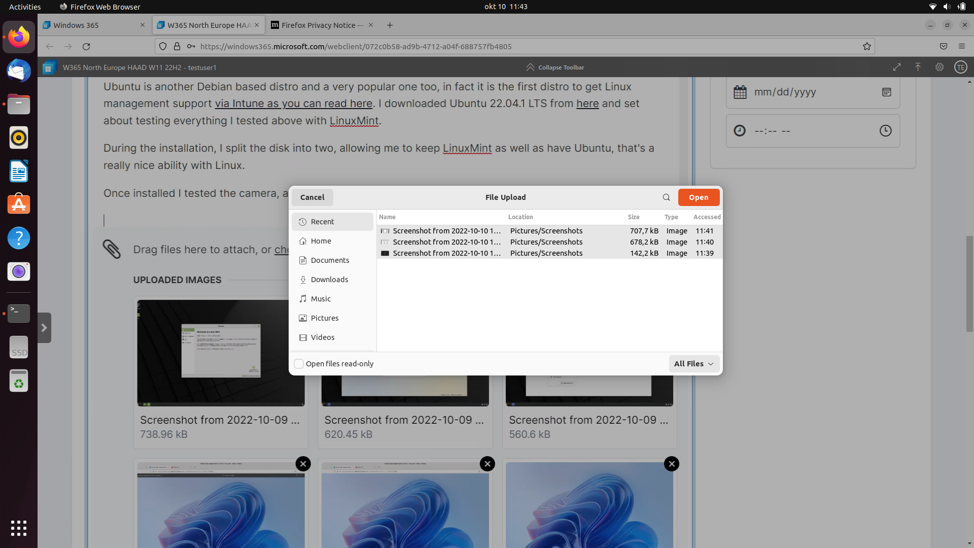

I even uploaded files (and edited this blogpost) from Ubuntu directly to my Cloud PC using the upload feature, and this time it worked (more than once).

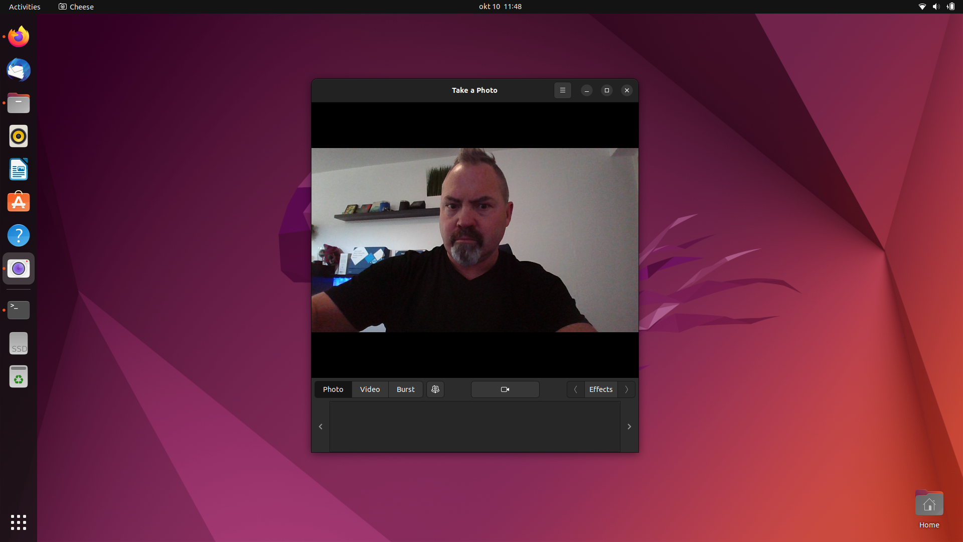

I wanted to test the camera and found out that Cheese was already installed. The camera worked fine in the Ubuntu desktop as you can see below without me having to install or configure anything, that was good !
but when I launched Microsoft Teams on my Windows 365 Cloud PC once again the camera was not detected, so that's a no-go for video meetings with Teams on Windows 365 if you are using Linux with your Cloud PC.

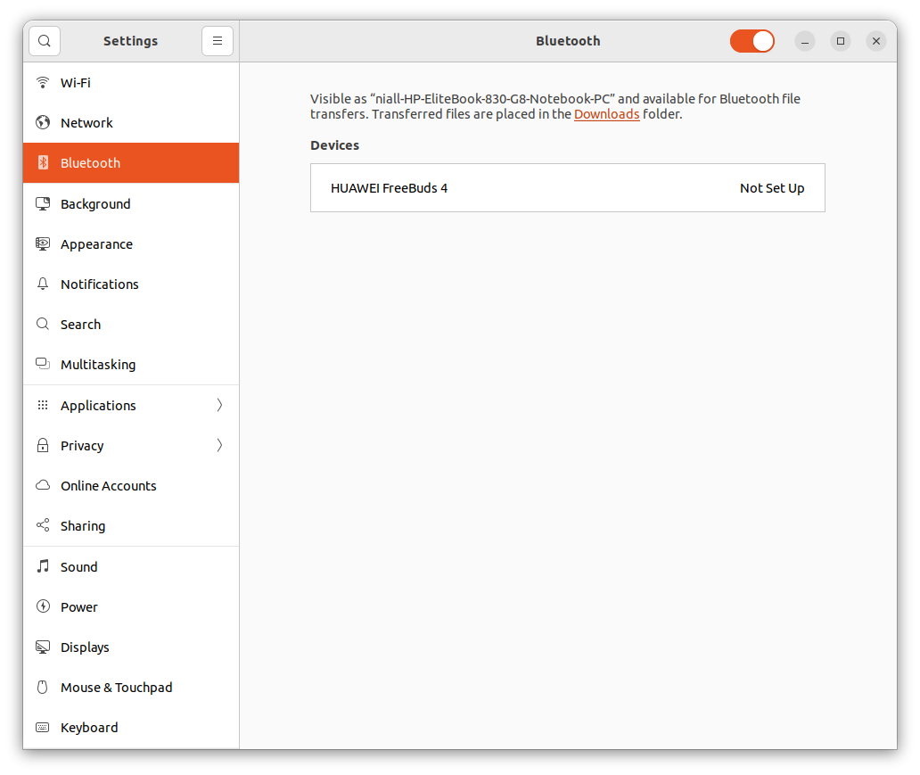

Once again, as with LinuxMint I had issues with Bluetooth, I couldn't get either of my Bluetooth headphones to work,

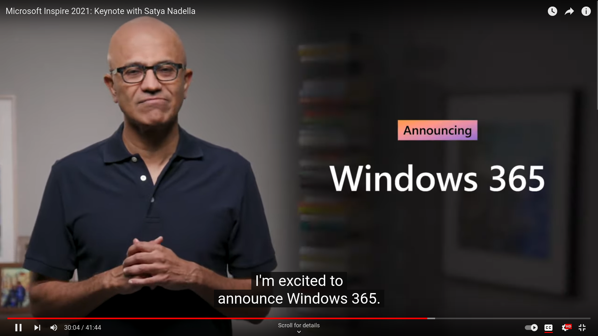

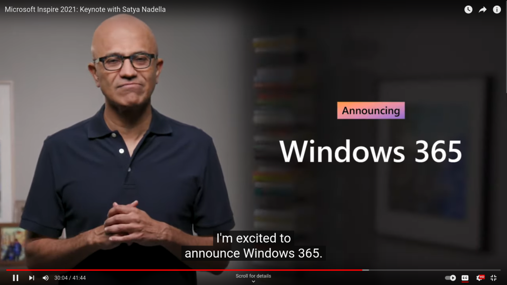

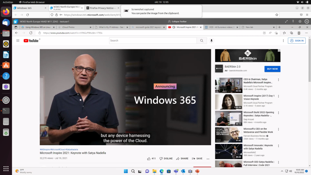

Video playback while using Ubuntu was certainly OK, I started watching the Inspire 2021 session where Satya announced Windows 365 Cloud PC and played it in a window as well as full screen, the performance was totally acceptable, however I did notice what can only be described as audio ticks when playing back video content, this was also noticeable in LinuxMint.
Perhaps there are better audio/video drivers available for my test hardware, but I didn't find them however I did see that according to Ubuntu, this hardware was certified for Ubuntu Linux as of May 2021. The only difference between my test system and the certification was the version of my BIOS.
and full screen

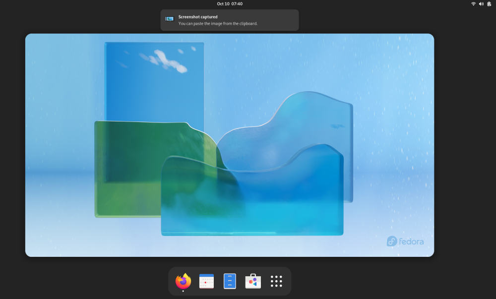

Fedora
I downloaded Fedora 36 from here and proceeded to install it on my HP EliteBook 830 G8. The installation was relatively quick, and I did have to adjust the disk partitions to get it to fit alongside Ubuntu and LinuxMint.

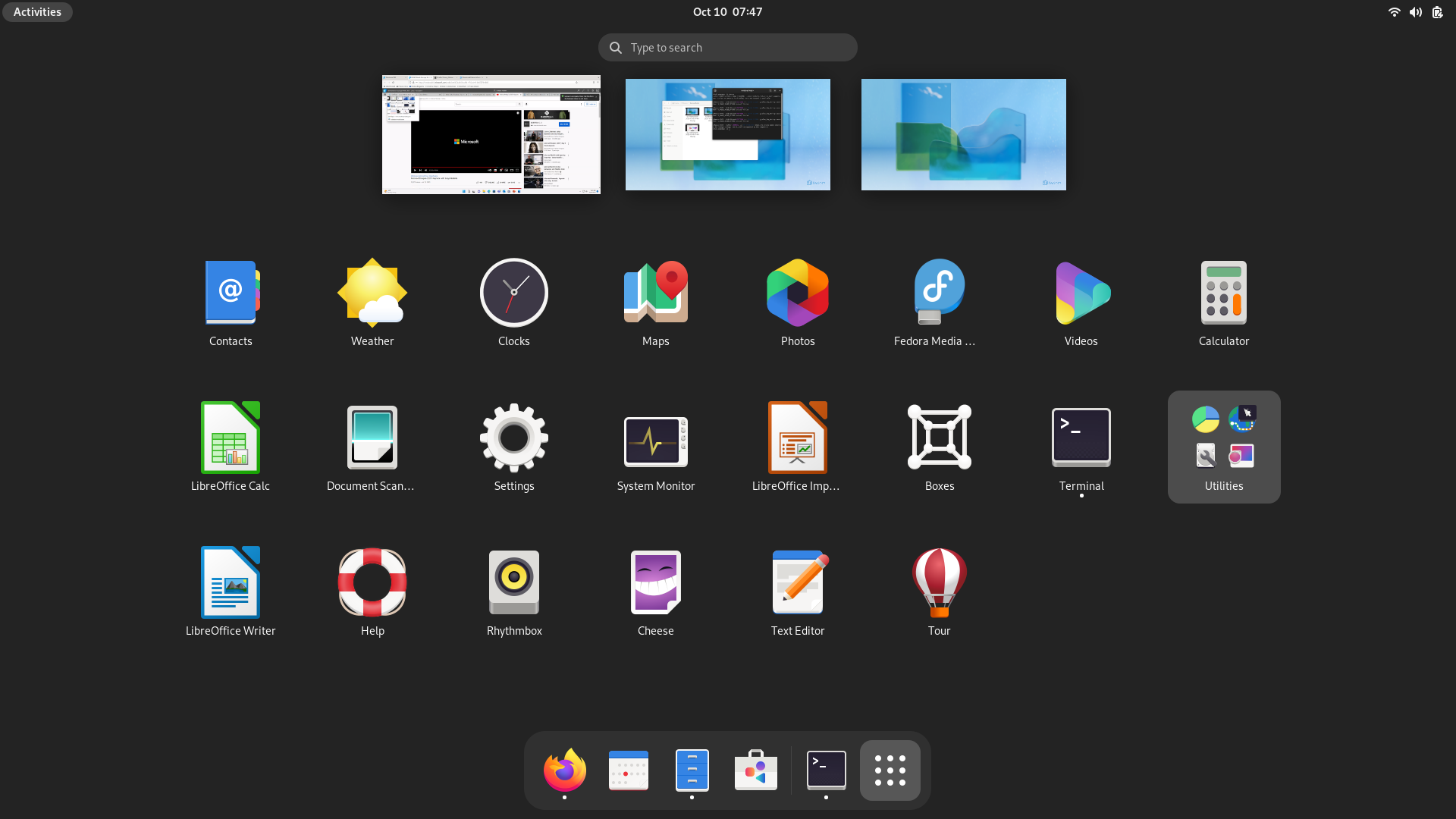

As with Ubuntu, Cheese was installed meaning that my camera worked in Fedora Linux, but not in Teams via the web browser on my Windows 365 Cloud PC.
Screenshot from 2022-10-10 07-47-27.pnged

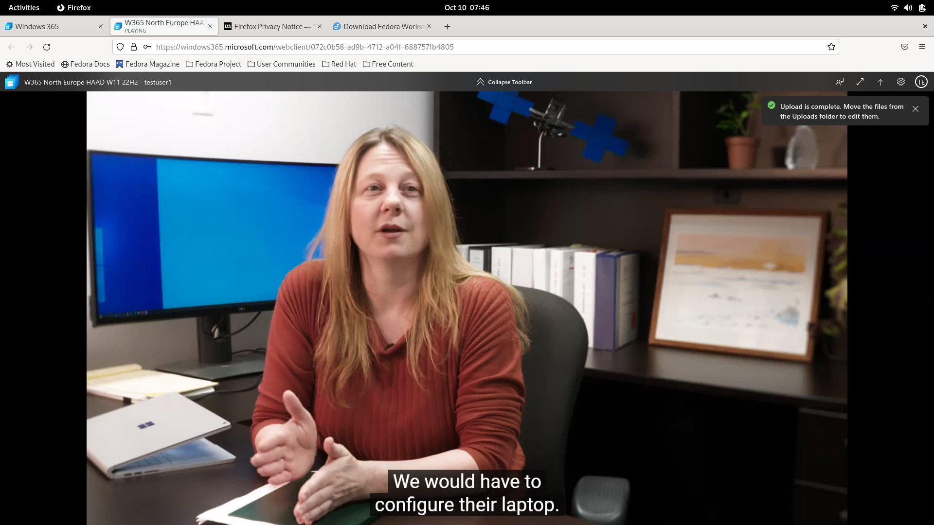

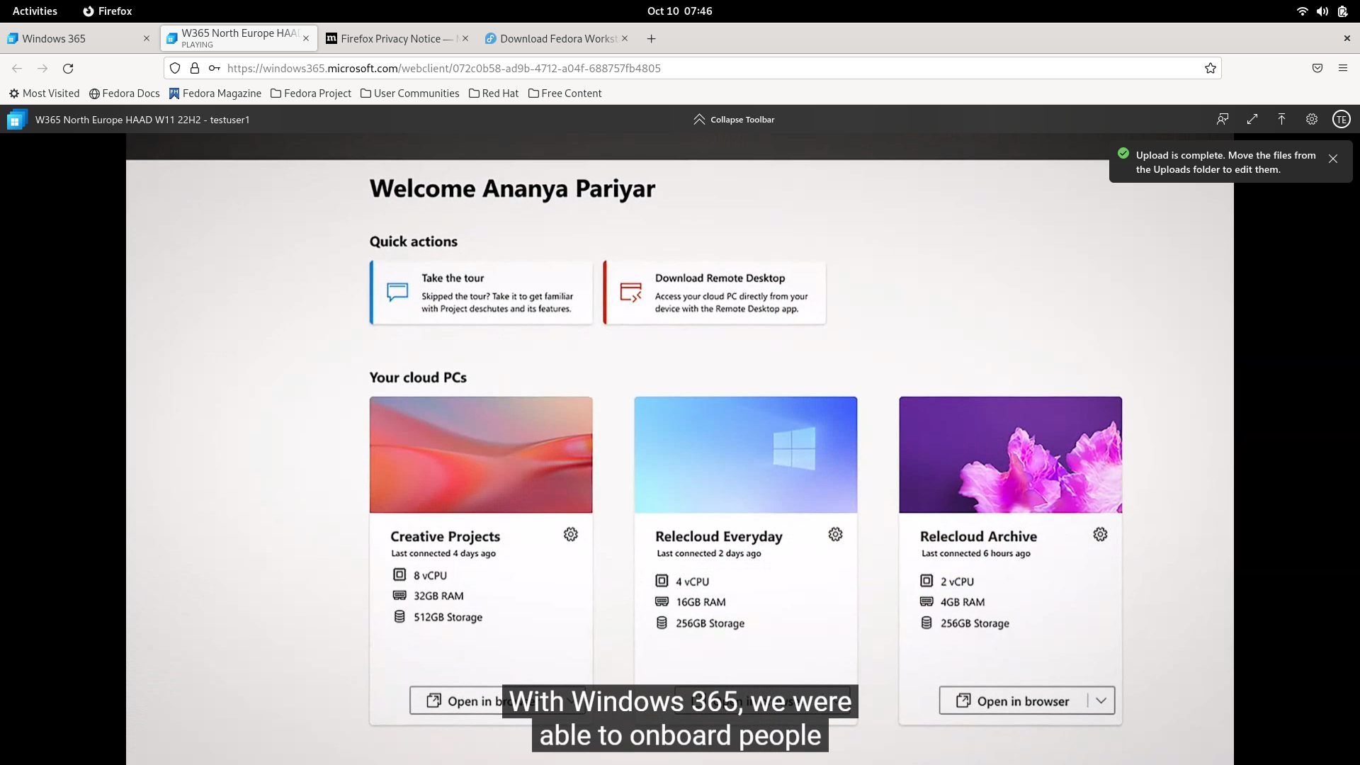

Video playback via youtube on the Cloud PC worked just fine with the odd audio tick as noticed with the other Linux distros, but overall, it was perfectly acceptable.
Setting the web browser settings for Windows 365 to use high dpi does improve the readability somewhat.

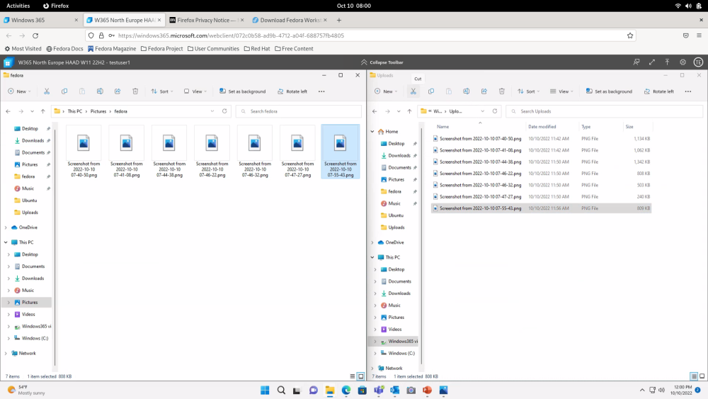

Uploading files and continuing to edit this blog post also worked with no problem so I was able to be productive on the go using my Cloud PC.
